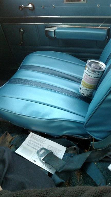

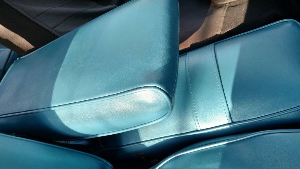

Seat covers arrived!
Taking a break. Wife and daughter with me out running errands. New passenger seat is in use.

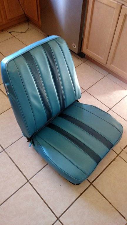

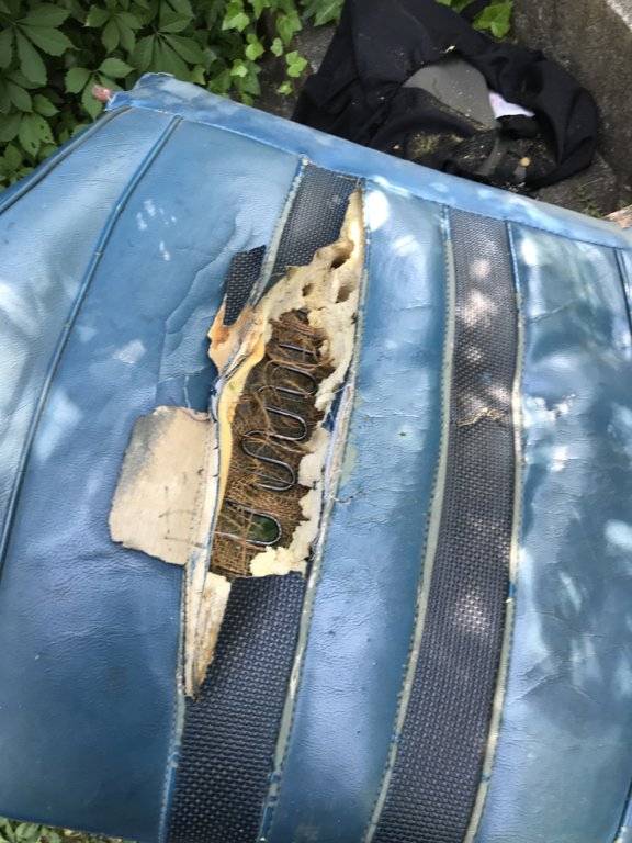

I am off work today. Decided it would be a good day to stop procrastinating on the driver’s seat. Back is done. Starting on the bottom now.

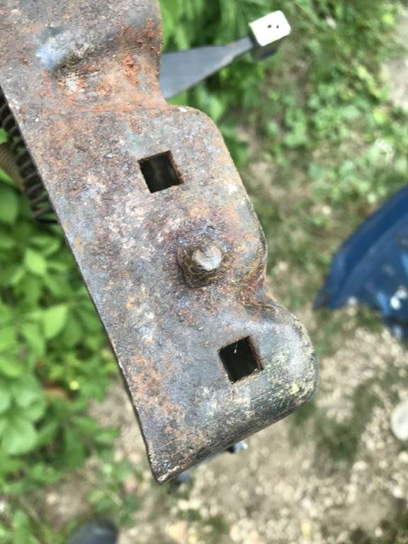

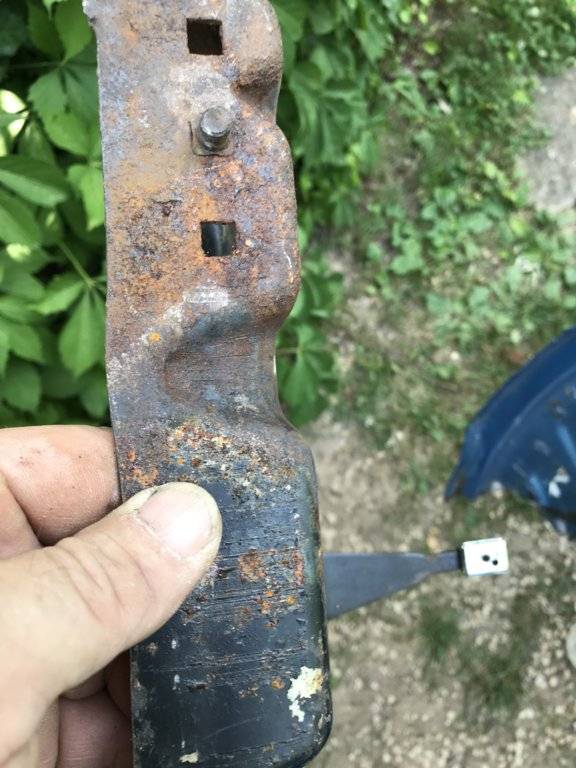

The carriage bolts for the left seat support were broken off. Replacing them today. Hoping I can tap them out with some PB Blaster and a hammer.

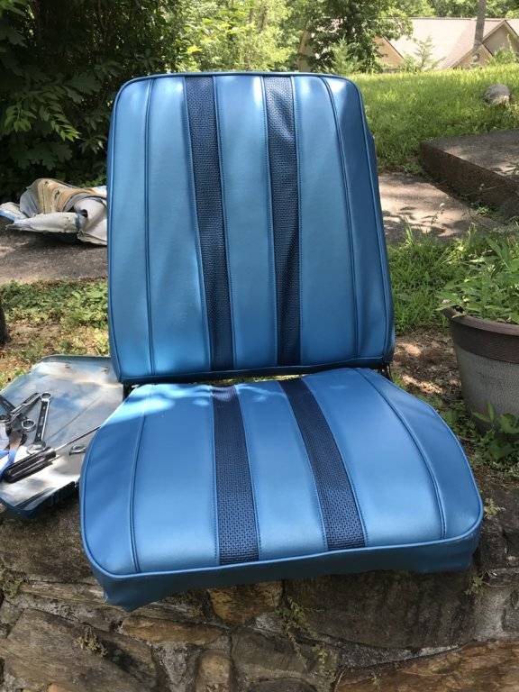

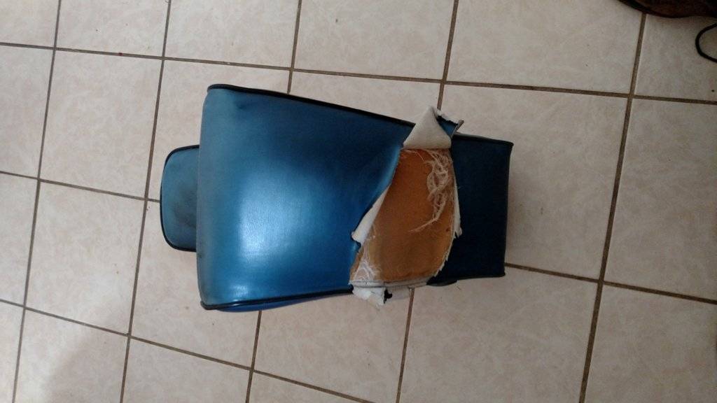

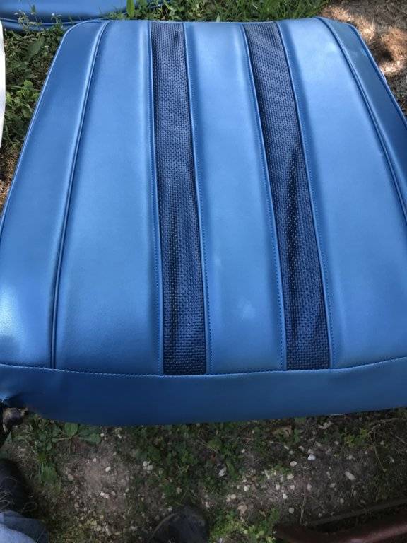

Seat finished. Took a lot less time than the first one I did. New seat foam is very expensive. I went to a local place (Foam And Fabric) which sells auto seat foam. I bought a piece to fill the hole. I bought a thinner piece to cover the entire seat cushion so the filler doesn’t stand out.
