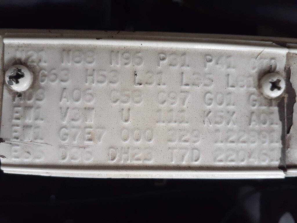

Very interesting discussion here. My Eggshell White 77 Royal Monaco coupe has 111 on the radiator support tag and it is a N96 High Altitude emission's car.

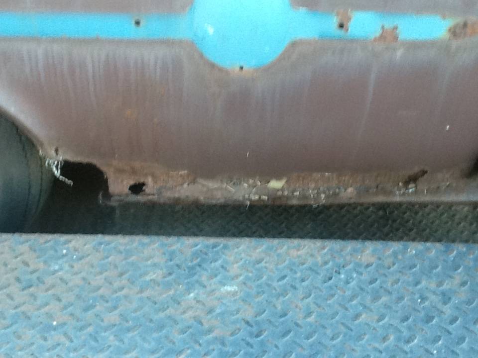

I can see a heat shield on the passenger side and that does look original, but no heat shield on the driver side.

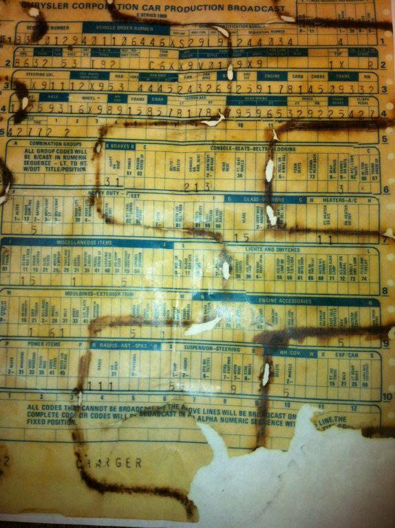

fender tags listed the big groups that a car may need special holes,brackets, rear ends,engines etc for.. small stuff is on the sheet only
Hence why these are fastened to body, even prior to paint. The build sheets were printed-out in various areas of plant then matched to fender tag later. For instance seat trim shop will print out the build sheet when assembling seats. Why they are found under seat springs. Trim shop will print one out also to confirm interior trim colors and often found under carpet. Dash assemblies were often assembled off-line and build sheet will often be found stuffed over glove box.
I appreciate you mentioning this. I found a partial build sheet stuffed in the springs of the drivers seat. Never knew to look under the dash or carpet.
That's encouraging. With "111" there should only be heat shields (three of them) on the passenger side.

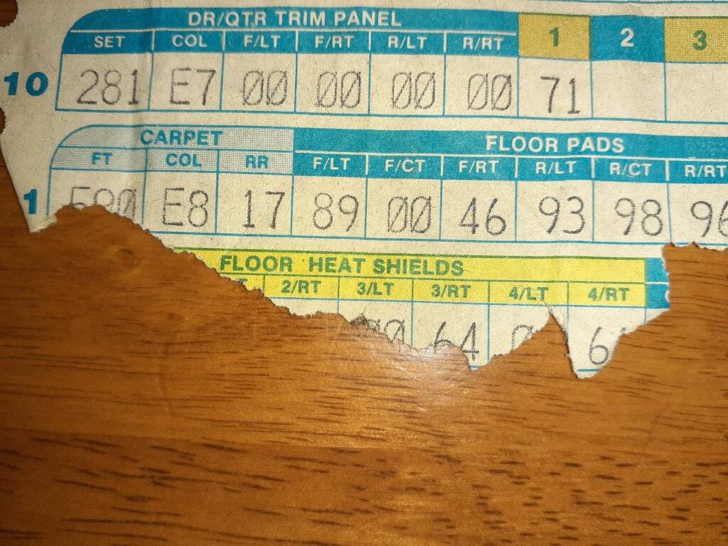

Is line 12 "Floor Heat Shields" readable? What does it say in the boxes labelled 2/RT, 3/RT and 4/RT?

I just checked and the car does have 3 heat shields on the passenger side. The only build sheet I have found so far was under the driver seat and more than half of it is missing. In the attached picture you can barely make out some of line 12. In the 3/RT and 4/RT boxes you see what looks like number 64.

You've just given an important confirmation of the assumption developed earlier on about the meaning of that three-digit code on 1977 Belvidere-assembled C body fender tags: 111 = three floor heat shields on the passenger side.

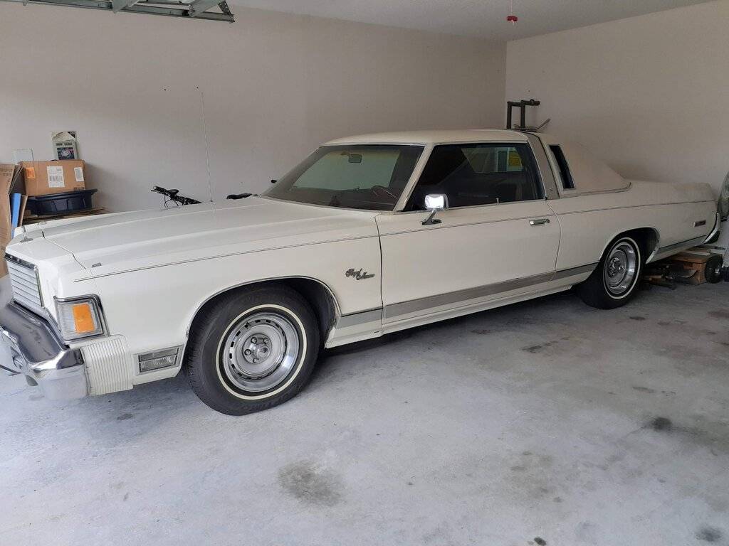

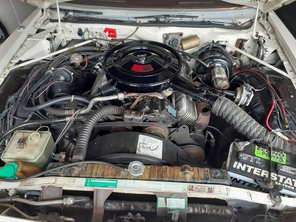

Wow! That is a lot of options on your car!
Can we see pictures of the car???
Thanks for asking. This car actually has 2 tags. It's pretty special to me. I looked for a 440 coupe for many years before finding this one. Very hard to find.
