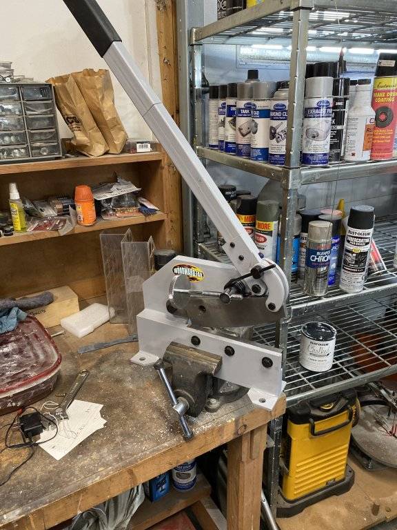

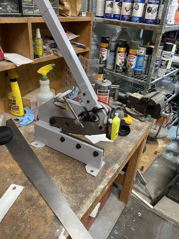

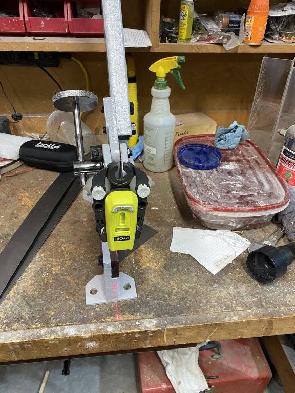

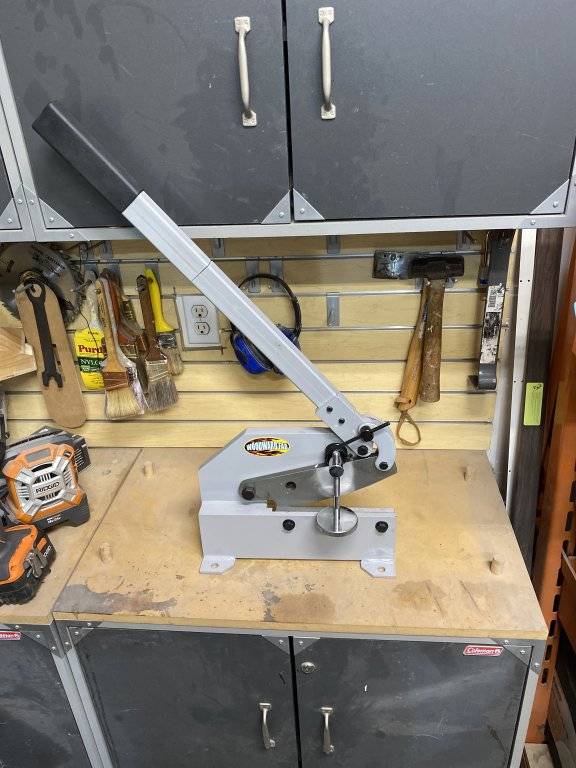

My 8” Woodward sheer came in.
Couldn’t wait to use it. I think am going to like it. I’m sure it will work much better when I make a base for it.
Also need/want to make a guide or indicator to line up the front jaw to the scribe for straighter cuts that don’t angle away from the scribe line. I used a small magnetic laser for now, but there isn’t a good mounting point. I have a couple of other ideas.

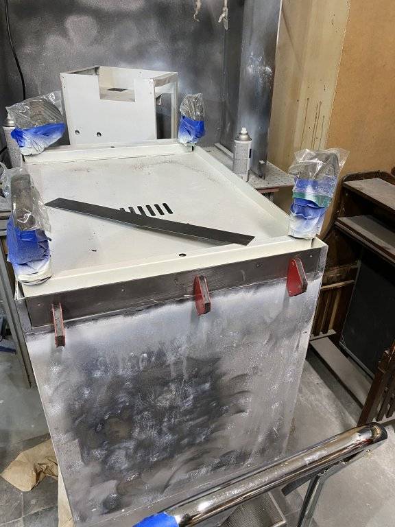

Am using for now to repair my engine analyzer cabinet.
New project: Allen Engine analyzers, restoration?

Because I don't use it very much, I put mine in my bench vise rather than mounting it.
That works well for me. YMMV.

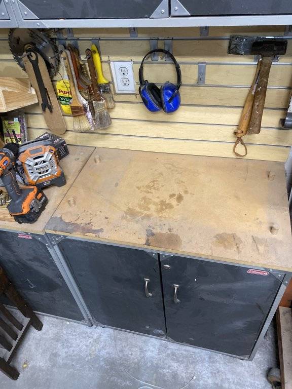

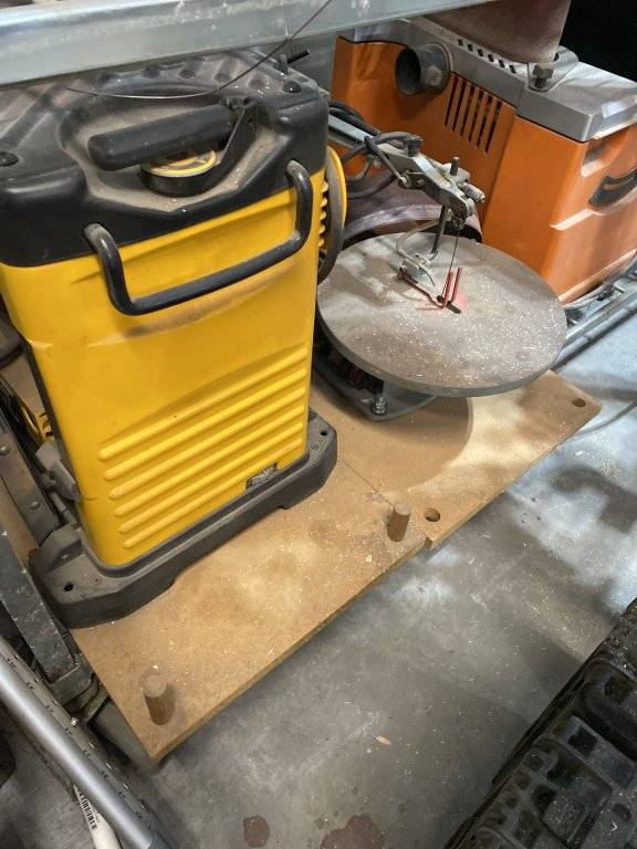

I have a couple of rolling cabinets, that I built a receiver plate with 1” dowels. Then when I get a new tool I will build a base plate to mount it on with holes to match the receiver. That’s one plan, but the base does take space. I will have to look at the vice option as well.
Although the vise is a much easier option.
