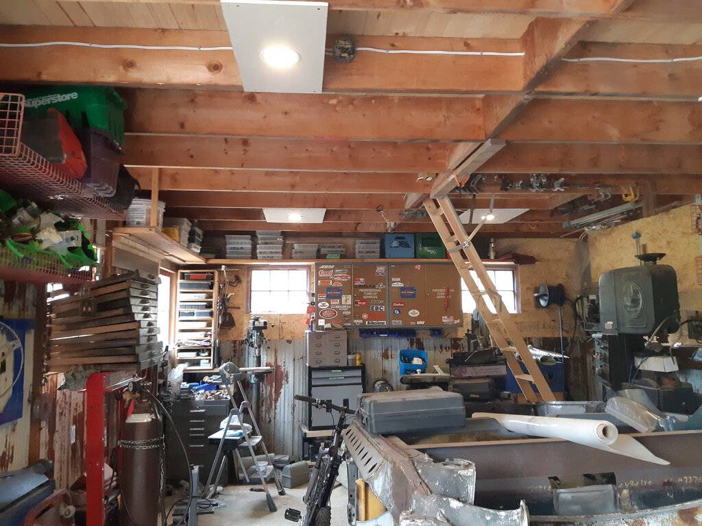

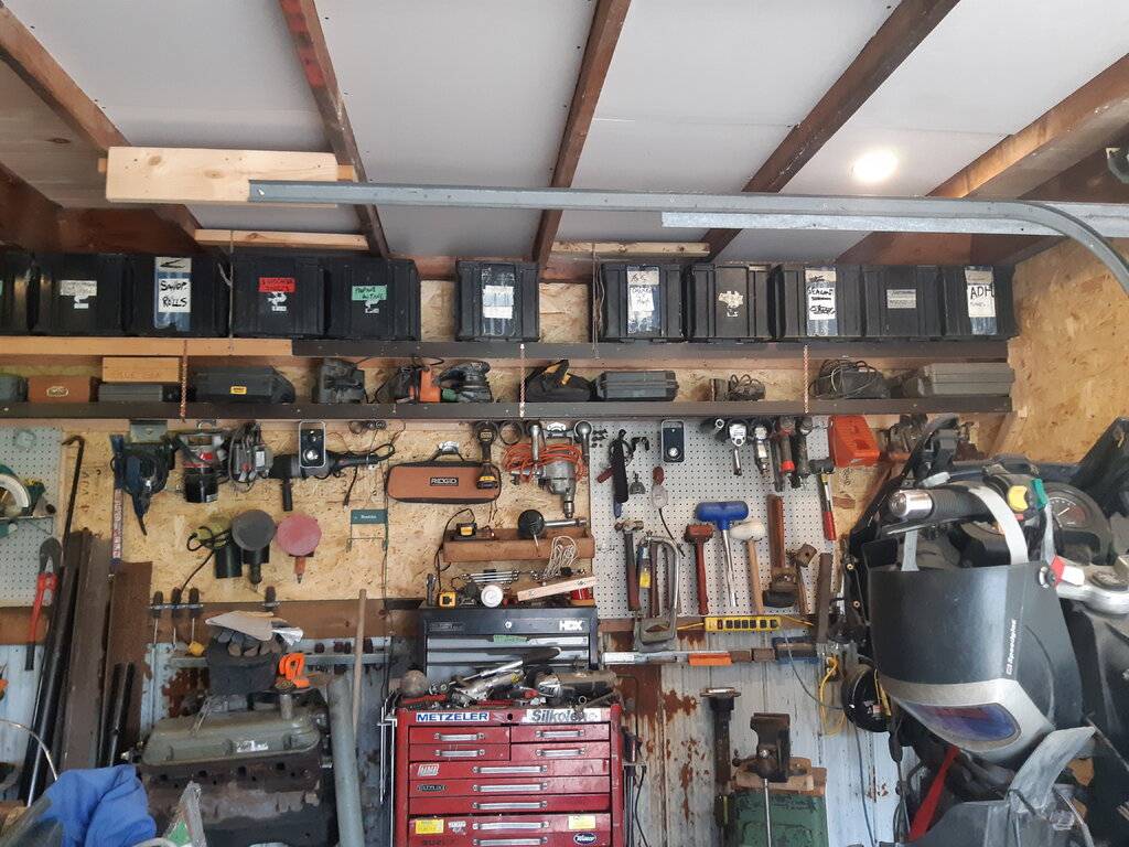

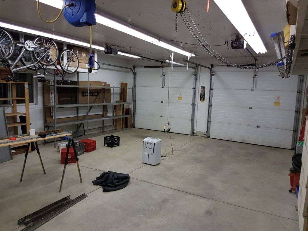

I always put one shelf 15in from ceiling for crates.

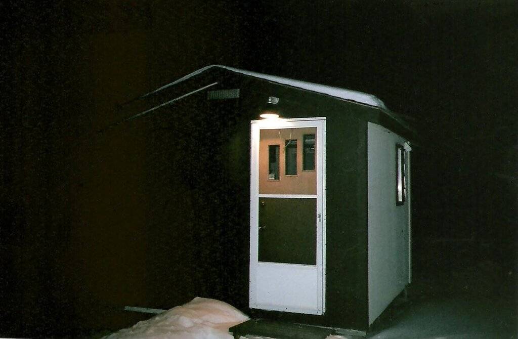

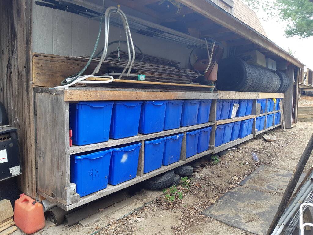

When I redid back roof I extended the overhang to cover stuff and added boxes for recycling bins that became dirt cheap when we switch local pickup

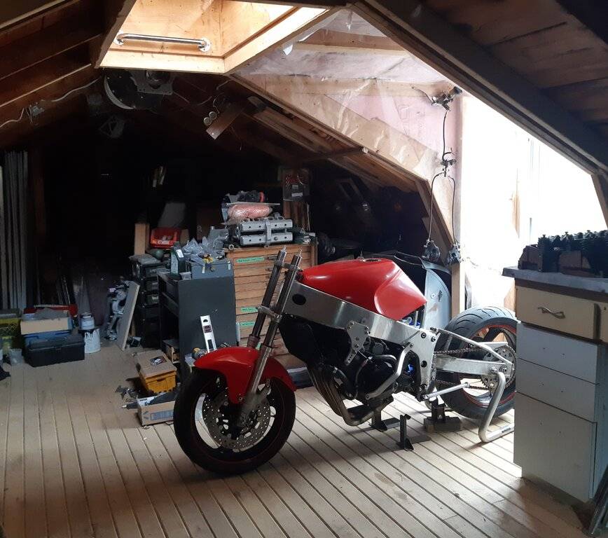

You sure don't screw around, do you?Added dormer to give a bit of room as well
Plan to do twice as wide for front this year

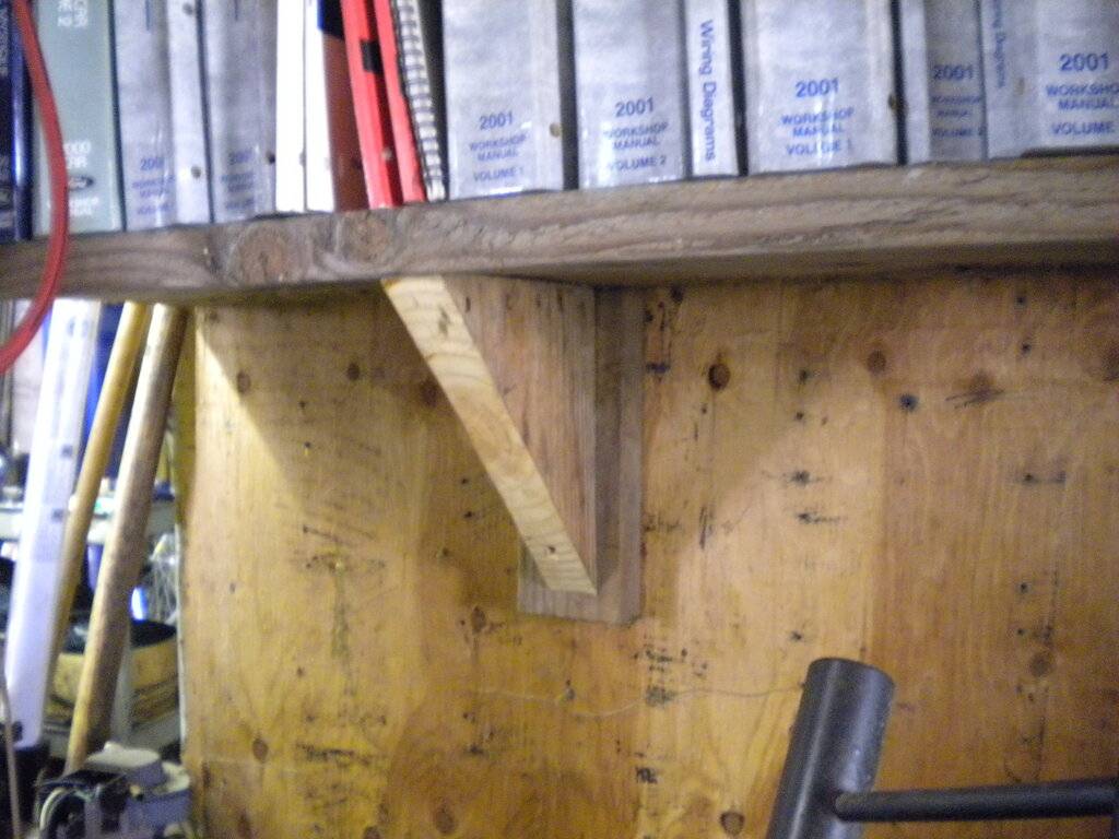

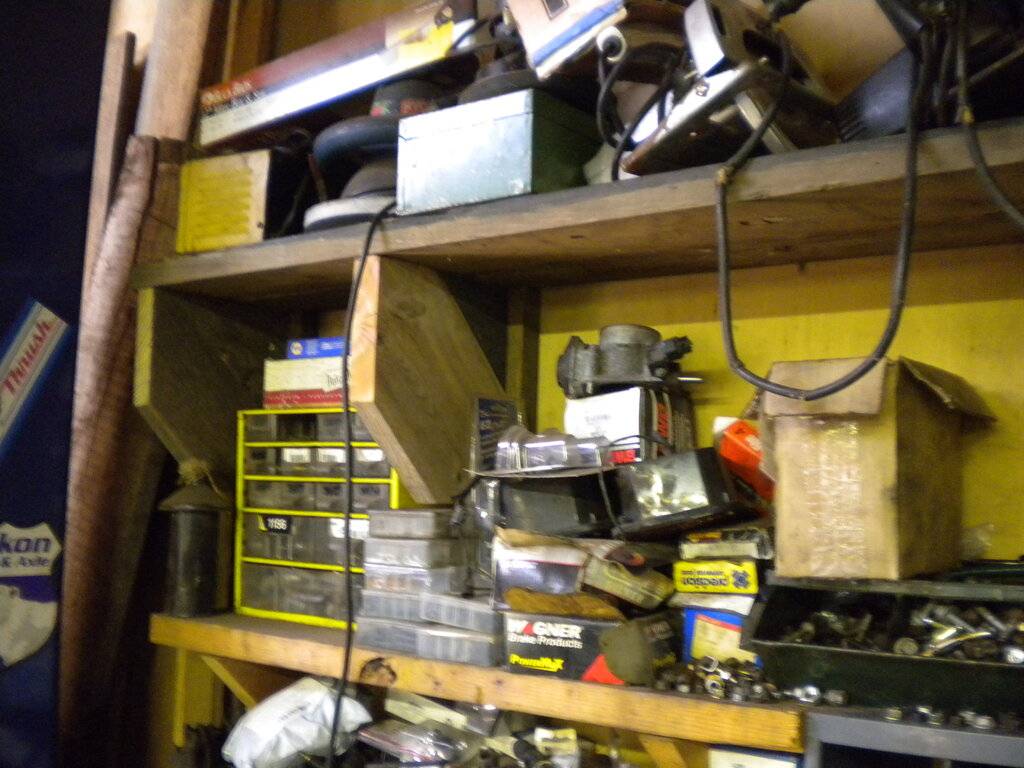

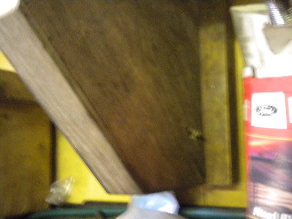

my shelf design. 2x4 jack, deck screwed to wall stud. gusset screwed to jack. 2x12 shelf screwed down to both. hold the weight of the world.View attachment 373184 View attachment 373185 View attachment 373186 all built with scrap. like everything else i have. now get that lift put in!!

My ceiling is 14' so tough to put things up high...;)
