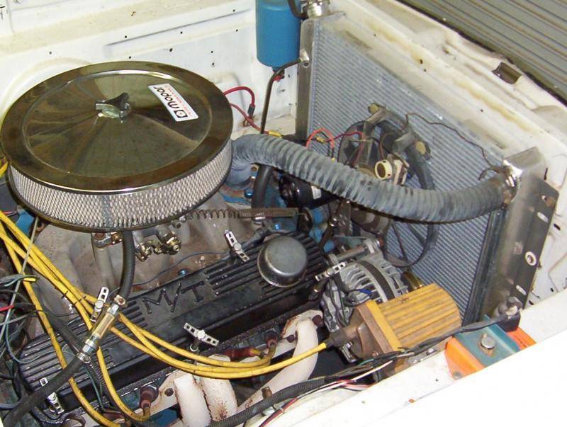

Its been discussed on here before, but to recap. Its the original 318/904. Mild MP cam similar to the 340 4 speed cam. Eddy dual plane intake, eddy 600 carb, headers, 360 junk yard heads. Stock pistons & crank. Est about 8.1 compression. And about 235 at the tire base on some calculators I've used. 904 has a manual VB & recently installd PTC 3K converter from John Cope racing trans. 4.10 gear with spool 29X10 slicks. I bought the car from a junk yard in August of 1986. I believe I have had a wrench or socket on every nut & bolt on it. I shift it at a lazy 4600 mainly due to the 40 year old stock cast pistons in it. It pulls well past that.

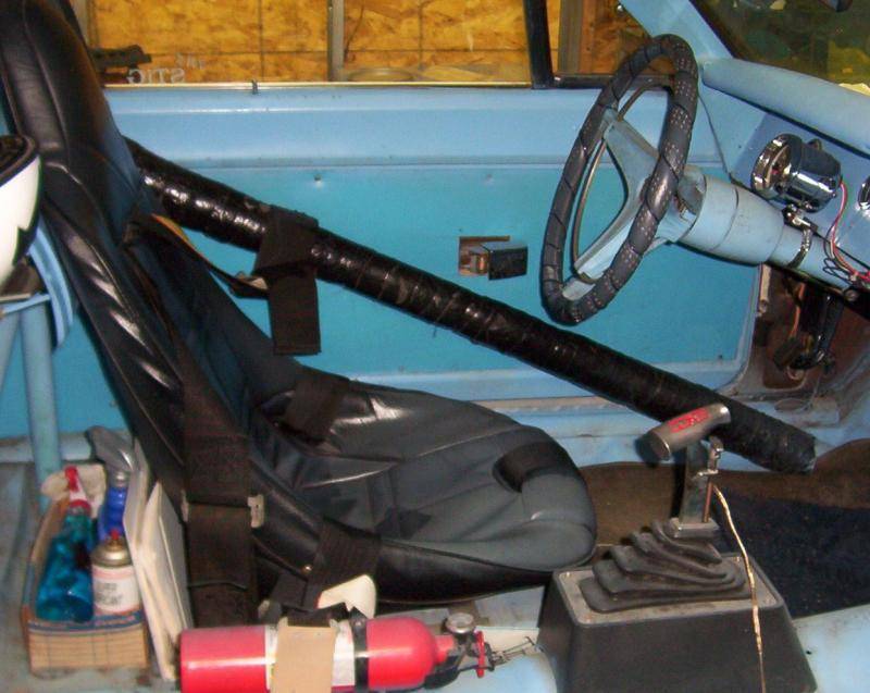

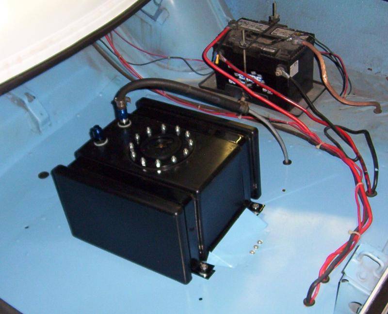

A few more pic's
Its a real race car. Comp eng cage, RCI cell. Its so damn cool to turn it loose. That little 318 revs so quickly & is throaty.
