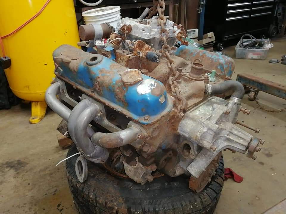

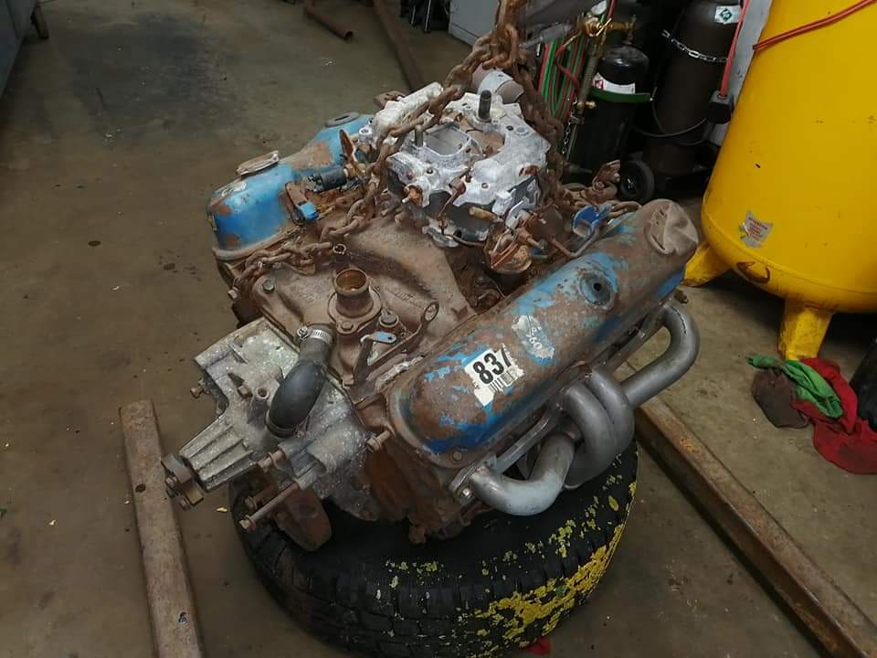

Where a lot of this began was the Fact I recently picked up a '79 E58 360 Pursuit...
I originally bought it with my M body in mind, then quickly decided not to tamper with an unmolested time capsule.
Then I remembered the fact the ragtop had a 360 in it when I bought it...I've come to appreciate the 360 over the years.
Some of the most potent race cars my buddies have are 360 powered.
So building a mild 360 isn't much of a stretch.
The idea of the Magnum 360 has been there too as I love the Performance of my 01 Ram. It has an awesome torque curve.
Then I started reading about 360 Magnum swaps and how much of a pain they were while 318 Magnum swaps were fairly straight forward...
Too many ideas.
