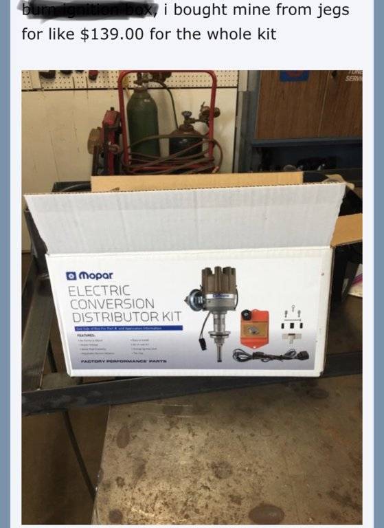

For future consideration:it’s never a bad idea to install electronic ignition , it will save you a lot time in tune ups . Here is a pic from another thread with the cost. View attachment 228022
Yes, because we all know swapping in a repop system is never a bad idea, and couldn't possibly cause a problem, especially for someone without familiarity.
Someone please explain to me exactly why an otherwise stock low-revving BB cruise car needs a new ignition system? Especially when so many new units are suspect? At least it made some sense when my PO removed the Leanburn.
He said he wanted to do a tune up, that involves spending some money. He may want to upgrade to elec. ignig, the dist and points could be part of the problem, but that's not the point. Baby steps here! I've had good luck with NAPA's wires in the past. Get it runnin good then report back. Good Luck
