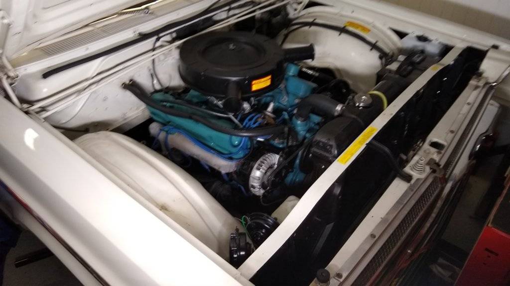

    I have 8mm Blue Taylor's on mine with an Accel (tan) cap. I'm disappointed in the overall length of my wires as they stated 383, but they are at least 4 inches too long on almost every wire. They work great, I don't have any issues with performance, but then again, I'm not racing or hammering on the motor much. I like to cruise.
    I had to change mine out in a pinch as I really wanted to drive the car for the final months of the season and just wanted to get a good, low cost set on there for the time being. The Taylor's have very good reviews, and are priced very well.
    For plugs.. Bosch Platinums. I've used them in every car I've owned since the 90's. They're reliable, and do the job without issue. Again.. but I don't beat the hell out of my cars.
    In the Spring, I'll switch up to the black 7mm wires, just to get it OEM as I've spent much of the Winter cleaning up and putting my engine bay back to stock look.
    As for wire "management"... take your time, and do it right. It really makes a difference in the overall look of your engine. Nothing worse than opening up a hood... everything is clean and organized... but your wires are all over the place.
    Don't mind the wire-tied power steering line... I'm in the middle of changing my front shocks and mud flaps.

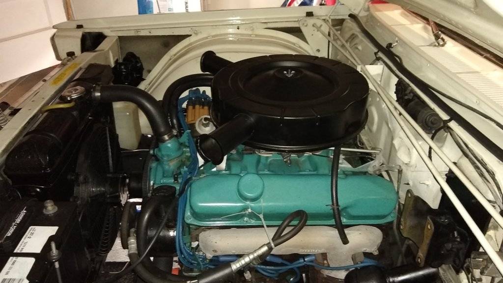

    I agree with CBody 67.
    Onmy car 6 wires have 90 degree boots and the rear plugs have 135 degree boots.
    When I converted the Boab to 2bbl to 4Bbl HP I had to change the valve covers and wire looms to accomodate the HP logs and to look "factory correct".
    Boab is far from original and her 383 is far from stock---but looks the part..
    • Like Like x 4
