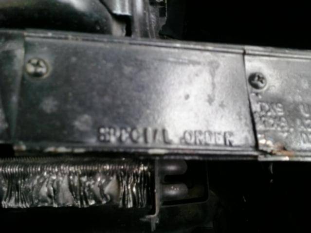

Hi, I don't know where should I post this question so let put it there :)
Near of my 74 fury Vin code is a plate with "special order" letters on it. I don't know what this could mean or what is the "special" feature. The vin code of the car doesn't show something interesting, Just a Black 74 fury, sedan with pillars
What could be?

The obvious answer is a police package car.......if not another type of agency . The fender tag will tell the story

Special, could simply be special order and all the refers to is someone sitting down with a sales person and checking boxes and not taking a car off the lot. Again a copy of the data tage would confirm.

Whereas that may be true the original poster said there is special order, what that entails can be anything within the order boxes or "special" like the CHP cars. I'm not up on the 69 tags but in 67 special order was just another code on the regular data plate. As for 74, that is getting pretty far from most of my knowledge.

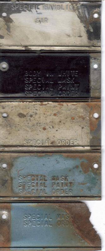

The secondary tags also can have "Special Mask" typical of many police cars, and "Special Paint" usualy on colors not a standard color for that year, will have a 99 paint code.
Apparently "Special Handling Car" does exist but again not what the original poster was asking about.

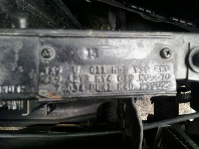

Can you post a picture of all the fender tags?

I have posted my '70 Fury III Pursuit fender tag before her about a year ago on the thread of this car. The other two are in storage and no where near me at this time.

Concur- "Special order" could be everything from Service (Police) & Executive order cars to Joe Blow who ordered the car the way he wanted it.
I once owned a "Special Order" 78 NYB, and it was nothing "special" just a really loaded NYB.

There are a lot of variations as to 'Special' tags and what triggered them. Depending on the year and plant, paint could garner a 'Special Handling'
