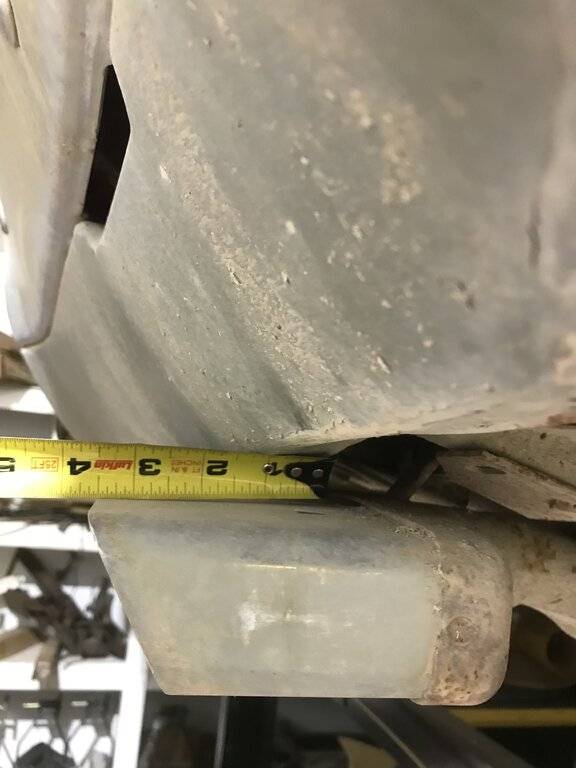

just got my tips. what's the correct length the tips should stick passed the bumper?
Salut, from the lip on the inside of the rear valance…..it does not protrude past the bumper..not even close.
