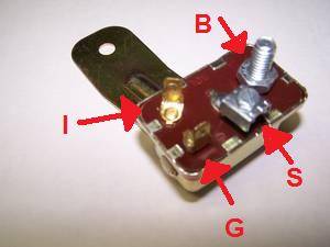

There are two different relays...
One for automatic and one for manual...
If it is a manual car then "G" is folded over and attached to the case...
"G" is where the neutral safety switch yellow wire plugs into......
You want SR105, it is the correct one, is it also used for power windows?
SR102 will work but is the wrong form factor (different mounting tabs)
(SR106 is for manual trans)

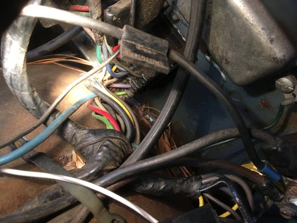

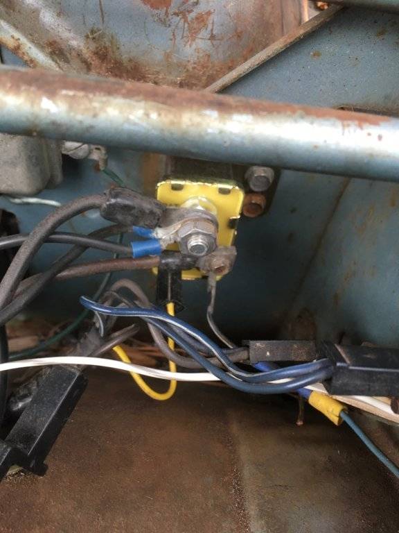

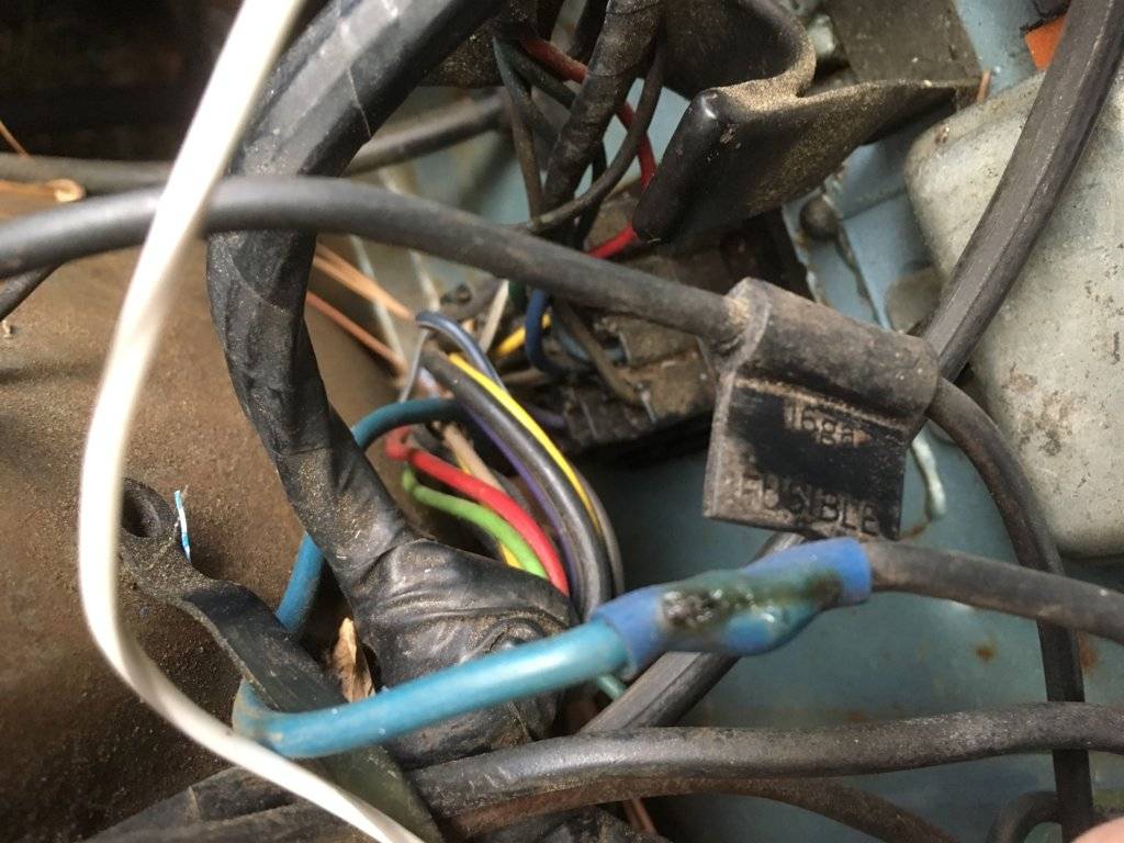

Well it went from bad to worse. I stopped by the parts store & picked up the 102 switch. It looks correct. Mounting wise & pole positions. I installed it & the car would click but that’s all. Checked the battery & it was weak ??? It’s only 6 months old & I had charged it last week. Put another good battery in & it made a strange buzzing noise. I looked over the wires & jiggled them. Went to try to start & the engine turned over good but did not fire. Then suddenly I see a lot of smoke. Turned the switch off & looked & it fried a aftermarket fuseable link a previous owner had installed. I have no idea what happened. Now with that wire burned up I get nothing.
The fuseable link that burned connects to a medium blue wire that goes into the lower right bulkhead just below that brite green wire.

Looking at that butt splice to the fusible link, I'll wager at 50% odds THAT is your original problem. Butt splices come in two quality levels: BAD and UTTERLY USELESS. I recommend you use a connector which will permit you to undo the connection if needs be AND gives an ELECTRICALLY and MECHANICALLY SECURE CONNECTION. I like 3M Scotchlock wirenuts or split brass bolts taped with rubber tape, then cloth friction tape. You can always solder the connection and use shrink-wrap also.
I had a starter relayt issue in 2018. Turned out the original factory crimped connection had burned down to the LAST STRAND OF WIRE. I could get it to start with a jump only because the absurd amount of current then would momentarily get through the single strand of wire to engage the relay.
I put a new connector on and the old relay has worked splendidly ever since. If you want to install a new one, get Standard/Blue Streak. There are few good brands anymore..... maybe try an NOS one if you can snag it.
