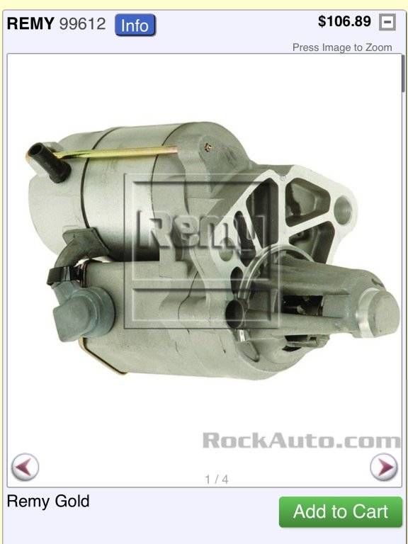

Whatever the case may be - I plan to replace it soon. In fact, I ordered a new starter from Rock Auto today for a ‘97 Ram 1500 with a 5.9 V8. It’s a new Remy unit. I also ordered the terminal relocation kit. Hoping this solves any starting issues I’ve been experiencing.
