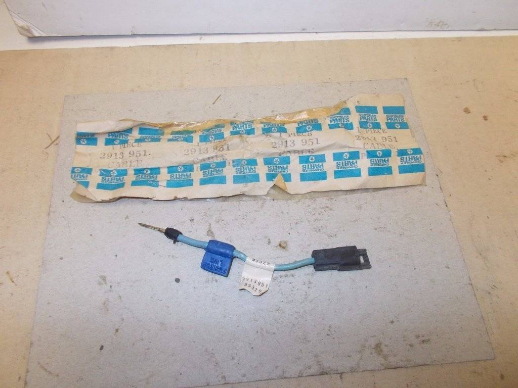

Usually some where around the starter relay or bulkhead connector at the firewall it should be a smallish wire guage will a rubber tag on it that says fusable link.
It is designed to heat up and break (open) before damage is done to the rest of the wiring harness. If yours is melted you have a problem elsewhere that caused overheating of it. With the age of these cars some members here have hard problems with them without melting.

Ok, the fusible link is located back by the bulkhead connector. This picture is from my 68 NYer. The arrow in the picture points to the fusible link.
I grabbed this picture from ebay real quick.
I would also suggest taking the bulkhead connector apart to inspect it for corrosion and/or heat damage. I was fortunate in that mine was in very good condition. It looks a little slimy because I put De-Oxit corrosion inhibitor and contact cleaner on it.
