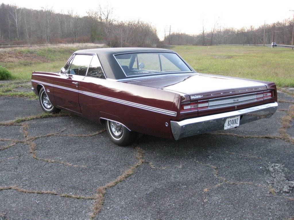

Hello All, I'd like to purchase a set of 15" Magnum 500's for my newly acquired 1968 Plymouth Fury III. With 15's I know I'll have a much better (local) tire selection. Suggestion for rim width too please...as I want to go with 225/75r-15 white walls. These will be closest in diameter to the 8.25-15 tires that would have come on Furys with the front disc brake option. The car is an original survivor so it's important to me to put the most correct wheels on the car as possible. Can I please have your suggestions and best suppliers/vendors? I believe it was the Vintiques that I saw somewhere on line and many buyers were unhappy because they were so out of round...were not able to balance them...hmmm. That scared me...want to stay away from them! Thanks in advance.
Thanks Bob
The car is an original survivor so it's important to me to put the most correct wheels on the car as possible.b

From what I'm reading, Chrysler did put 15" wheels on the front disc brake cars. Now were these only steel wheels with 15" wheelcovers then? No 15" Magnums were put on these front disc brake cars?
Reason I ask...there were/are two type magnums...the painted silver/black wheel with trim rings and the all chrome magnums (with black centers) with no trim ring. What type were the original 14" magnums?
No 15" Magnums from Chrysler at all.
1968 and older cars had a chrome rim and 1969 and newer had a trim ring. I have been told that some 1968 cars may have had the trim ring wheel, but I've never seen that verified anywhere.
It's my understanding that the Magnum 500 type wheel was never offered aftermarket with the trim ring. and Ford wheels never had the trim ring.
Thanks Big John...That makes it crystal clear. My black/silver painted 14" magnum wheels with stainless trim rings must be from 1969 (and after) then...probably for the B and A bodies then because C's had 15" wheels by then. Plus the 15" road wheels came into being then too.
So perhaps the 15" chrome magnum 500 (w/out trim ring) would be more correct for what I want to do.
Maybe someone can chime in here that has the 15" repro magnums that they had good luck with.

Thanks guys. Here's my choice. The guy that I bought the car from, gave me a set of painted silver/black 14" magnum 500's with trim rings. I can have these bead blasted and repainted and then buy a set of $800-1000 tires...or sell them and buy a new set of 15" chrome magnums for $650 and a set of off the shelf 225/75r-15 or 235/70r-15 whitewalls for $350-400. What's that old saying "6 or 1/2 dozen of the other?" I do prefer the look of the all chrome magnums.
1. What's the difference between the Ford magnums and Mopar magnums? Other than the center cap, I don't see any.
2. I'm leaning toward the 15x7 wheels...Is there any reason to think about 15x6's or 15x8's? If I remember rightly, I had 15x8's on the rear of my 68 Monaco and had trouble getting them on. They were very close to not clearing the wheel wells "on the way in" when putting them on.
3. The 68 Fury III came with 7.75-14 Bias Plys or with front disc brakes, 8.25-15 Bias Plys. Correct? I'd like to go with radials so I'm going to try to match the diameter of those sizes close as possible. Reason: I really dislike it when tires are too small for a car. 215/75r-14's are too small for these cars and that's the biggest size available (off the shelf) for 14's now.
Thanks, Bob
