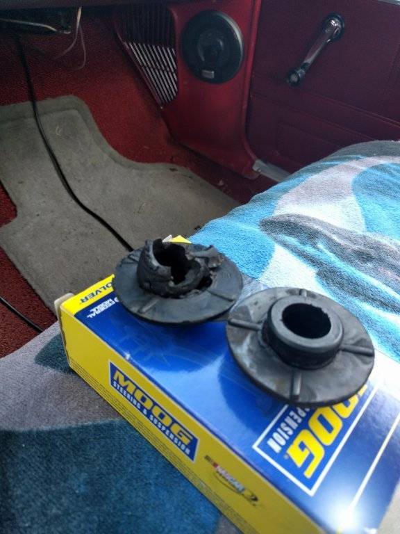

Getting some stuff sorted out before I can get a bar. Is that normal, that the front bushings on the strut rod look like that after 3 years? The driver's side was in pieces,I have now installed another set of Moog parts but does anyone know of a more durable bushing like poly? Or any poly bushings for the lower control arm and rear leaf spring shackles and such? The new bushings already got rid of a lot of noise and that boat feel where I had to aim where to go in advance.
