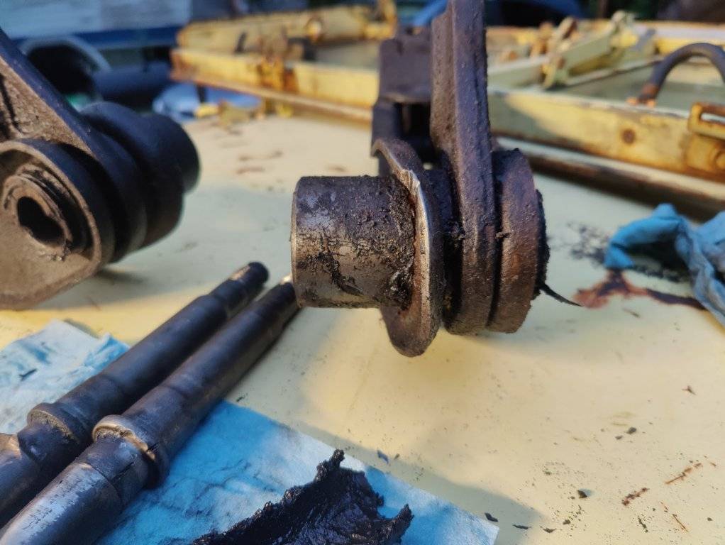

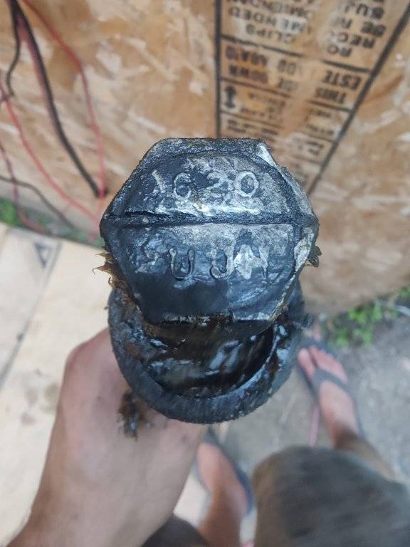

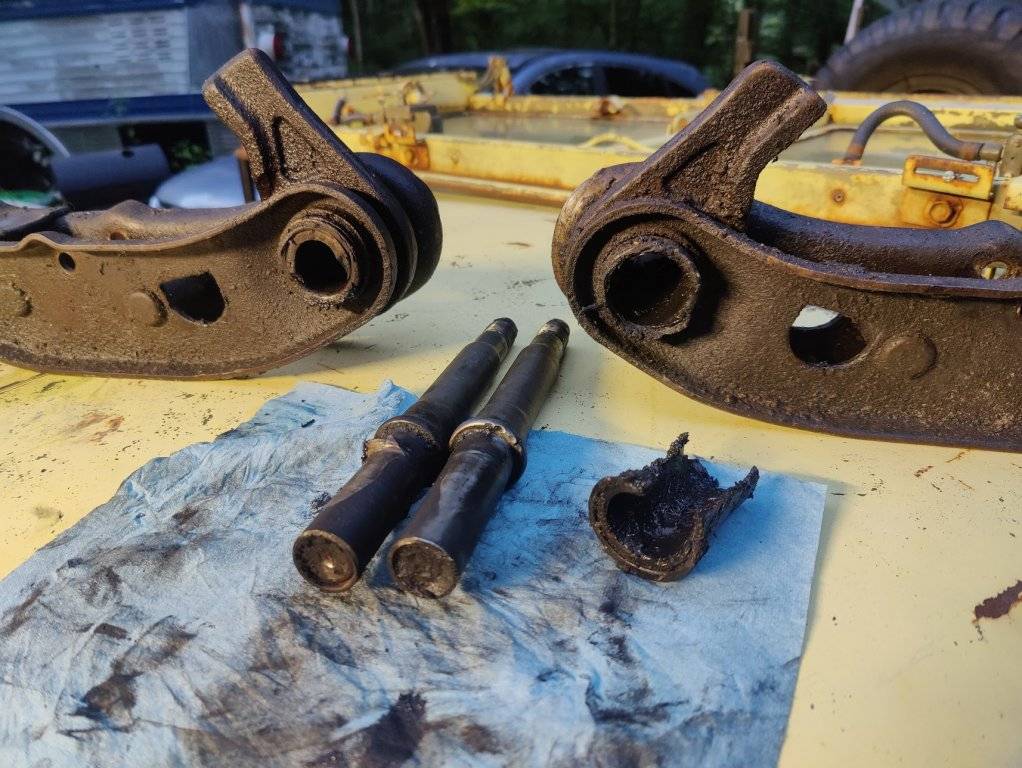

I finally got around to tearing things down. I got one arm out last night and am hoping to get the next out tonight. Overall everything came out with minimal violence required. One of the benefits of oil everywhere I guess... It certainly looks like the LCA bushing is in worse shape than I'd like. It looks like it wore through the rubber then through the steel sleeve. The thrust arm bushings were pretty much entirely gone as well but I expected that.
The good news is that I imagine metal on metal rode worse than urethane will so I think I'll have an ok time after the upgrade.

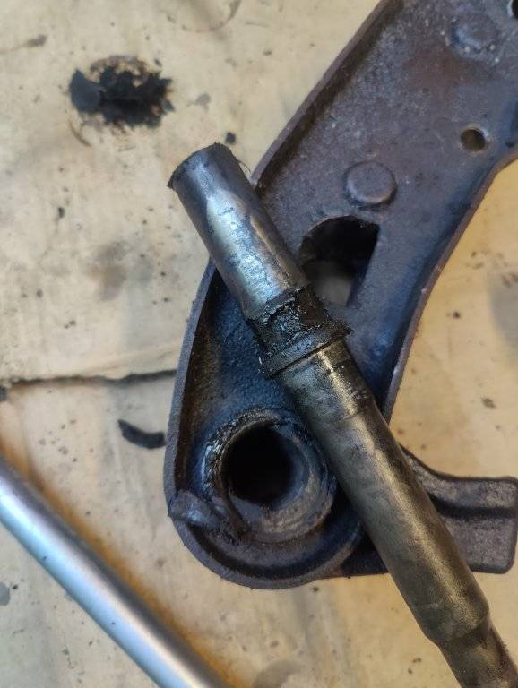

Is that worn into the pin as bad as it looks?
Is there metal flow or is that edge 100% dirty grease?

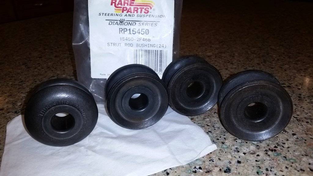

Strut rod bushings are common to B-bodies (some years, at least), so you can get polyurethane from Energy Suspension and other folks.
It's worn through the rubber, the sleeve, and I think into the pin...
I'm sending the arm in to Firm Feel for the welded plate, bushings, and powder coating. As long as they don't tell me my arms are destroyed I should be ok.

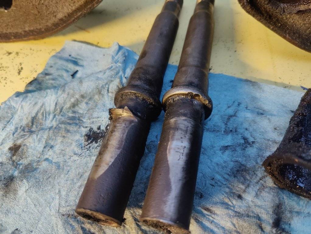

I got the other one off and got some more pictures. I'm starting to think the last mechanic didn't earn all the praise I've given him... I'm not going to name names because I don't know if it may have already been like that. The mangled bushing pin actually came out of the straight control arm to make things more interesting.
I'm putting out some feelers to see if I can get a replacement drivers side arm and will also ask the Firm Feel guys what they think before they do all the work to it.

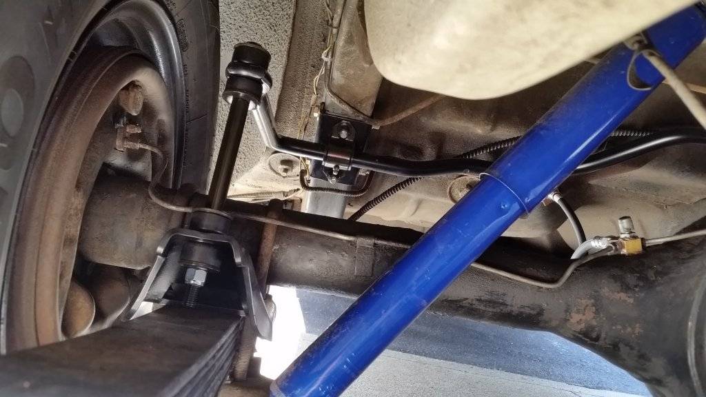

If you're on a budget, I'd skip the upper arms (tubular, I presume) and the LCA plates/powdercoating and do the rear sway bar.
Painted LCAs work just fine and the plates can easily be welded in later at home.
Esp as you are doing rear leafs, that's the perfect time to put the swaybar brackets on the U-bolts.

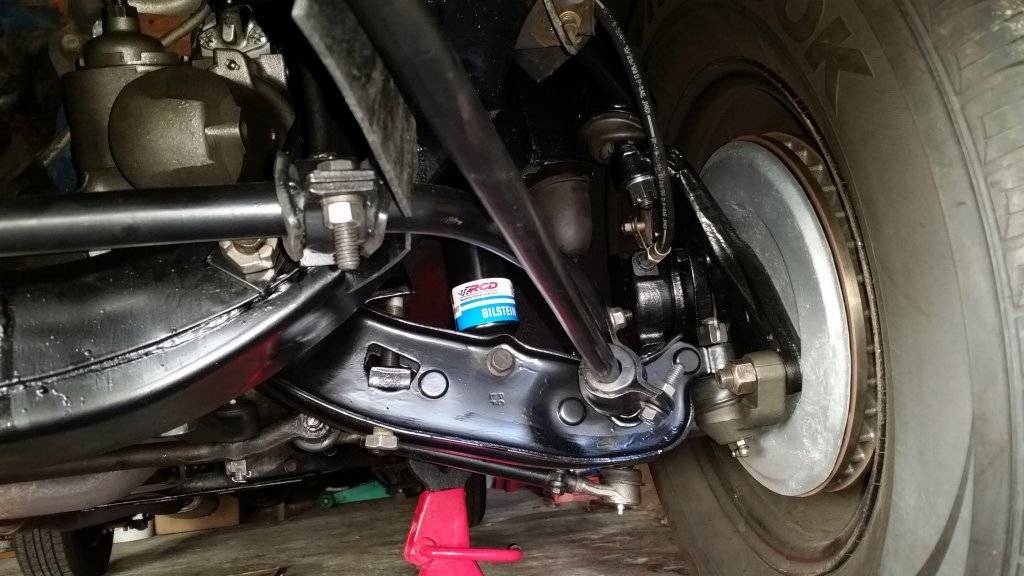

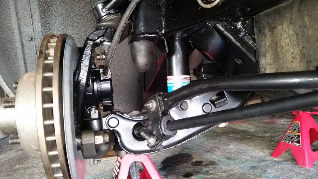

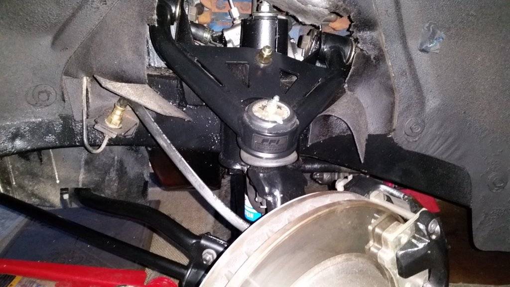

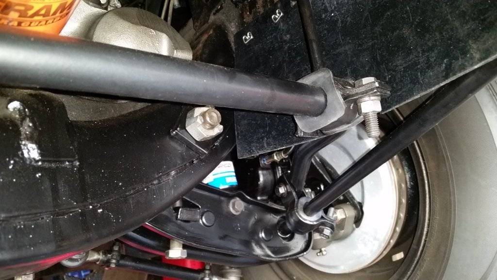

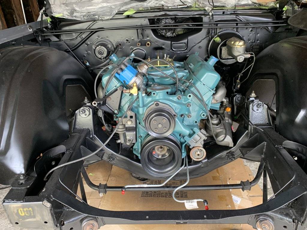

I reworked my entire suspension in 2016 and have only driven the car 1,200 miles since then. I did the '73 Front Disc Conversion and while I was at it I rebuilt the entire suspension. I was going to just change the bushings and ball joints on the original UCA, but decided to go with Firm Feels Tubular Control Arms & the RCD Bilstein Shocks. I got Firm Feels Rear Sway Bar and used Monroe Shocks. Since my dad had new factory Upper and Lower Control arm bushings in his stash from 40 years ago, I used them. I got the Strut Rod Bushings, Pitman Arm & Lower Ball Joints from Rare Parts, Inc (quality much better). For what I couldn't get from Rare Parts such as the Idler Arm and Tie Rods, I just got Moog. To replace the front sway bar bushing I just I got PST's Stabilizer Link since the factory link had to be cut off and used Moog. Back in the day if the sway bar bushing needed to be replaced, you'd have to buy the entire sway bar with the link attached cause that's the way they did it. Lastly, I got my steering box rebuilt by Firm Feel - I got a Stage 1 and it's much tighter than the factory.
I pulled the motor during Covid to detail the engine and engine compartment. The body has 67K original miles and the motor about 20K since my dad rebuilt it in the '70's. I just got it back together last month and only drove it 30 miles to a car show and back. Just to see if there was any interest, I put a for sale sign on it. While on a 3-week cruise vacation I got a call from an interested buyer. He saw the car 6 years ago when I showed it at the same show. A friend of his happened to be at the show and told him he saw a 66 TC that was for sale. Long story short, Old Betsy will have a new owner tomorrow, Saturday. Good Luck with your project!
