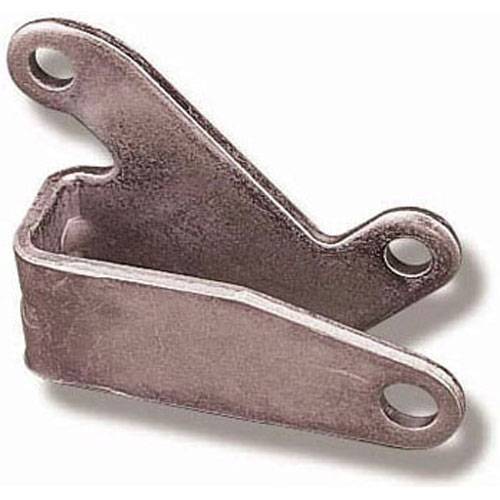

    Its a rather long story but Im wanting to swap carbs for a few reasons this evening after work - I have a 650 Holley that's been previously set up for a chevy that I want to try on my 383/727.
    Im currently running a 750 Edelbrock. I had to get a specific linkage adapter for the Edelbrock.
    Do I need a linkage adapter to run the Holley or anything else besides a new gasket?

    I am under the impression that the Mopar throttle linkage adaptor from your Edelbrock can be used on your Holley.

    FYI - while it could be modified to work - the two brackets are different. Since Ill likely go back to an Edelbrock at some point Im not going to afro engineer it. Waiting on a stupid $9 part again....To show the difference - Edelbrock on top/ Holley on bottom
    • Like Like x 1
