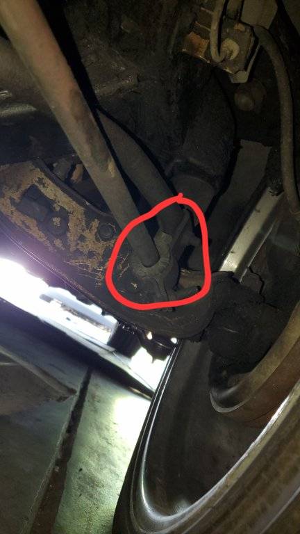

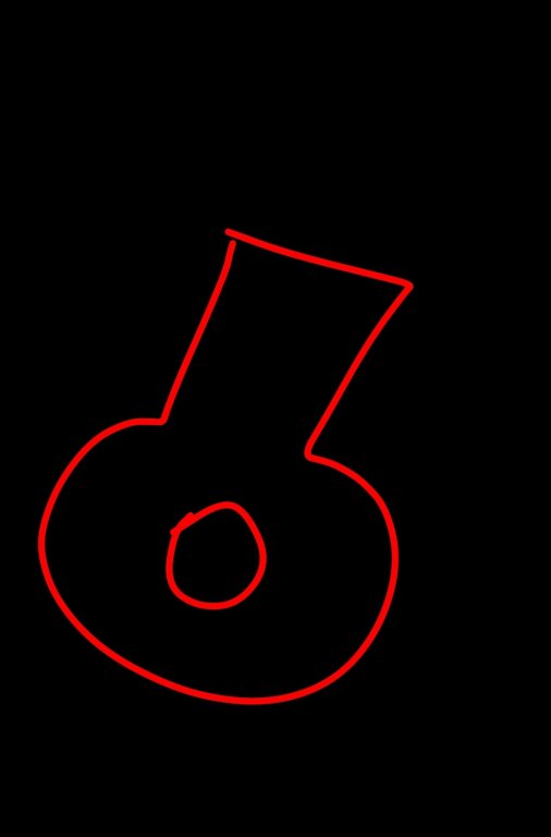

Guess I thought this was a sway bar bushing? But every single search for any type of bushing doesn't pull this up. Any help you can give?
Hmmm maybe? Looks like Its shaped like this but I can't find a single bushing anywhere online that matches

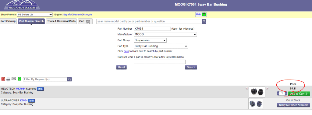

the replacements currently available do not have the extra tab on them..they are just a round bushing...K 7064...grabbed mine from O Reillys for 10 bucks...had my 68 for 23 years and those bushings had already been replaced by the current style when i got it...just replaced them now because i had everything apart to change the square ones on the links ,not because they failed so i dont see any issue with them not having the extra tab

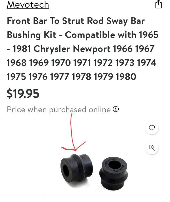

Ok. So I don't need to have that nub? Won't cause any issues not having it? You can see it in my first pic. I can just use a regular round one? Also , here is what I got. Looks like the right description but has that ridge in the middle. That doesn't look right
Not sure why nobody apparently repros the OEM design cushions, other than the more-plentiful B-body designs have higher sales volumes and the indicated items are more "will fit" rather than being accurate to the orig items on C-bodies. That upper nub better fits the brackets on the C-body cars, but might not really be needed. Unless it was there to keep the cushion in place as the strut bars and sway bar ends traveled through slightly different arcs as the control arms went up and down? But, the nub-less items could do the same thing and probably not have any durability issues over time?
Key thing, of course, is the ID of the cushions, so check that prior to attempting installation. I'm wondering if there might be an existing front sway bar mount bushing (not a Chrysler application) that would have the needed ID and then could be selectively modified (i.e., "cut-down") to fit the existing bracket assy?

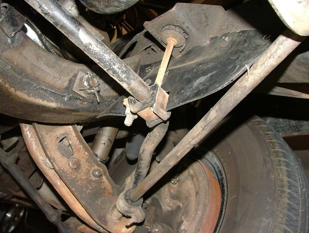

hard to tell from your pic...my bracket set has a bulged out area all around for that ridge to fit into...in your pic your bracket looks flat?

You need all three of these bushings / pads on each side. Pretty sure I bought them all at RockAuto 4 or 5 years ago.
Went back and checked, all the new bushings were Moog, sorry no numbers or photos.
