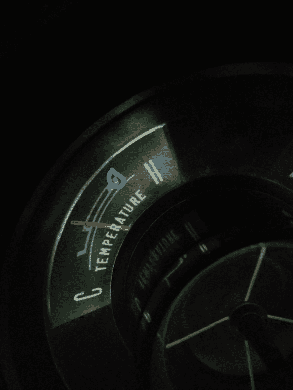

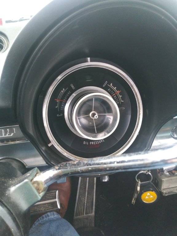

When warmed up and at operating temperature,using a laser heat gun point it to the upper rad hose just above the thermostat.
Compare that to the gauge.
As mentioned as well you can install an aftermarket temp gauge.
Since my car has idiot lights..I rely on the hand held laser temp gun.
Besides if your car has a B or RB engine they run on the warm side anyways.
