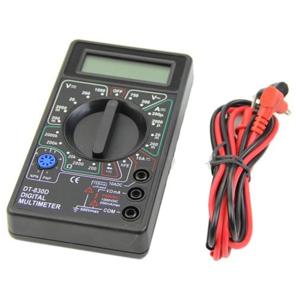

Do you have one of these elcheapo multimeters?
I get them free with a Harbor Freight coupon.
You'll need it if you use an old computer peripheral transformer after you snip off the plug so you can determine which of the two wires inside the sheathing is pos. and neg.
Yes an old needle type.

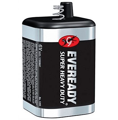

Would a 6V battery power one? Just need to see if it powers on and can pick up stations I think. I'm not planning to power it long term.
basically testing to see if it will work in a car. I have a few radios to sell.

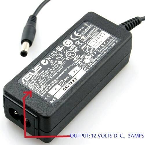

I'm not sure what you are referring to when you say 110/120 power cords.
Picture?
I meant power supply like you posted above. I have less than a basic understanding of electricity and electronic principals and or electronics if you haven't figured that out LOL.
Oh, ok. The item pictured above is a transformer or aka a "power supply".
It converts 110v A.C. household current to a lower votage and current by means of smoke, mirrors, voodoo, and pixie dust...
Best bet if you are "electrically challenged" is to use a 12 volt car battery. Then you aren't worrying about amperage draw, conversion to DC etc.
