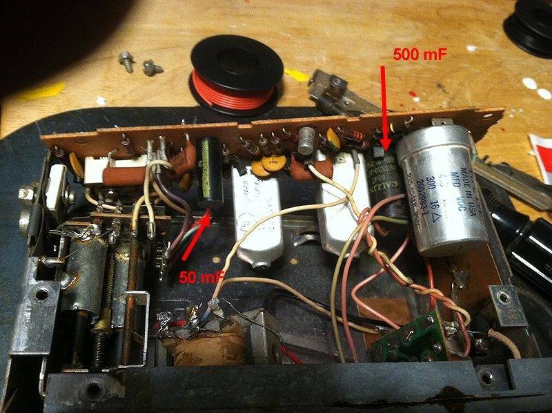

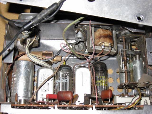

Old capacitors. Paper, wax or can. They are good for maybe a couple of decades.

Below two radios I had for my truck. One from 1964 and the tube from 1963. Some tubes seem to have no capacitors to deal with just those two tubes which can last a long time if handled correctly.
Understanding capacitors:Replacing Capacitors in Old Radios and TVs

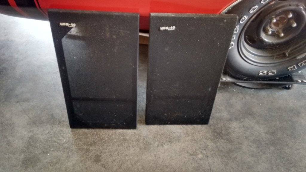

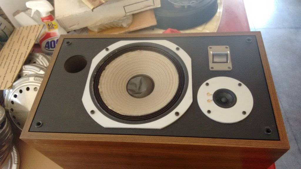

Big speakers sometimes don't work well as they take more power to drive than some of the weenie sets are capable of producing. If the audio is weak, don't automatically blame the radio.

Forgot to add, tallhair - if you turn on the radio and it has a loud buzz or raspy audio, most likely your electrolytic filter capacitor has dried out. Shut it off before you fry something else. If it's a tube set, check the tubes to see if any have internal shorts. Always a good idea to replace the caps in an older set anyhow, the filter at the very least. Give the controls a shot of contact cleaner and work them well while it's out of the dash, too. Gets rid of the scratchy volume noise.
