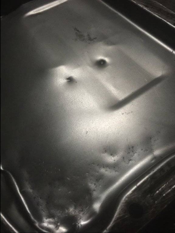

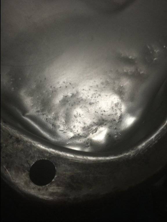

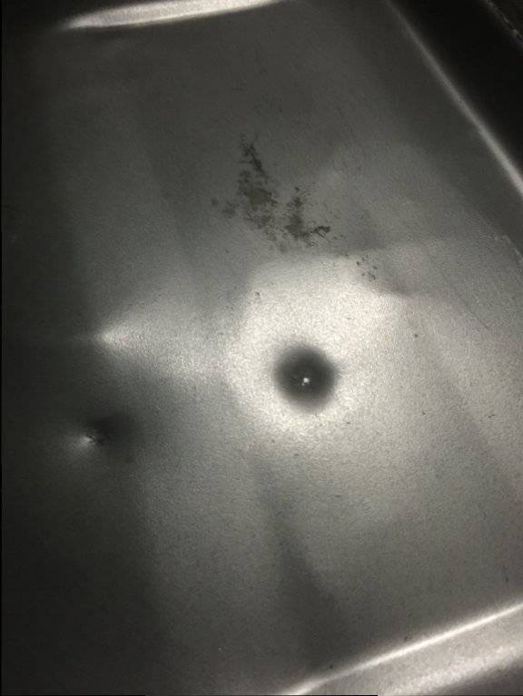

Finally I used 5qts. I drained the pan, changed filter and the fluid that came out was very very clear, pink and shine :D so I only changed the fluid that came out
I didn't find any metal residue but found some strange marks in the pan, so now I don't know if my tranny really needs to be rebuild, I was expecting to see a lot of metalic residue in the pan due to the strange noises of the tranny and the reverse problem, I'm expecting some improve in ride quality once I fix an ignition problem and be able to test the car :)
