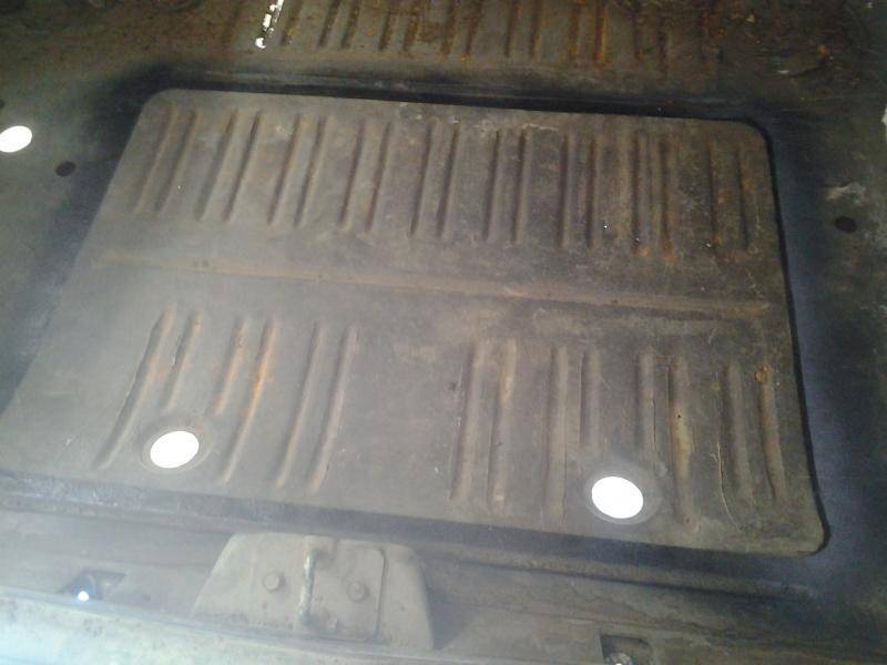

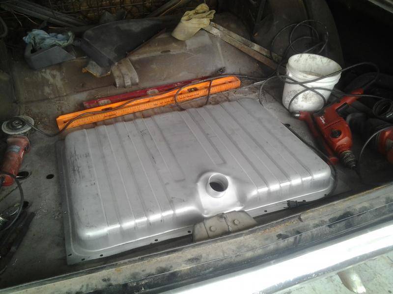

Very nice, did you come up with how it's going to be filled? Also, can you explain the pictures, first one looks likes it's in place, second is what you cut out? Third, no clue!

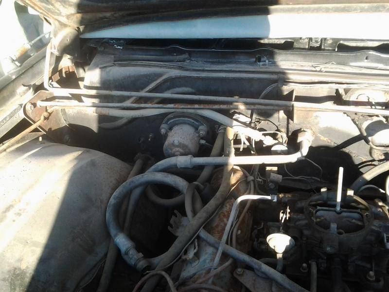

Yeah I guess I posted them backwards. The first one is in setting in the car, the second is a paint out line off of a template that I made for the cut out and the last one is the stock tank next to the new tank I just installed. I don't know at all why there is an engine shot in there. I didn't post that that I know of! :oops:
