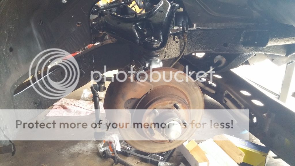

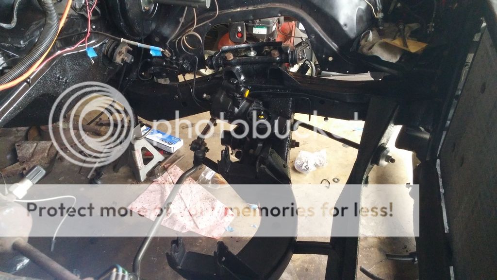

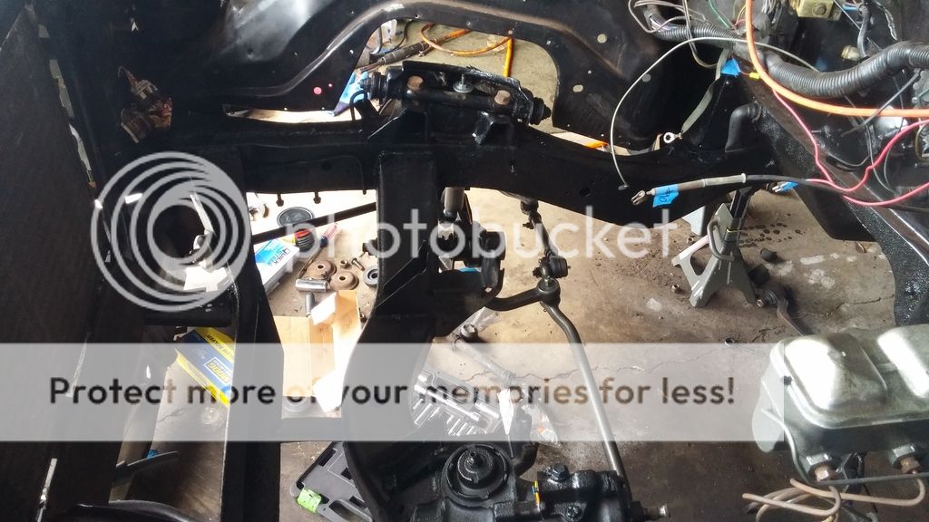

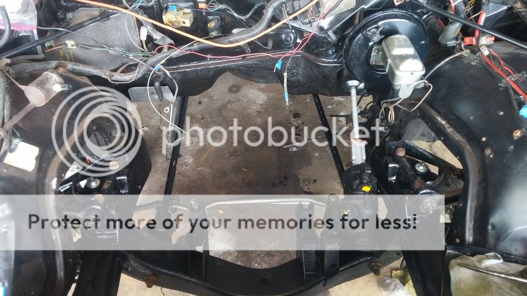

Just about wrapped up with the front end. Need to find some t bar adjusters to finish her off.

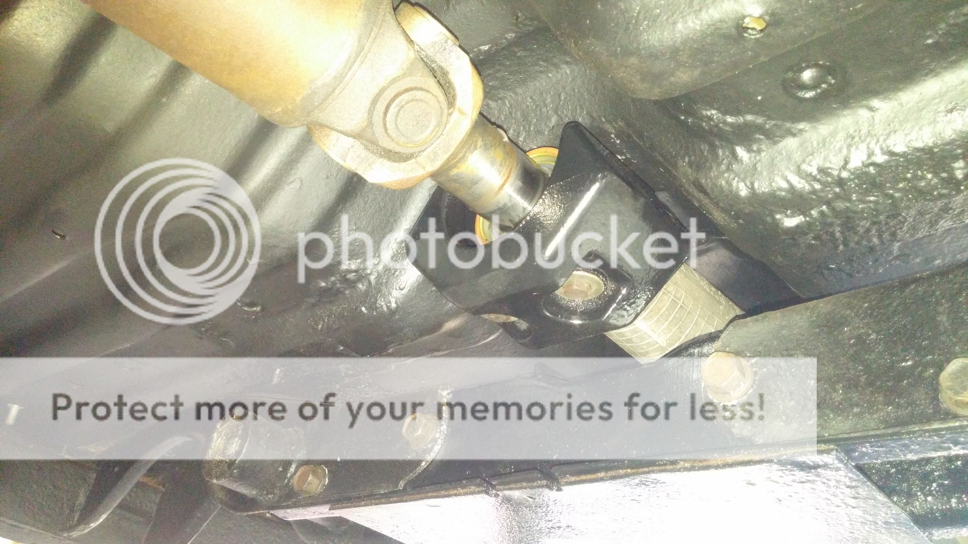

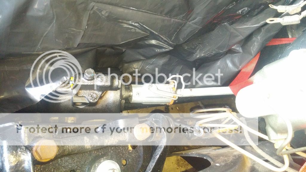

I had the cover on the steering coupler, but had to smack on it to get the coupler on the gear, and it popped back off. Have to order one of those springs for it.

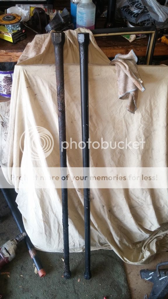

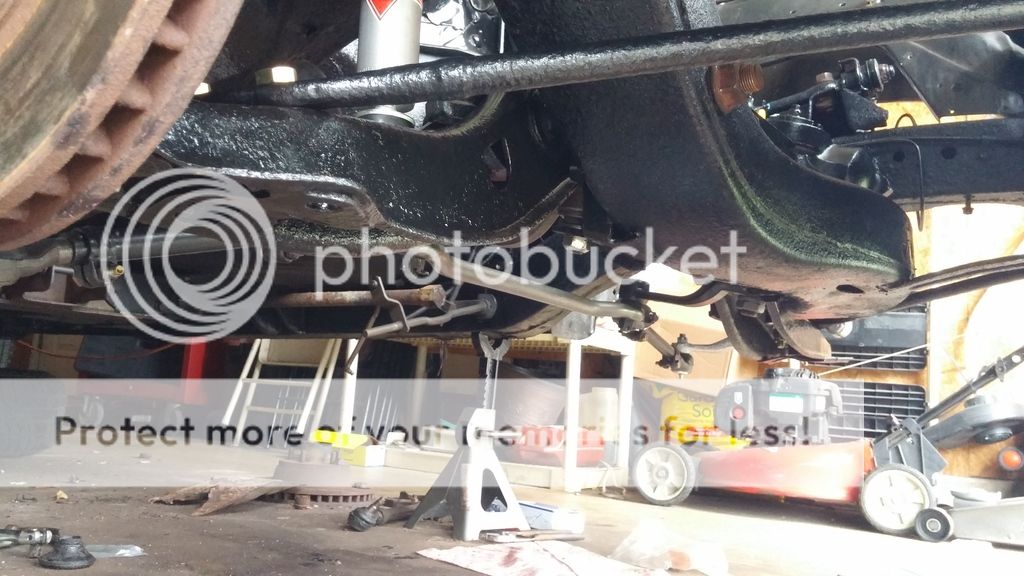

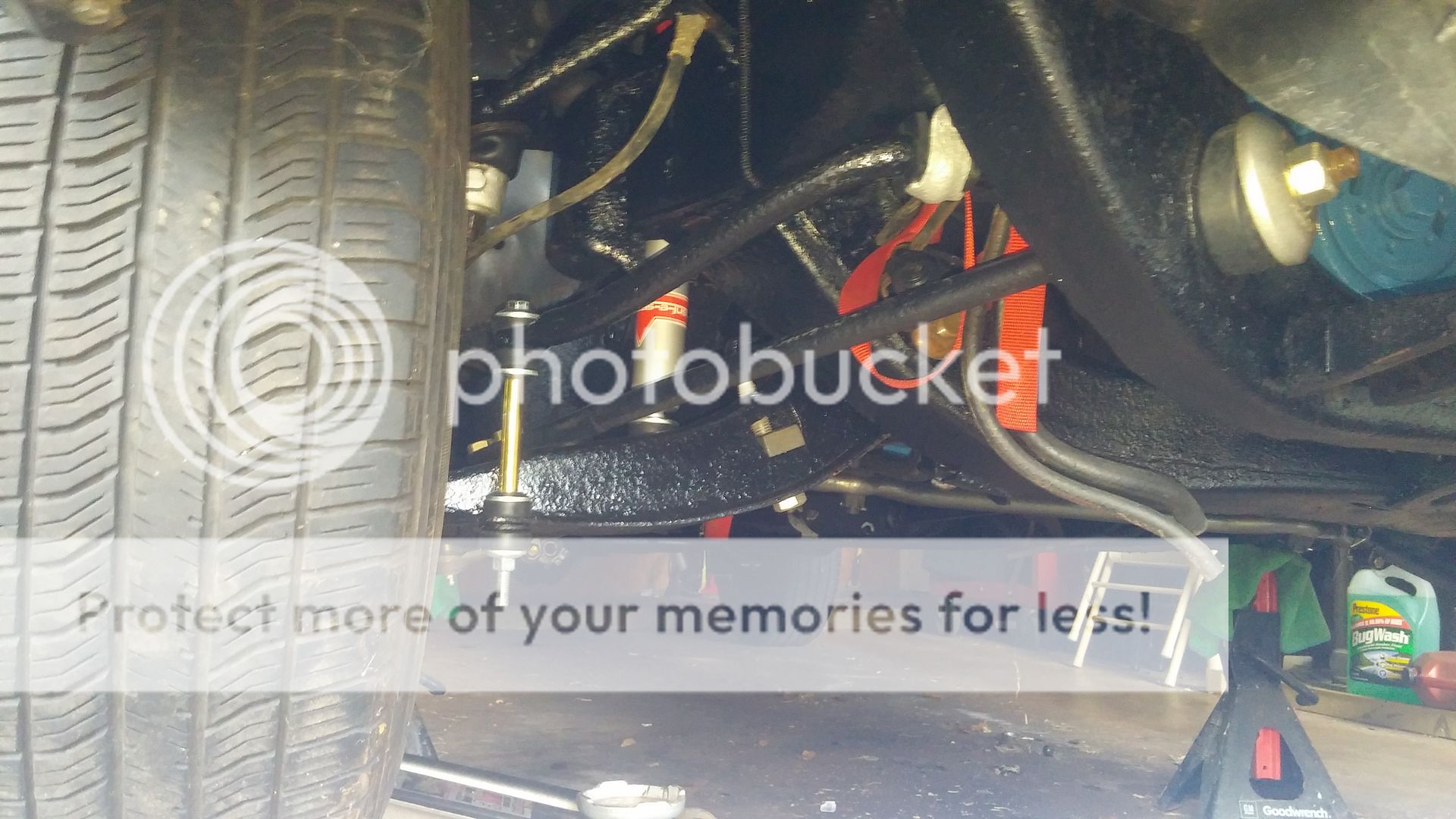

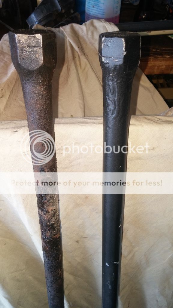

Installed the new to the car cop car T bars today, that I've had for years. They are a bit bigger then the original bars. I'm on the fence about the firm feel sway bar. Still like to get it, but tempted to clean, and reinstall the old bar for now ($$$).

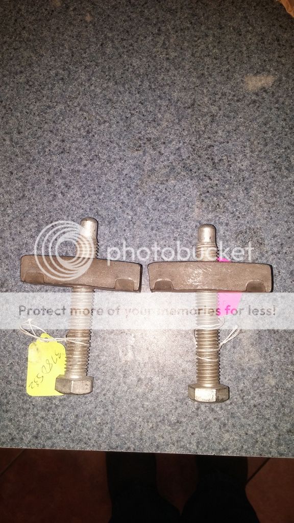

Ordered some NOS adjusters from classic auto supply. They showed up today, and got em installed.

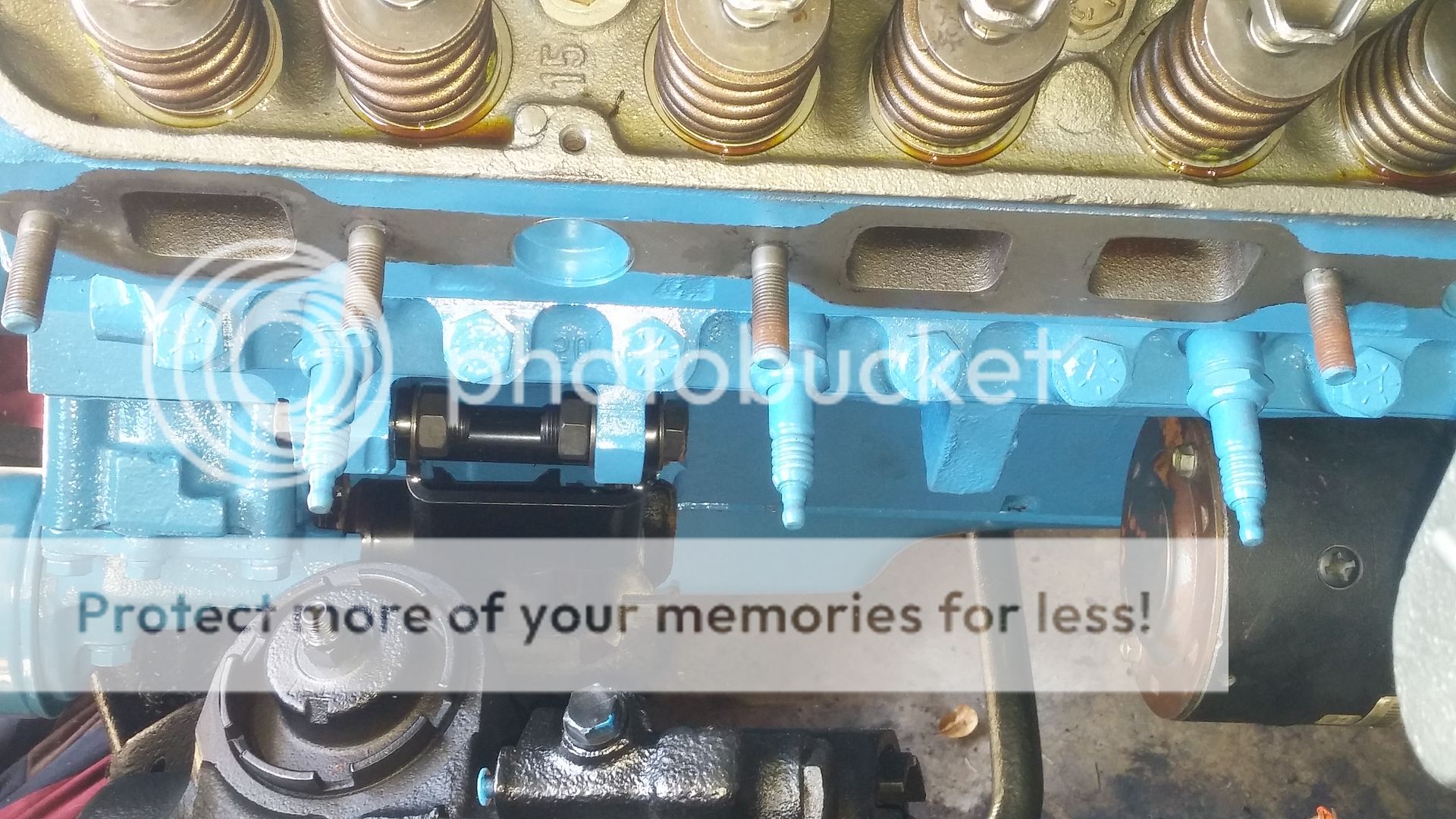

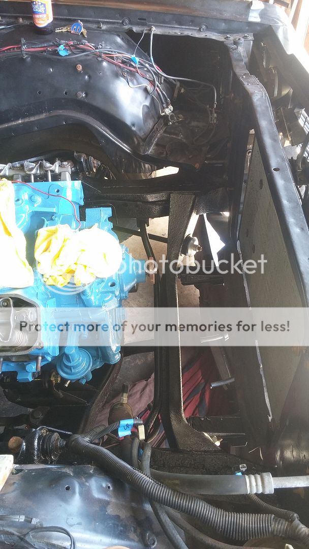

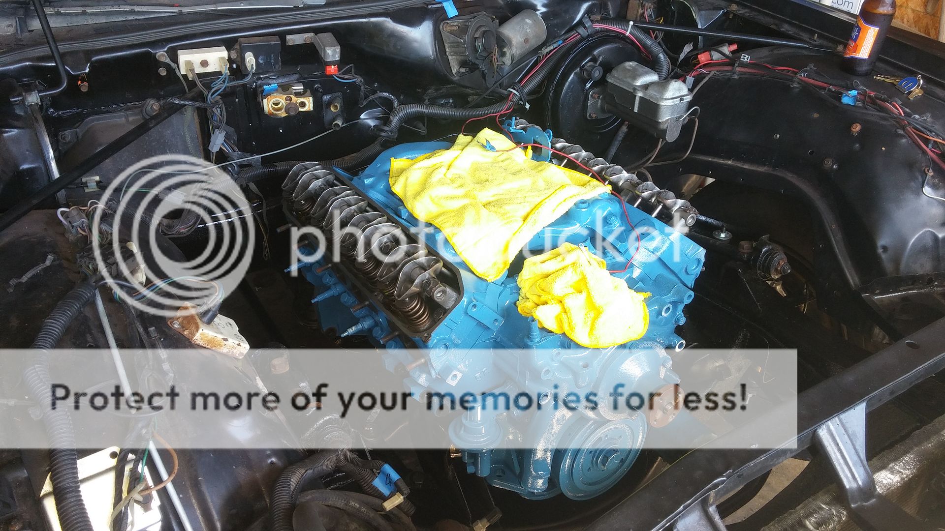

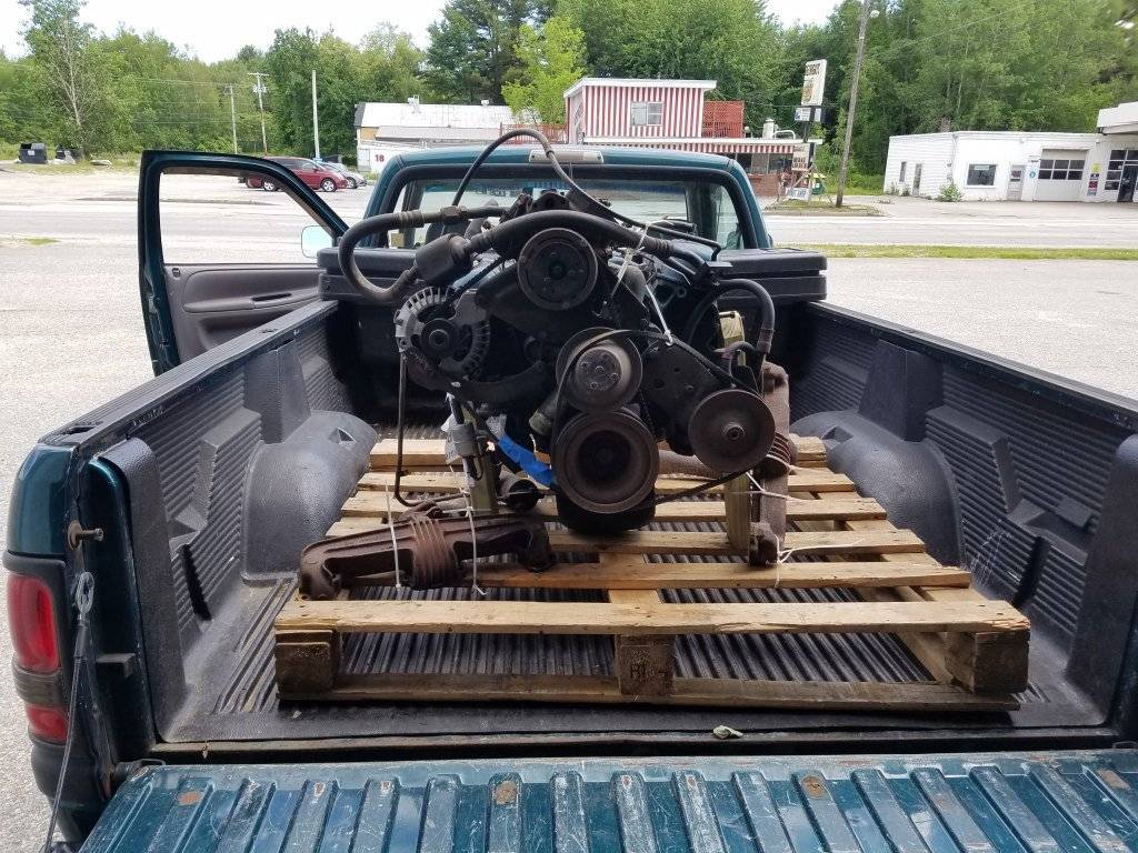

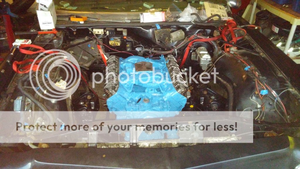

Then the real fun! Got the beast installed! Had to widen the new holes I drilled a little. Shes a little crooked at the moment. All the bolts are finger tight till the trans gets installed. Felt good dropping it in! Waited 3 years to do that lol
What were the holes for you had to widen, Zac.
The new motor mount holes drilled in the perches of the frame (can see it back on page 31).
Had to cut one of the ears off the mount, and drill holes lower down to accommodate the big block in the small block stub (per the shumacker instructions)

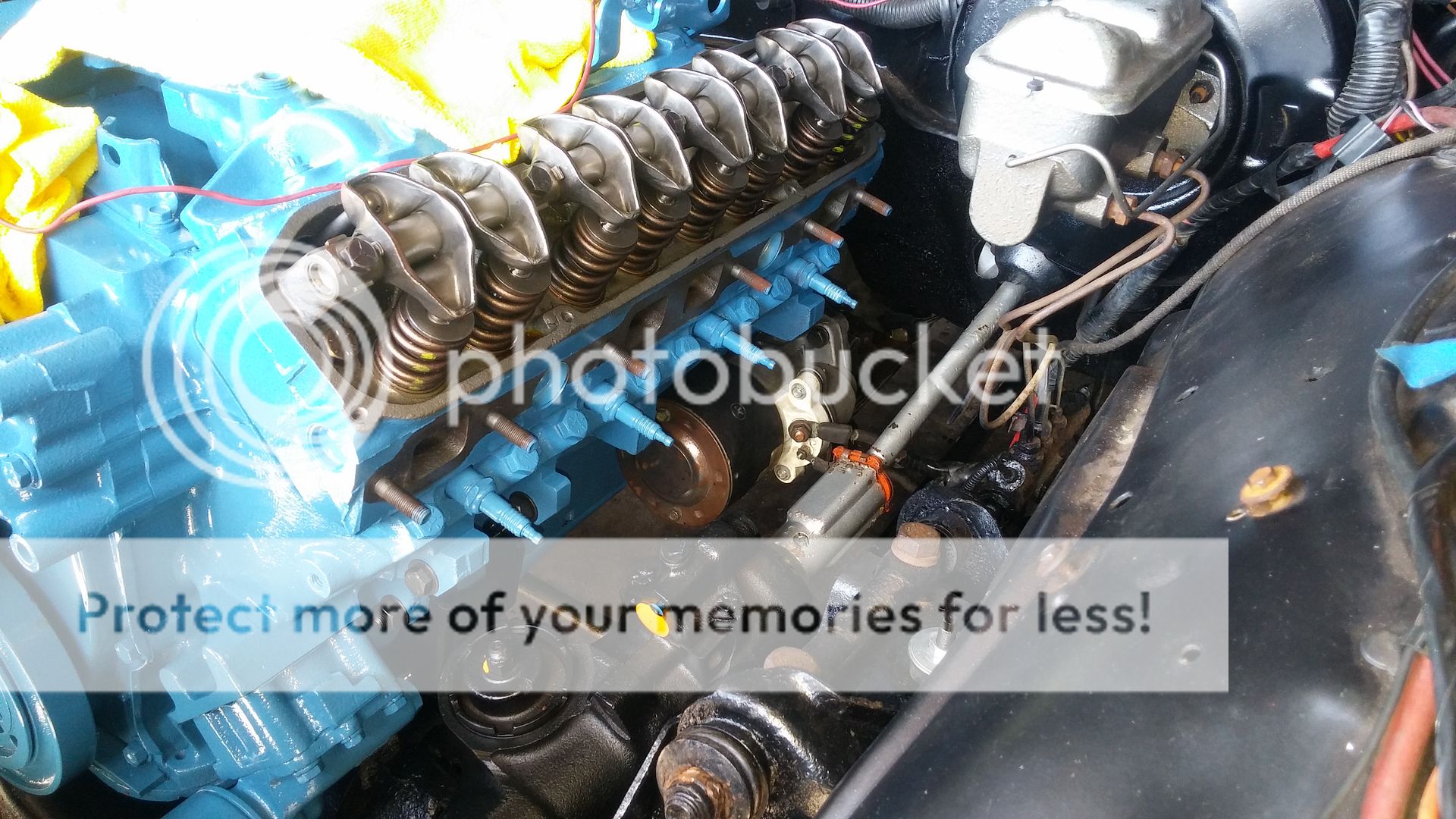

The brake booster seems pretty close to the engine. Hoping my mopar finned valve covers will fit.
Also the engine doesn't seem as high as I thought it would have. I might have been able to run an eddy rpm intake like I wanted too.. But not opening that back up lol

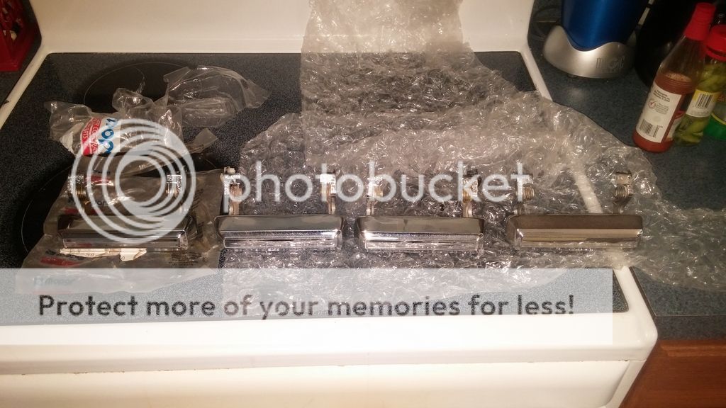

I did some horse trading, and got a new set of exterior door handles. Two nice used ones, one a bit weathered, and a pretty NOS one. Even the weathered one is a bit nicer then the originals. They are heavily pitted. Should go well with the NOS mirrors I got from Mr C. Gonna look a little out of place on the blumo though lol.
I tried instlling the spring for the steering coupler cap. Ofcoarse formals have to be different then the other cars! This coupler seems a bit longer for this spring to work on it. Figure once I get some more gas for the welder, I'm just gonna tack it on.

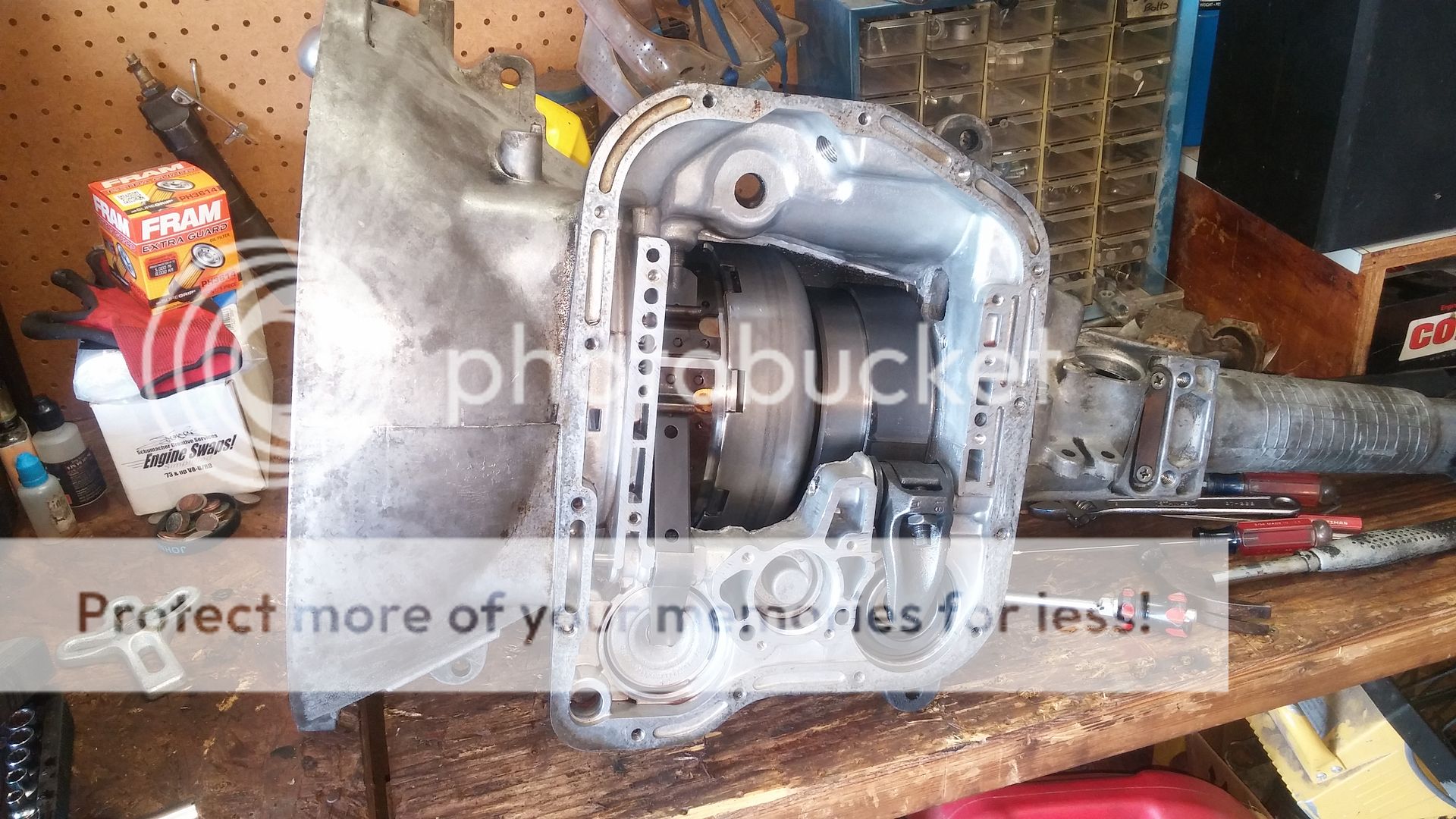

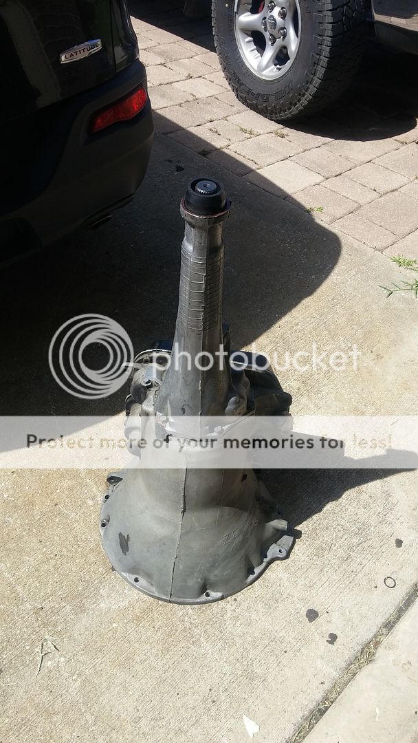

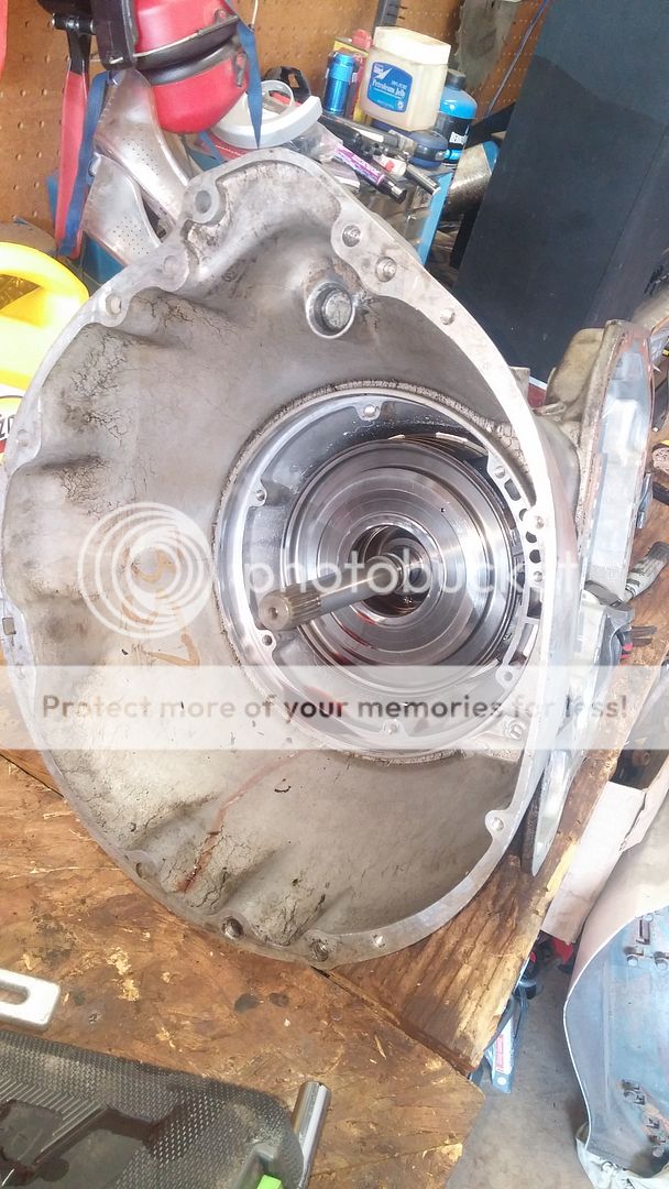

I drug this nasty thing out, and found an old 727 hiding under there.

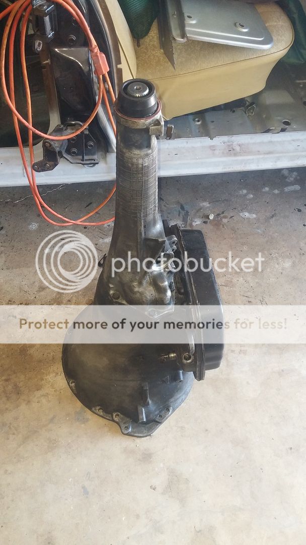

This is the old 727 out of the Cordoba. It was rebuilt 11 years or so ago, with not many miles on it. It worked flawlessly. However leaked like a mo fo. All the seals were dried up.

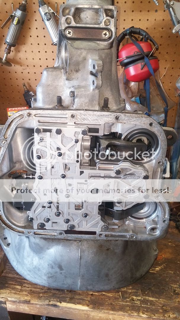

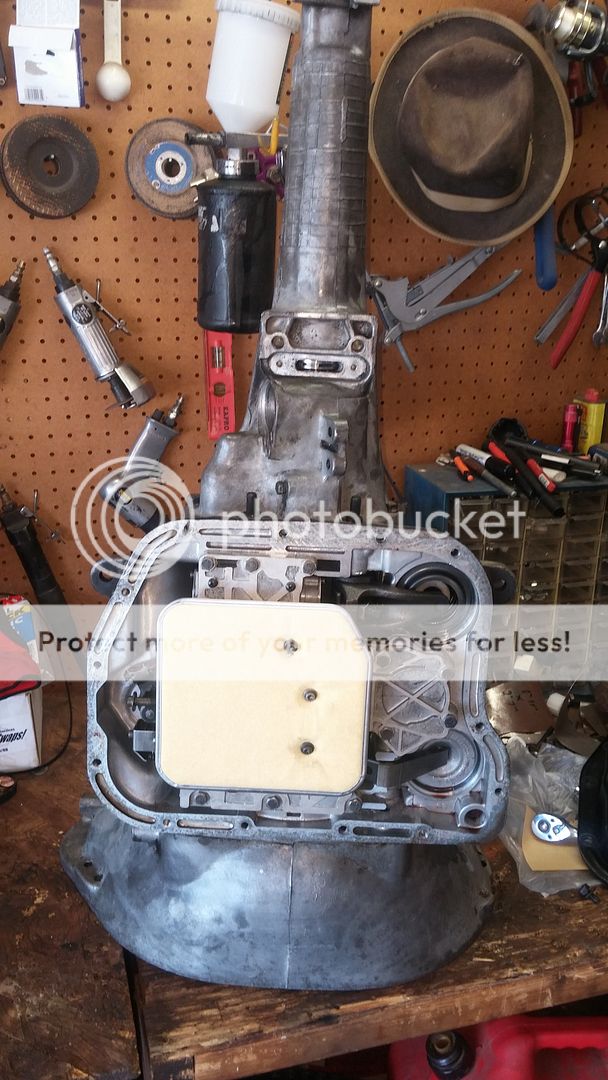

Today, I ripped the valve body out, and replaced the shift shaft seal. Also pulles the front pump off, and apart, amd installed new bushing, seal, O ring, amd gasket.
Hopefully no more leaks! Need to order a couple other things, and she should be going in soon!

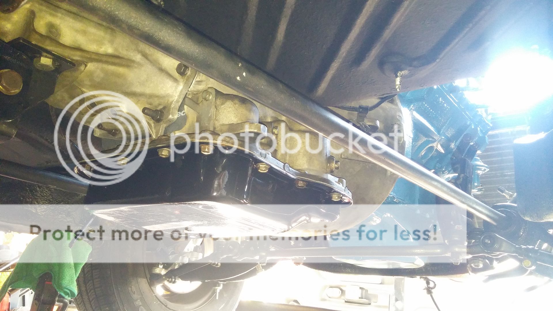

Been tinkering with the old girl here, and there. I stripped, and painted the old sway bar, and ordered some new hardware. Got it re installed. Also stripped, and painted a couple other small bits, and installed that got missed before.

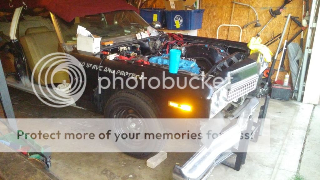

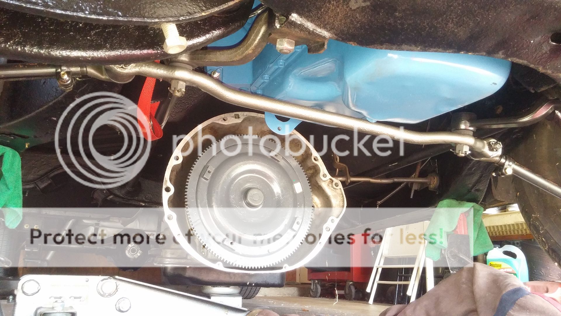

With the correct convertor, finally got the trans installed! Been having to make a few things work, but alls good so far. The old driveshaft should work! The yoke sticks out a little more from the trans then before. Also need to get a conversion u joint for the rear, as its wider. The small block trany dipstick should work too. I need to bend the bracket that attaches the tube to the top of the bellhousing to work with the big block.
The starter is in, as well as the convertor dust shield. The engine is sitting much better now.

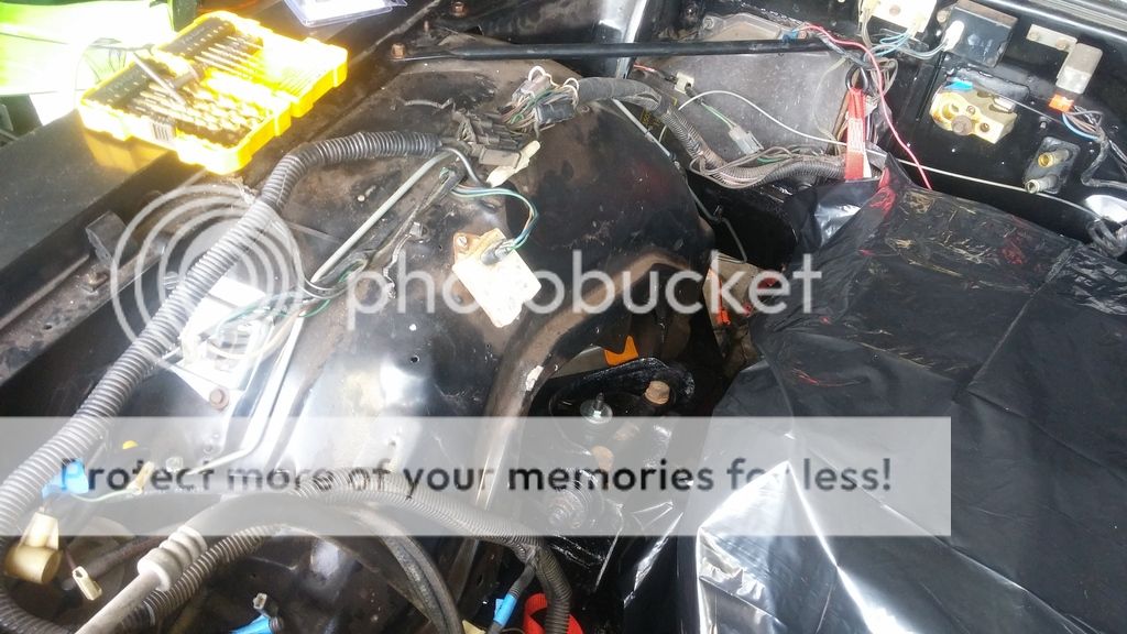

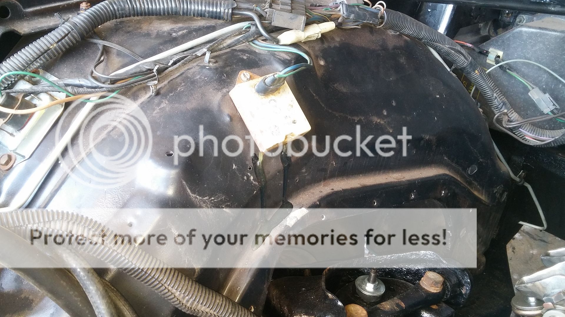

I've noticed a few hiccups under the hood.. The last month or so my elctronic boxes have been melting, and leaving a mess.. Thank you FL heat. Anyone know what these boxes are?
Also noticed now with everything mounted ofcoarse! That the oil dipstick might be a pain.. The hole is behind the driver side engine mount. Theres no notch in the mount for the tube..
