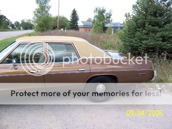

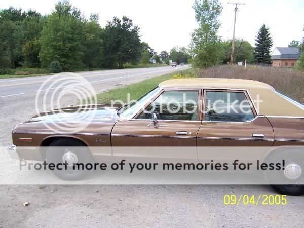

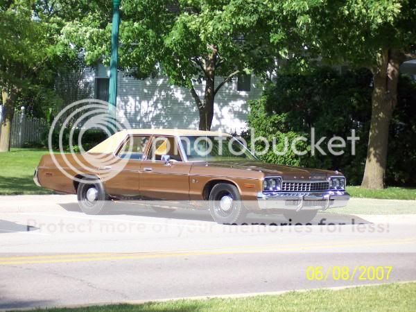

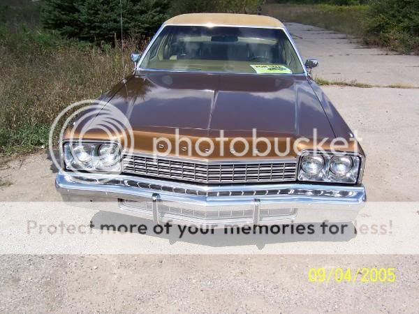

Pics of from when it was first spotted (notice the police dog dish caps? Some kids stole them between then and the 2nd time around before buying it).

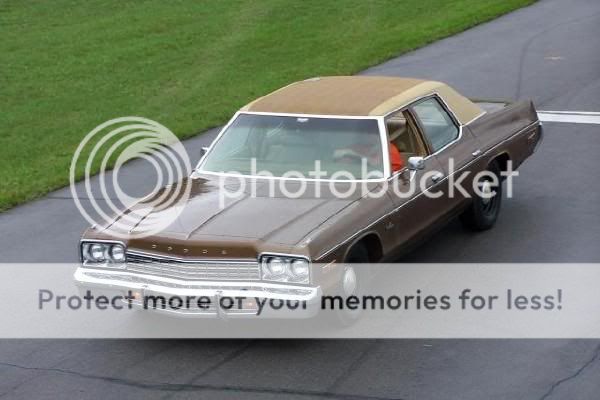

The car has a stock 2brl 360 engine, 727 trans, and 8 1/4 rear with 2.76 gears. Shes far from giving anyone whiplash at full throttle lol. But is a very dependable cruiser.
I drove, and enjoyed the car for a few years as she was. Took her to a few shows. Only big problem I ever had (wich was my own damn fault!) Was I replaced the valve covers with some shiny chrome ones at one point. Well a few weeks later my whole wiring harness went up in smoke! Luckily no fire.. The wire insulation had worn down on the wires going over the passenger side valve cover, and zap! Had the nice bare metal to contact. So had her towed to the local chrysler dealer, and had a new harness made up at $1200! They did do quite a nice job though, I was pleased with it.

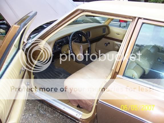

Interior is pretty clean, and all there. Right down to the music master AM radio.

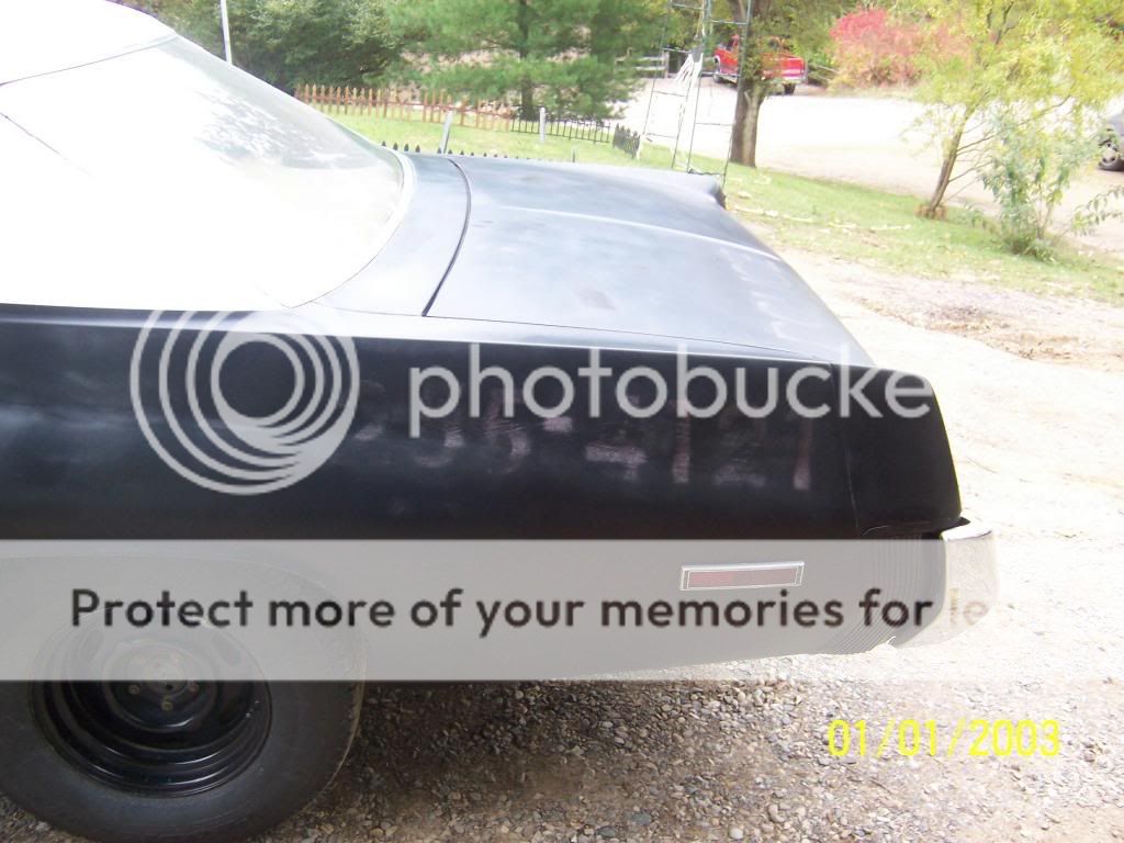

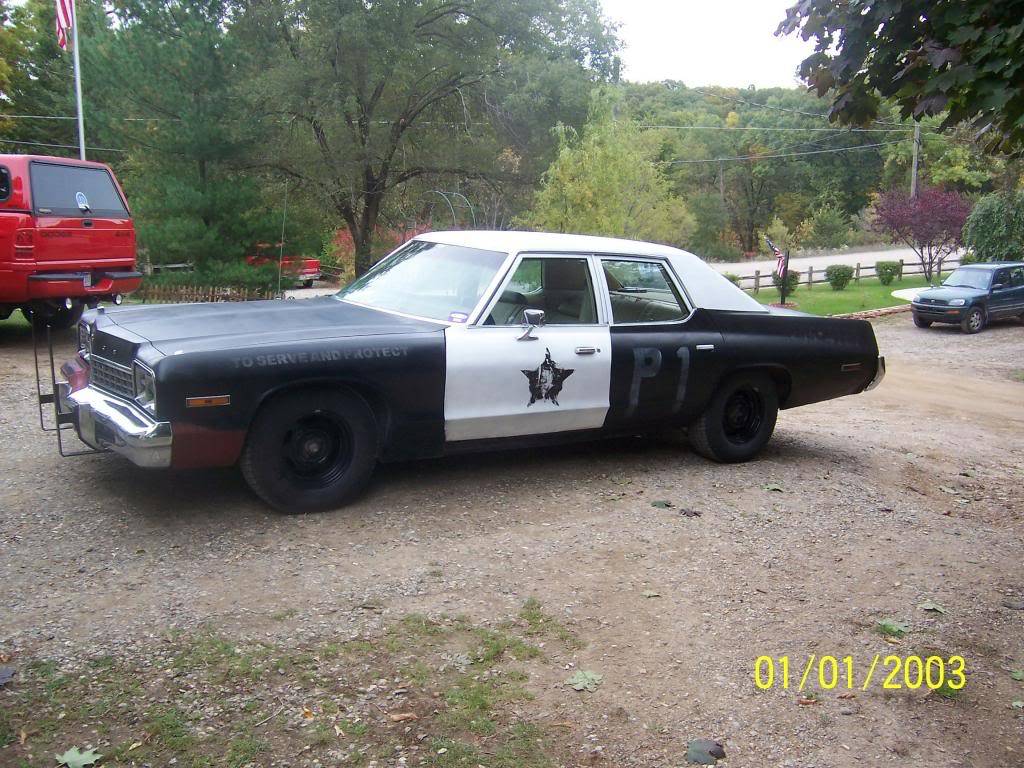

I took the car over to a buddys shop to mess with. I had never done any kind of body work. He got me started and off I went. worked on her for several weeks, and in the end out came a bluesmobile. I was a little reluctant to do a blumo at first, but went with it.
I got the car back together and brought her home, and started doing the graphics. Now this car is supposed to look like sh#t, so no fancy stuff. Actually makes it kinda fun, cause its cheap, and if something messes up "whoops, I meant to do that".
First the P1 on the rear doors. I took an old paper grocery bag, cut out the template, and taped it to the car. Then just mist the paint over the area. Dont want a solid color, as its supposed to look worn. Came out better then I thought it would have, the P1's arnt perfect but they do the job.

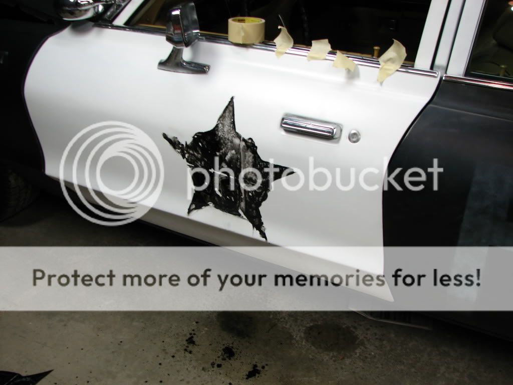

The star came after the P1.

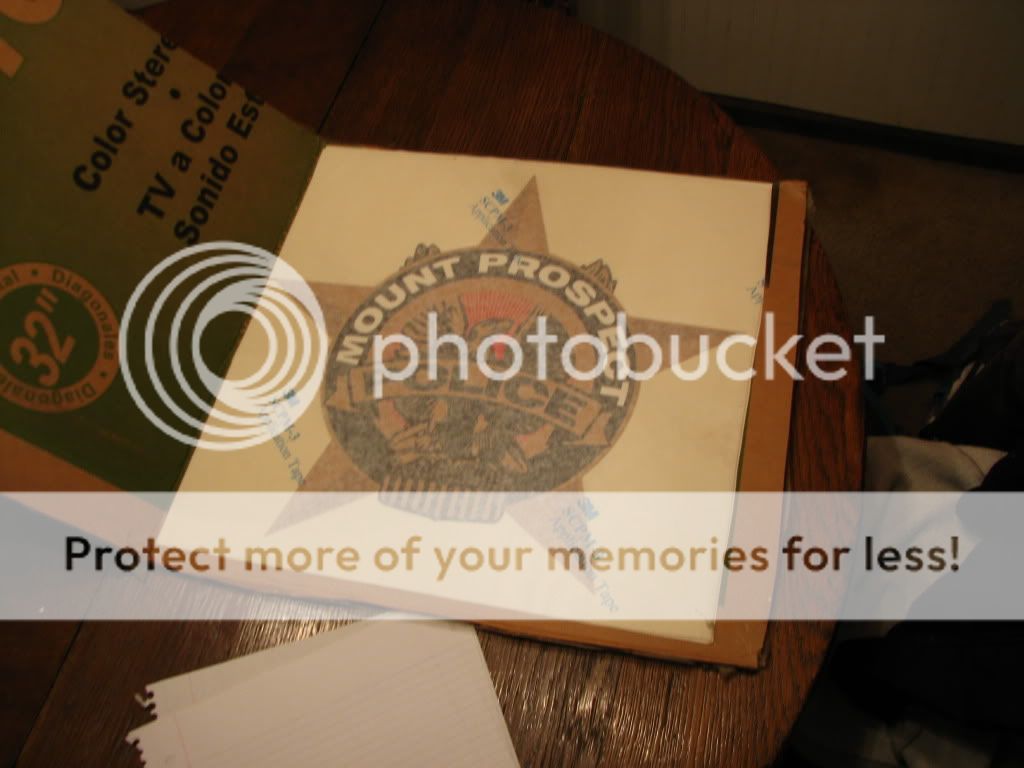

A guy on another forum years ago had a sign shop remake the door star graphics from an original piece. I got a set off of him.

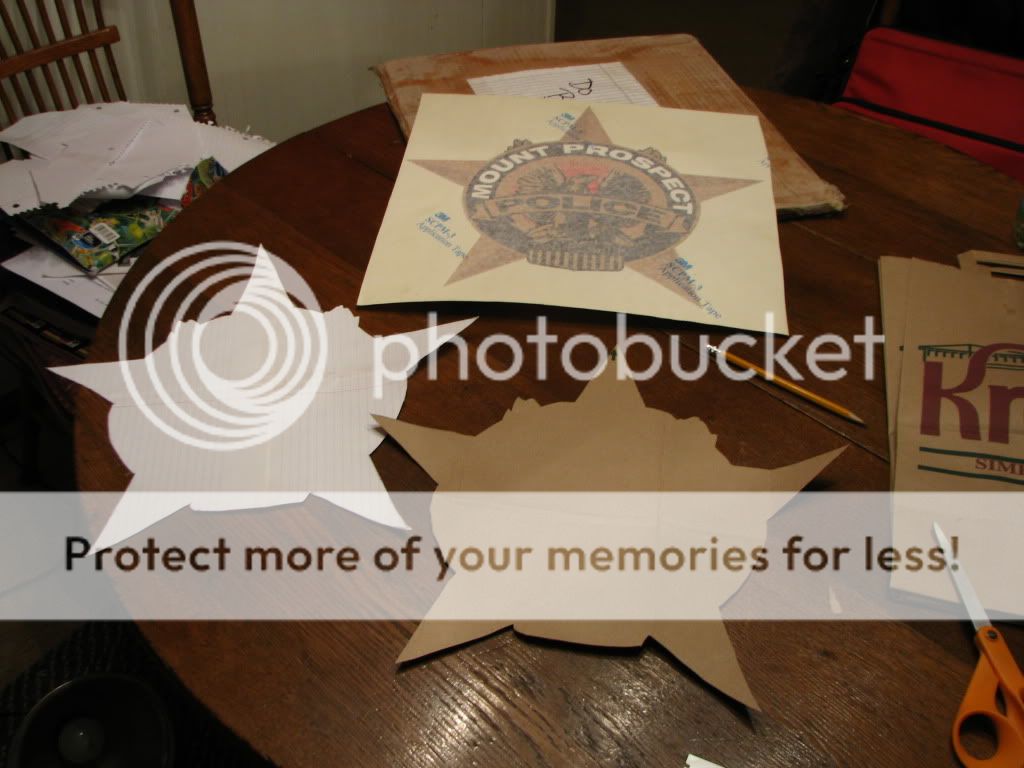

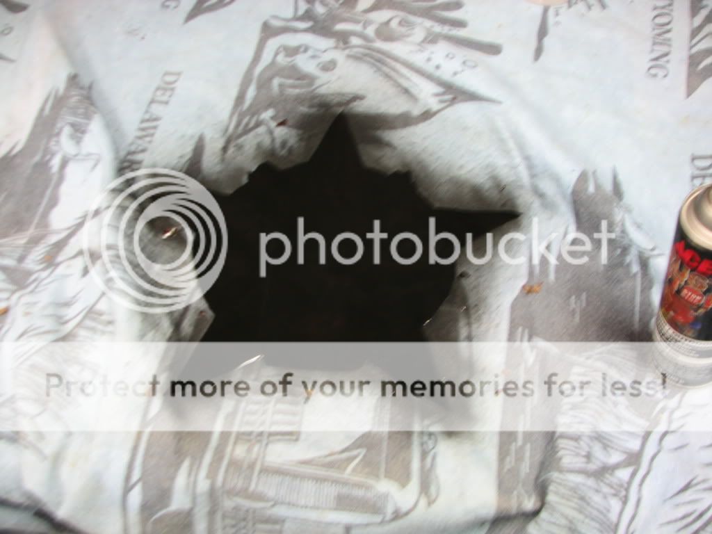

Now I didnt want to use these nice pieces on the car, so I traced the star onto some paper. Then traced the paper star onto another paper grocery shopping bag, and cut it out. I then took the cut out star, sprayed it with some wd-40, paint, and then slapped it on the car. This was a trick I got from another ahemmmm blumo owner lol.
this is when the bluesmobile bug started to really set in. I started trying to get the car as close as possible to as seen on screen, with all the little stuff... and still am.

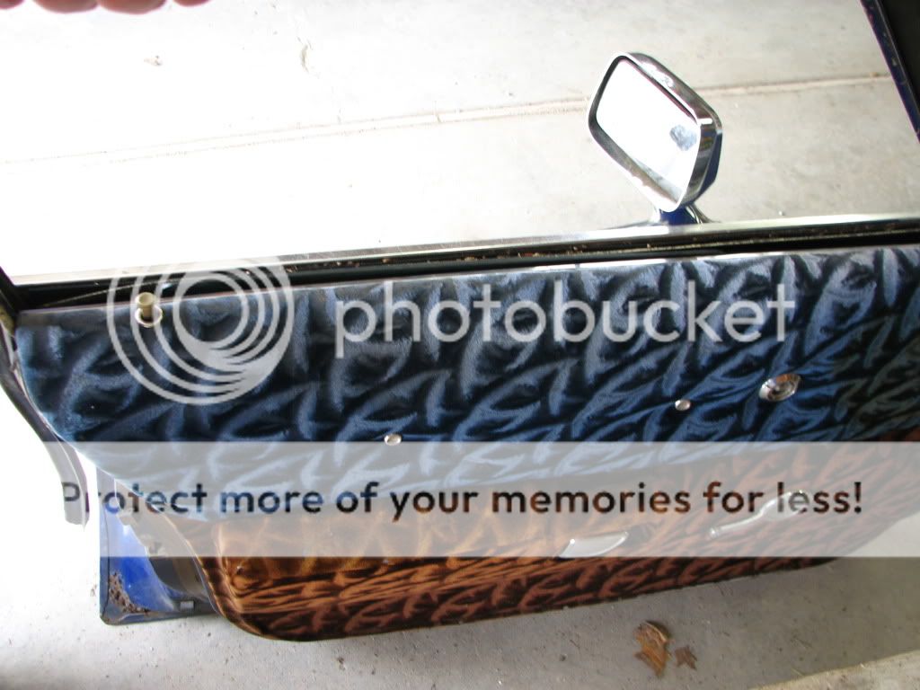

The trunk floor was completely gone, with wood/sheet metal glued, and riveted into spots. Bondo everywhere. The guy was pissed! He got another car, and grabbed parts from this one, and sold what he could. I grabbed the drivers door, wich had a tiny bit of rust, but seemed straight otherwise.
Ive got the door panels if you would like to rekindle you college days... lol
After the star I started messing with the front fender graphics "to serve and protect". I went through quite a few trial and error runs with different size fonts. I typed the phrase out on microsoft word, and printed it out. I then taped the papers together forming the phrase and cut the letters out. taped them to the fenders, and painted them solid white. After they dried, I sanded them down.
After some talking with guys on the bluesmobile forum I ended up as close as I could get with the lettering later down the road. They are 1 1/2 in lettering, and 24/or 29 inches long (its been a while, cant remember for sure).

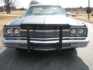

Once they were done, I added the red primer spot to the front drivers side lower fender, along with some cheapo front pushbar a freind and I welded together.
Threw some new tires on her, and off cruising!
The "to serve and protect" above is not the final stencil used. Thie was one of my own first tries that didnt look to good.

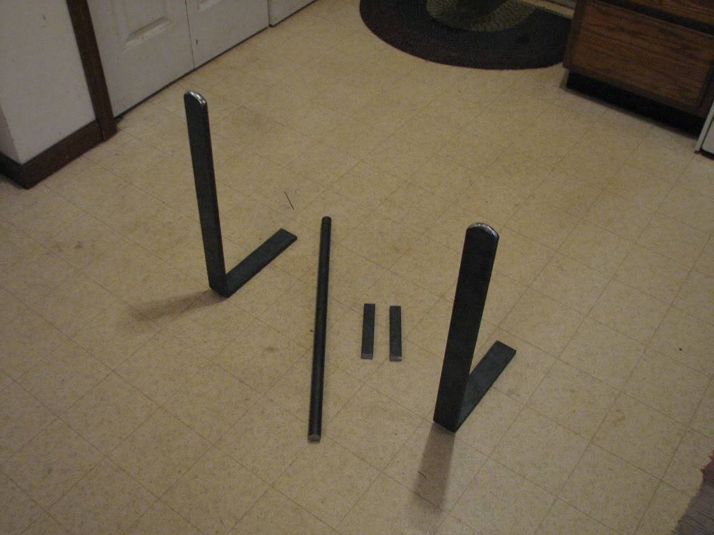

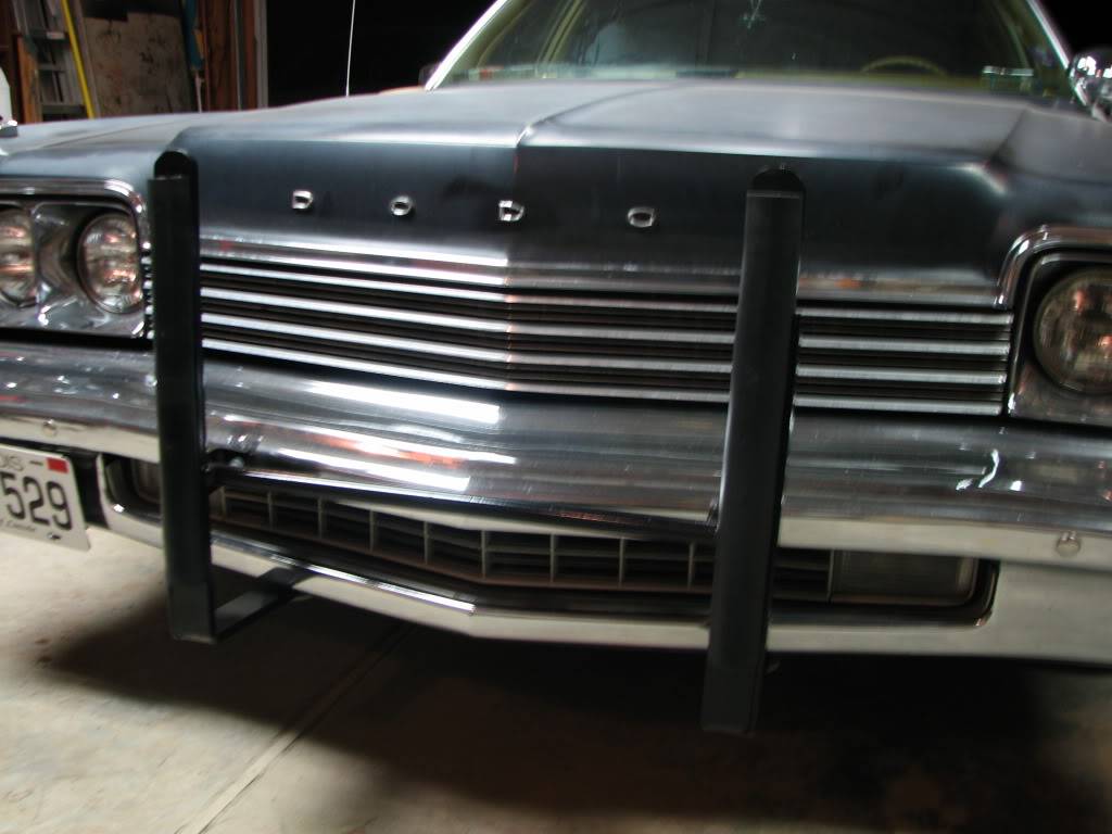

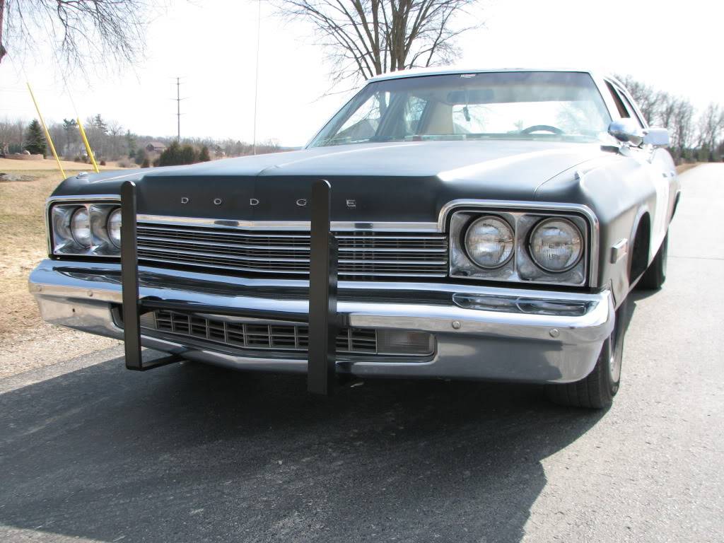

After a few months time made up a new pushbar. Had a metal shop cut, and bend up the 3/4 in stock, and also had them cut the center support bar.
Took it to my mechanic, and had him weld it all together. The side pieces are made from the old pushbars
Last summer, I was able to score a set of original NOS CHP pushbar rubber's, from a friend on another forum. These were the icing on the cake! I felt a little bad putting them on this car.. But I love em!
