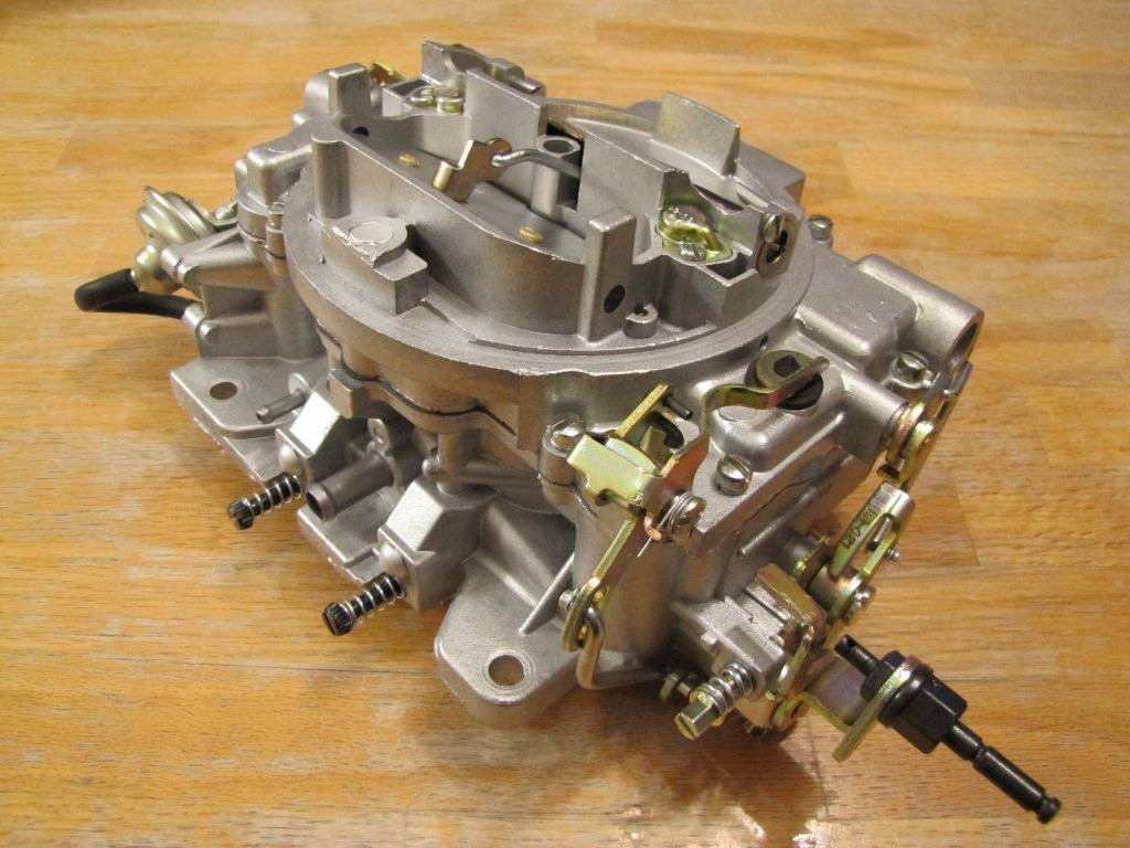

I have a rebuild Carter sitting in the trunk waiting to go on as a backup plan. Last one on the shelf at NAPA across the country they told me. Still in the autoline box wrapped in plastic.

Whoa whoa... before we go condemning a carb that was supposedly rebuilt twice, I think you need to look further upstream.
Look in the carb's fuel bowls... full of sediment? If you don't want to open the carb, how is the fuel filter?
Could you have a fuel sock (in tank) clogged with crap the plugs up while the pump is pulling hard (high rpm), then with a lower load (coast) can't pull through the garbage? Then the engine stops, junk falls off the tank sock, and it will restart?

Very good advice here. Since I drove the car home, I've had no opportunity - as yet - to get into it. Was away for the last week, and Memorial Day is coming up with a raft load of commitments to handle. Hoping to get a look at it next Monday.
The car sat in an old chicken coop for many years. The PO went through the fuel system, rebuilt the carb and the transmission and put new tires on it. The gas guage doesn't work, so you may be right about the sock.
