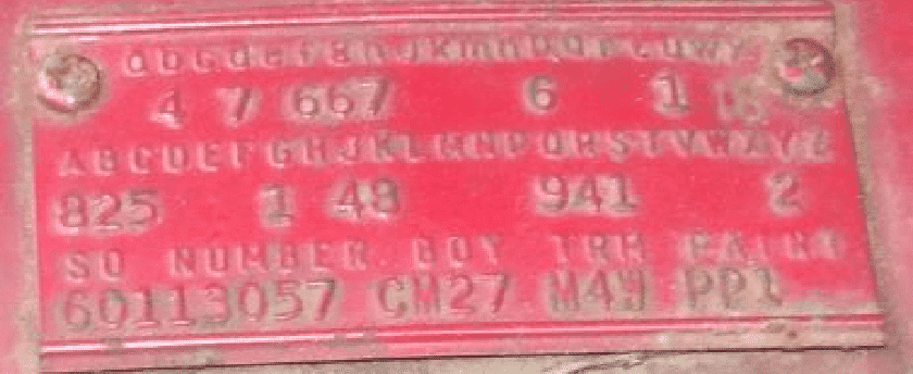

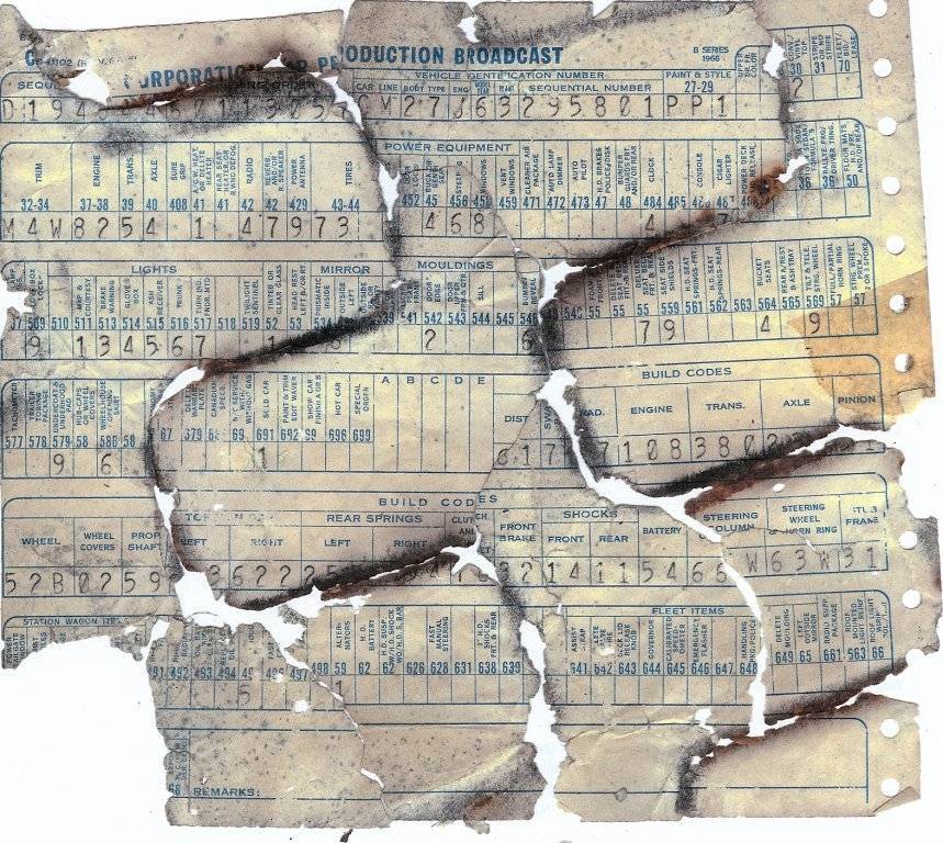

Mike: I haven't decoded the build plate and build sheet yet to determine the build date, but here they are. Maybe someone with nothing to do can decode them for me. Stan ?
Here's what I get
1966
Production date June 01, 1966
Shipping order 13057
Car line CHRYSLER Newport/300/NYkr
Price class Medium
Body type convertible
Trim Grade Medium [32M]
Seat type Bench vinyl [334]
Trim color White and black [34W]
Paint 1 Bright red [27P]
Paint 2 Bright red [28P]
Paint scheme Mono tone paint [291]
Upper door frame paint Black
Engine 440 4bbl 8cyl 365hp dual exhst RB [378/382]
Transmission Transmission-Torqueflite automatic [395]
26in radiator yoke
Power equipment Power bucket-LH 6way [454]
Power equipment Power windows [458]
Power equipment Power vent windows [459]
Radio Radio-AM search tune [424]
Heater Air conditioning w/ heater [411]
Front bucket seats Bucket seats [564]
Rear options Heater-rear seat and defroster [417]
-OR- Speaker-reat seat w/reverb [427]
Police accessories Heater-DELETE [416]
-OR- Speaker-reat seat [426]
Mouldings Mirror-outside LH remote [536]
-OR- Moulding-bumper reveal [546]
Fender mounted turn signals Light-turn indicator hood/fender mounted [517]
Mirrors Mirror-outside LH remote [536]
Vehicle sales/delivery Spotlight-LH 5in pillar mounted [671]
-OR- Oversize manual antenna [681]
-OR- Sold car/expedite [691]

Thank you, Doba. Thank you! I guess my car is a fairly late build (June 1966). Thanks again. Very helpful.
