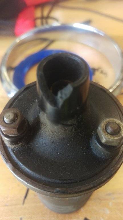

Today it got a new coil. stopped by the local restaurant/museum/speed shop and picked up a flamethrower. we'll see how it does tomorrow as far as cold starts go.

I dug the flamethrower in my 68. I had the Pertronix Ignitor I with the flamethrower coil on both my 318 and my 440 and they both ran really strong.
So far the coil seems to be ok. Starts a little better. Burns a hell of a lot cleaner. The smell of the exhaust between the two coils is night and day.

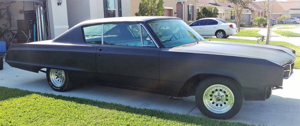

ANYWAY.. We're legal to be on the road again. First time it's been titled, plated and insured to be on the road since '95. It's been on the road since then for two short trips (an 11 and 7 mile), but not "legally". So now I get to see what's really going to break and what needs fixed. Currently waiting on another gallon of primer and transmission rebuild kit. Thinking I may as well replace the torque convertor as well. We'll see how things pan out.
Also have to find someone that can replace this windshield with the one I picked up a few years ago. Either that or I gotta grow the cojones to do it meself.
Welp since we're offically legal... test drive. First legal road trip in near twenty years. I only got the first to second shift. and she popped a little coming off the side of the road going back on the blacktop. Other than that no issues. I have to figure out the cowl to hood fitment, it drives me up a wall. passenger side bolt and screw holes line up. drivers side ir about 1/2 above the screw holes to get it where it is. I have to assume either the hood is tweeked or the firewall. It's the one part of this I've dreaded because I don't know how to fix it and not have some part of it be out of alignment. anyway...the vid. Super short. but fun as hell to be back on the road with it for however short it is.
