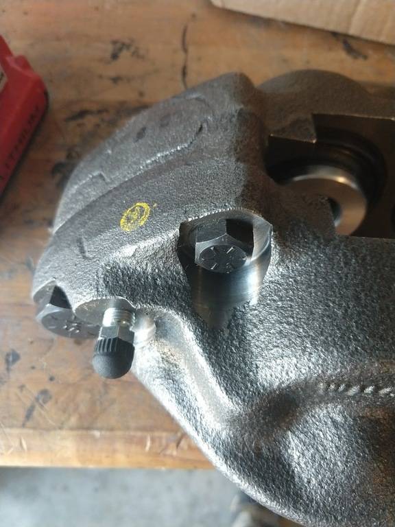

New caliper arrived today. I'll be damned if it doesn't look just like the last one where half the piston boot isn't completely seated. Cardone for those with inquiring minds.
I'll be out tomorrow to try and seat the boot, if not back to RA it goes. Oddly it's on the same exact piston in the same spot. They either have process or QA problem. Wait, obviously it's both.

The funny thing is, aside from the rubber being installed piss poor, the unit itself seems to be really well machined. You can tell they machined certain parts simply for clean up probably for pitting etc and those areas look great. No chatter marks, no mis-alignments, nada.

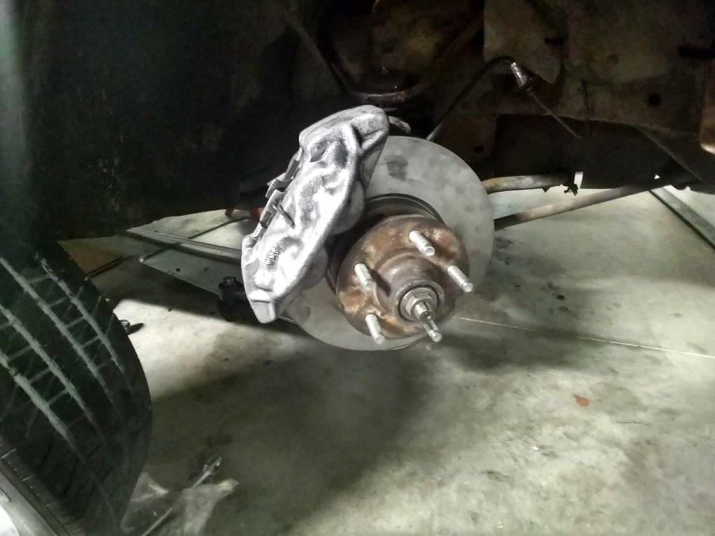

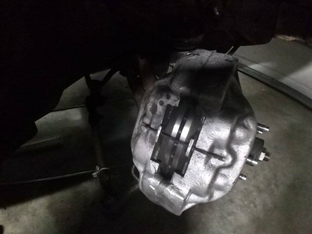

So the brake issue seems to have calmed down a bit. I still have decent brakes but not what I call outstanding. Perhaps no better nor worse than what they were before the pistons stuck in the old calipers.

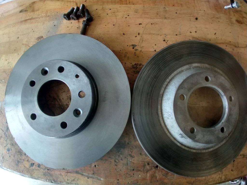

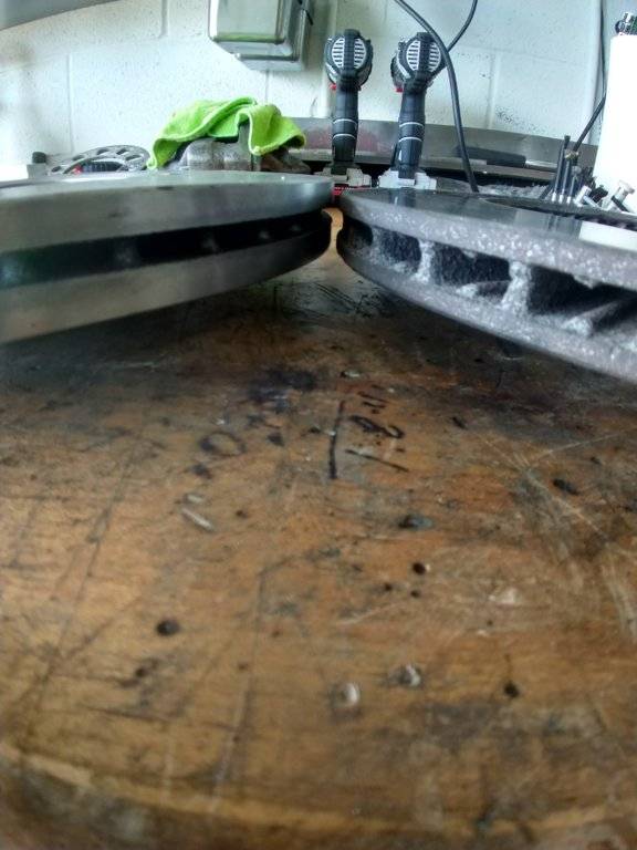

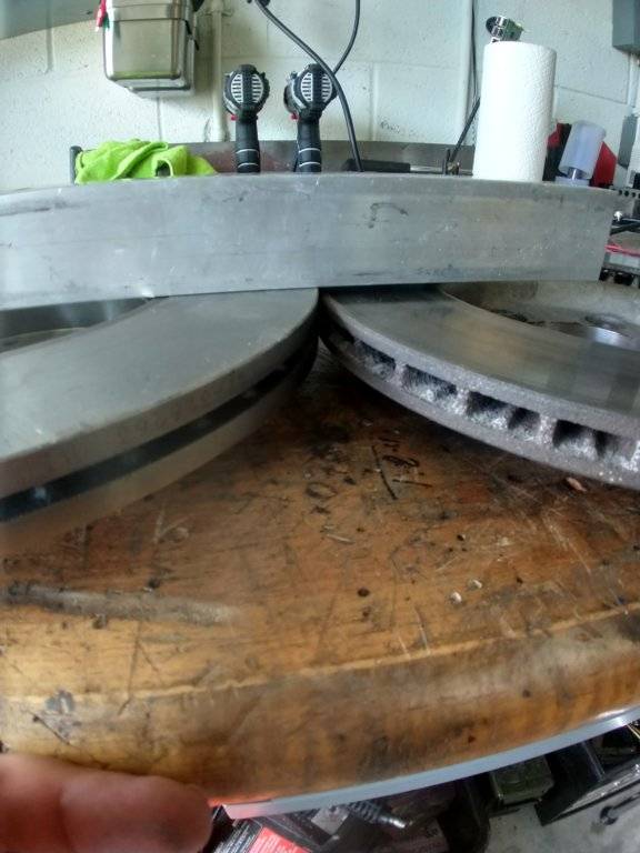

Have to open the center bore to 3.24-3.25", the backside has to be opened up to about 6.5". Once it's taken to minimum thickness for the car it's supposed to be on, there's only .162" difference between the new and old rotor to deal with. If you have someone willing to cut the rotor down to what the original Budd Rotor width is, you only have to adjust the caliper .090" to the inside towards the engine bay. That's either on the hub hat where the rotor mounts or from the caliper mounts.
Found it by accident. Best part is the rotors are only $27 Raybestos. $16 for the discount DuraGo's.
Lincoln MKZ.
I would pass, if I was asked to do this professionally... but I do see a lot of meat available for what you want to do.
I know this may seem a bit off, but you might get some of your clearance by grinding the face of the new pads as well. Back when we used to sand brake pads, a piece of 80 grit or a clean rough sidewalk would remove a little material pretty fast. Before it was unpopular to produce any brake lining dust (and once in a while after), we'd sand a chamfer at the leading and trailing edges of some new pads to help with noise issues. Some new pads already have it.
