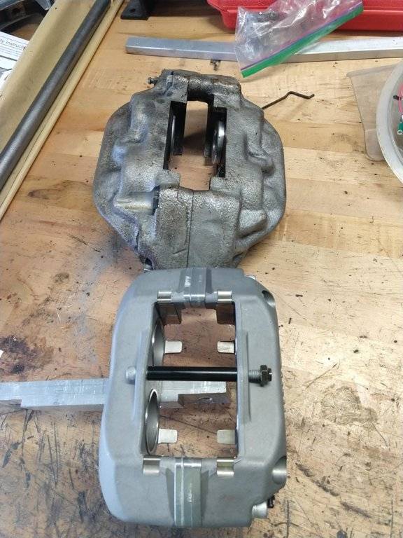

took the originals apart in hopes of potentially rebuilding them. One piston in each side are frozen. Attempted to plug the holes and use air pressure to push them out. Ran the pressure up to 80PSI before I ran out of cajones. I didn't need a missile shooting across the garage.
The bores of the ones I did manage to get out are rusted pretty bad.
Smart move. If you want to rebuild your original calipers, I would soak them in a good rust removal solution for at least a couple of days. If I remember right, those are metal pistons in the calipers, and they WILL take off like a bullet under a lot of air pressure. After you get the old ones out, you will need to clean the piston bores, here is where you will have the problem, if the bores are real pitted you may need to have them machined and sleeved, there are shops that can do this, but it is pricey. The good news is once done by a good shop, they will last forever, not like the junk rebuilds you get from China. Good luck.

So I sit and wait for brake line kit. A week. Why with 2 day shipping and 10 instock does it take a week? Good note though the brackets I made put the calipers exactly where I want them on the rotor.

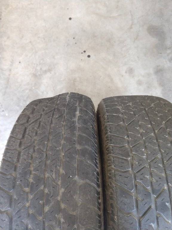

Noticed a wobble on the first shake down around the block. Found a big bubble in the tread of one of the rear tires. So it'll sit for a little while longer before I can bed the brakes and see how it really does. But at least it's mobile again.

Actually, I'm good with it. It's had a wobble for a little while and I assumed it was because of the front brakes. Perhaps having everything replaced made it more noticeable to me? But having everything new lead me to look else where and that's when I saw the bubble. Or maybe it's just getting bigger from sitting. but it felt like the car was wagging like multiple inches side to side in the rear. Too much weight on one tire while I worked on it? Maybe a flat spot plus the bubble? How many licks to the center of a tootsie roll tootsie pop? The world may never know.

On a side note the Cardone calipers are being flushed clean and either getting buried somewhere or going to end up in the bottom of a swamp.

Either Wilwoods stop odd or the pads just aren't bedded yet. They initially dive but require a little more effort to bind up. Get em hot and whewee they grab right at slightest pedal movement. So Forged Dynalite Narrows (120-15254) really do have the power to stop these barges.
Though to be honest they're doing most of the work because I de-adjusted the rears. In a panic stop stab they locked up. Until I get smaller diameter wheel cylinders I prefer to not have that happen again.

Here the bubble is on the bottom, you can see the wave it created in the opposite side sidewall pulling the section narrower.
