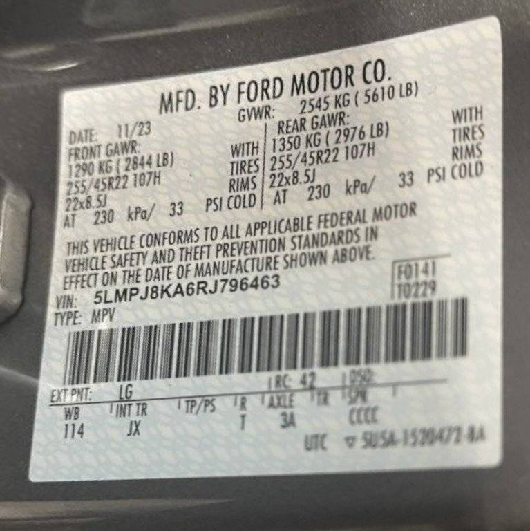

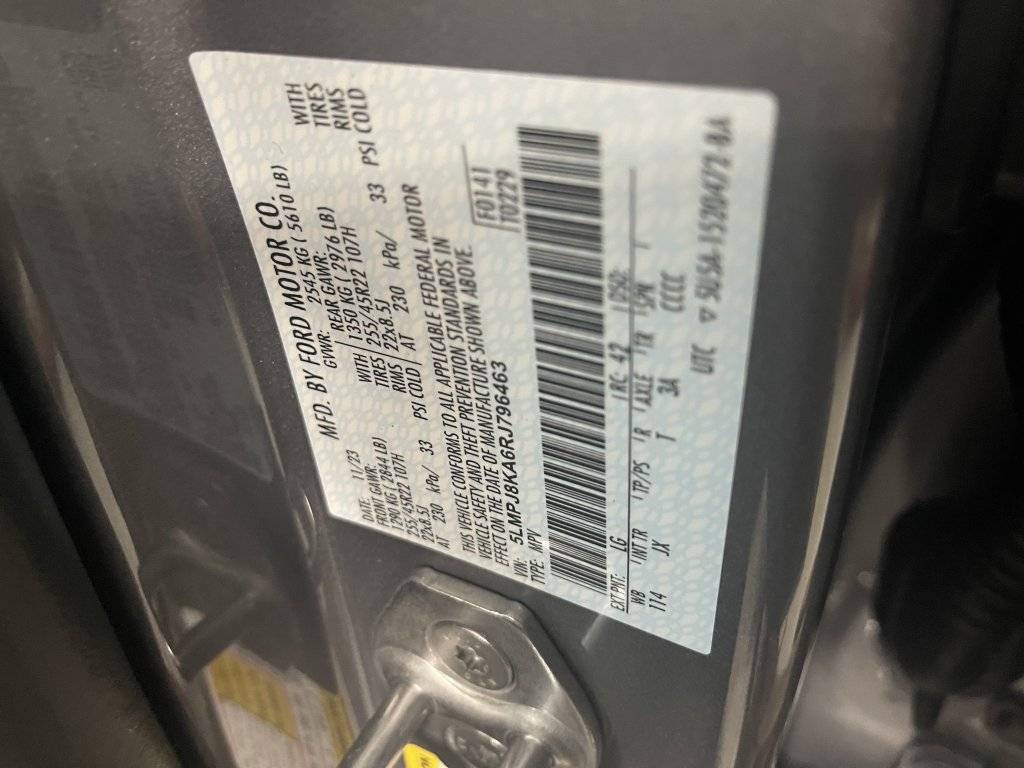

Sidewall pressure is the pressure required for the tire to carry its maximum rated load, not the recommended pressure which is specific to each model. That said, most of the pressures given in the manuals for these vehicles would be for bias ply tires. Radials are likely different. I start with 32 PSI in the 225/75R15's on my car and adjust pressure according to how they wear. The only time I have ever used sidewall pressure is on trailers and the rears of my truck when towing a 5th wheel. 80 PSI in the rears of an empty 1T is not very comfortable.
