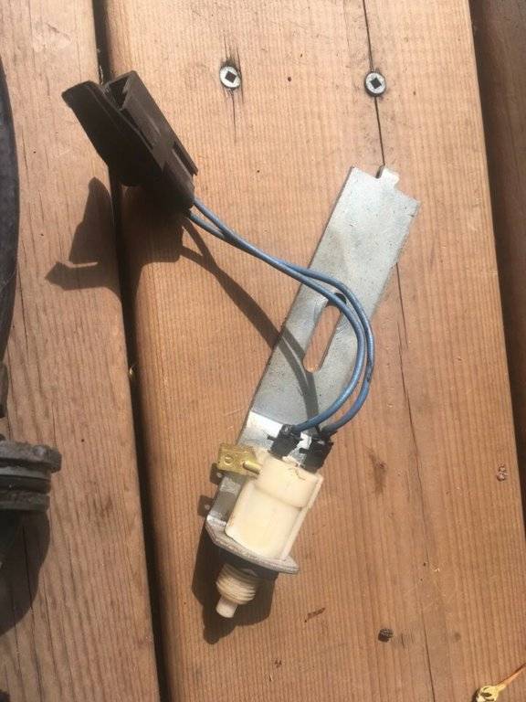

-may need a different stop light switch with a plug/fitting for the cruise cut out circuit.

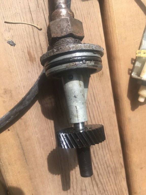

Two speedo cables (can be from about any mopar)...
Four prong brake switch..

The last generation cruise control is the best set up and can be added to the older gen cars but that takes attention to detail and i am not obligated to share that info. Any 70 and up car will readily bolt in cruise control. Look in the book! The cruise harness is the key item. Cruise part numbers etc are in the fuel section of the parts book. The cable length from the servo to the speedo varies but a longer cable can be substituted no problem. The cable from the trans to the servo was one length for a long time. Check the parts book for the c bodies as i think the cable was longer. Cruise parts can be found on the parts locators and are typically inexpensive at the swap meets. Typically is the key word

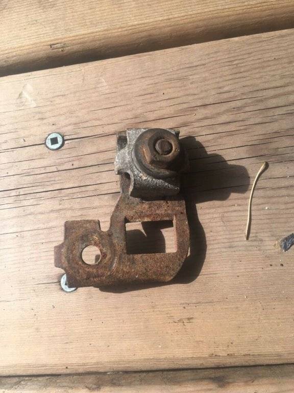

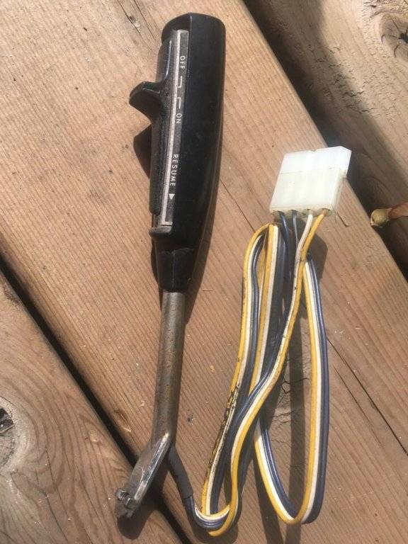

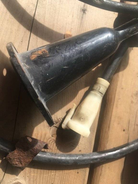

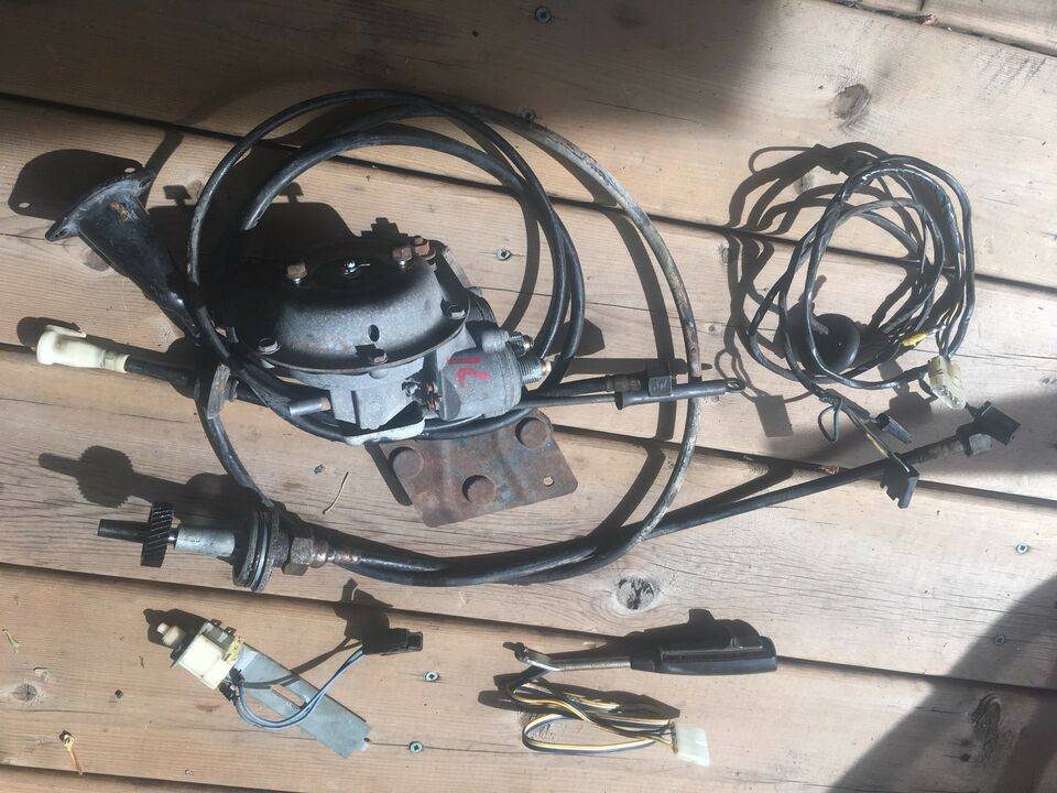

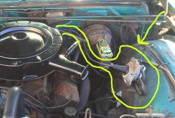

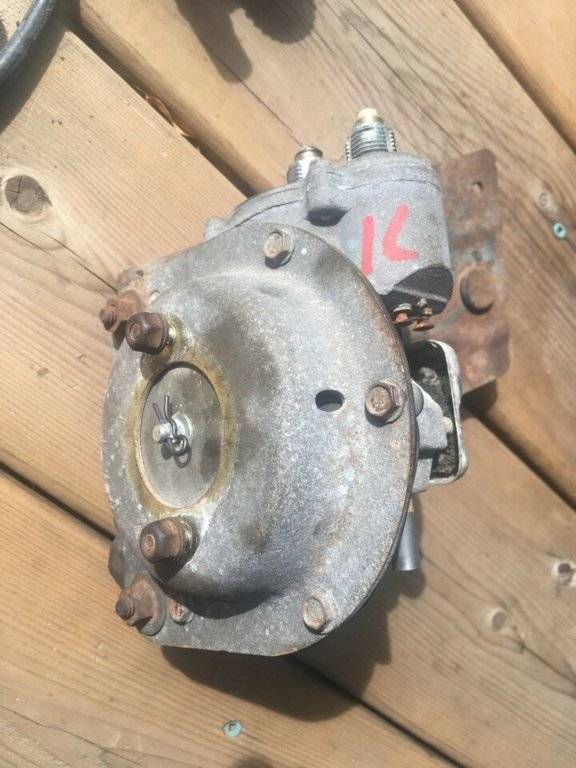

I have done a couple extractions & installations of factory cruise controls and it is pretty straight forward.
Here are the parts required:
<this setup is from a 76 Charger/Cordoba>

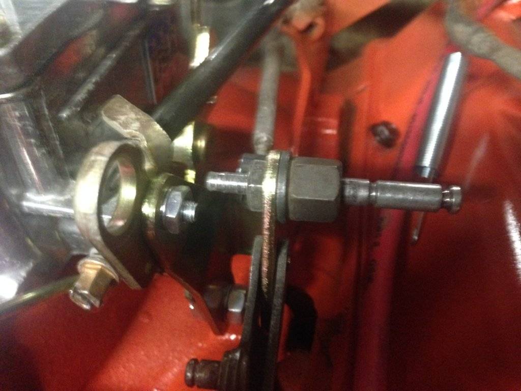

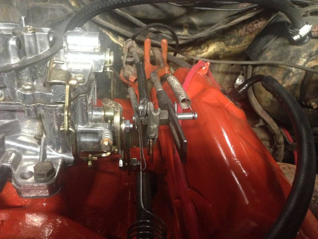

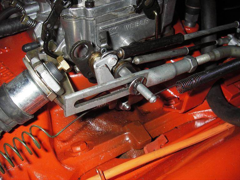

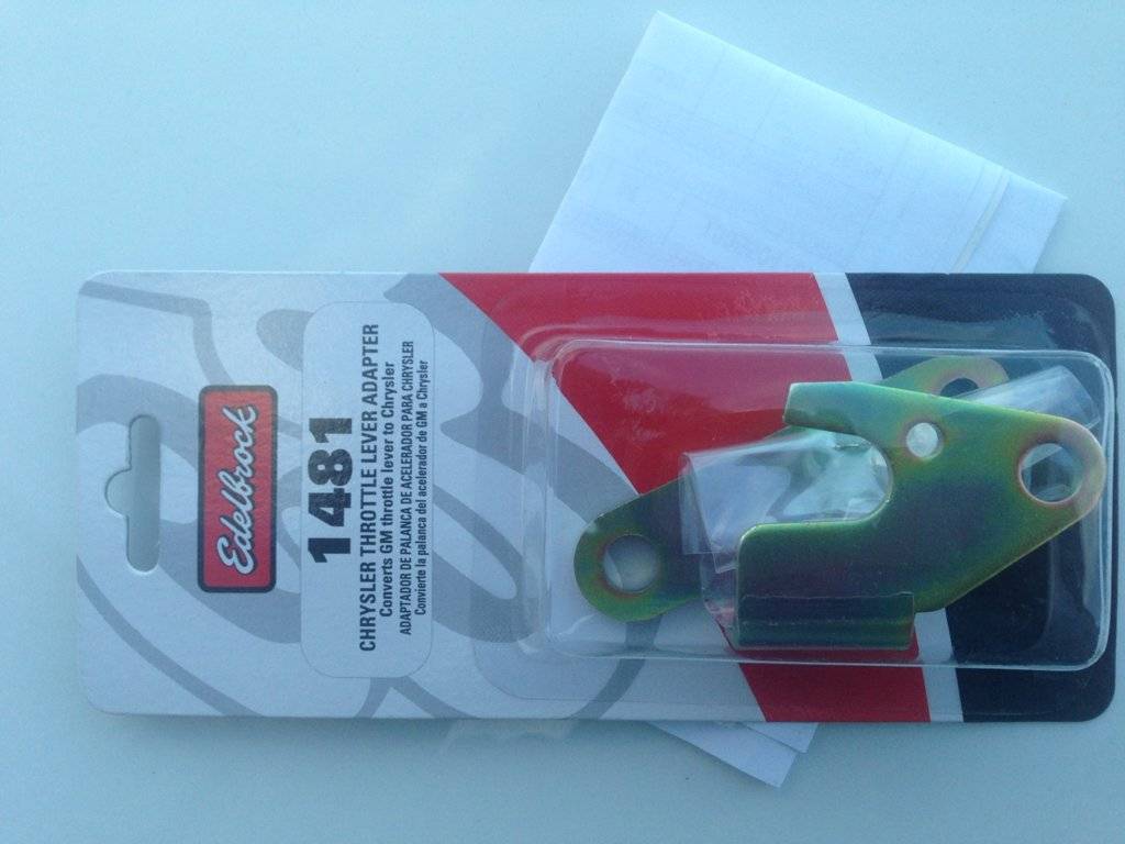

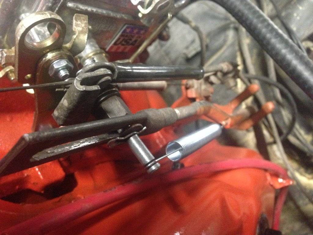

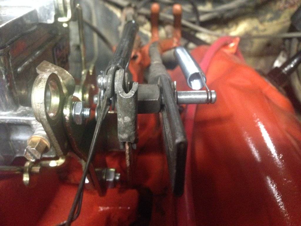

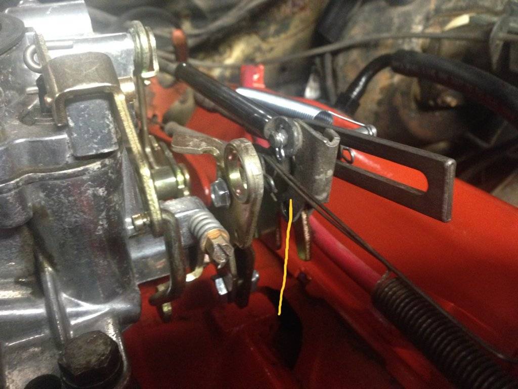

The first couple of pictures you found of the lost motion linkage are from my car, I took those pictures. They detail the Edelbrock adaptor needed when their modern carb is used on a Plymouth and how the lost motion linkage attaches to the adapter. I installed factory Cruise control from a 69 Chrysler about 25 years ago on my car. The older Chrysler AFB Carter carb Did not need this adaptor as it was already there from factory.
Right on! I also went to an Eddy and had to use that 1481 adapter however I have to modify (yet) the Eddy air cleaner base I have because the adapter with the 'lost motion linkage' interferes.

Just saw this old thread, hope you made out okay, It's super easy. I did the same, took a complete cruise setup from a 76 Cordoba and installed in my 73 Charger, worked like a charm, VERY nice detailed pics from the posters. As you can see there are many small parts invovled, especially the carb linkage.
