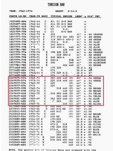

Does anyone have a list of the sizes of T bars vs application? I'm assuming that they would be '71-'73 and '69-'70? I got a set of T bars out of a '73 400 Fury and they are smaller then those in my '69 318 car. I haven't measured them against my '73 yet though.

The 400 car ones are 575L and 574R
All you need to know, Nick, is that there are three factory T-Bars for C-bodies.
.94", .96", and .96" in diameter. Just check which of the two lengths you want.
Hey commando1, if a Plymouth has a 318, it will have.98, a 383 will have .94. .98 being stiffer, so .98's with a 383 will have a slightly "stiffer" feel over choppy roads? Am I reading this right?
Thanks Commando1, good consolidated info. So for Plymouth it breaks down this way.
Standard on all station wagons and 383 cars are the .94 Torsion Bars (Light) 2269 574-5
Standard on all 6 cylinder cars .96 Torsion Bars (Medium) 2269 576-7
Standard on all 318, 440, Police, and Taxi’s and heavy duty and extreme suspension optioned cars .98 Torsion Bars (Heavy) 2269 578-9
