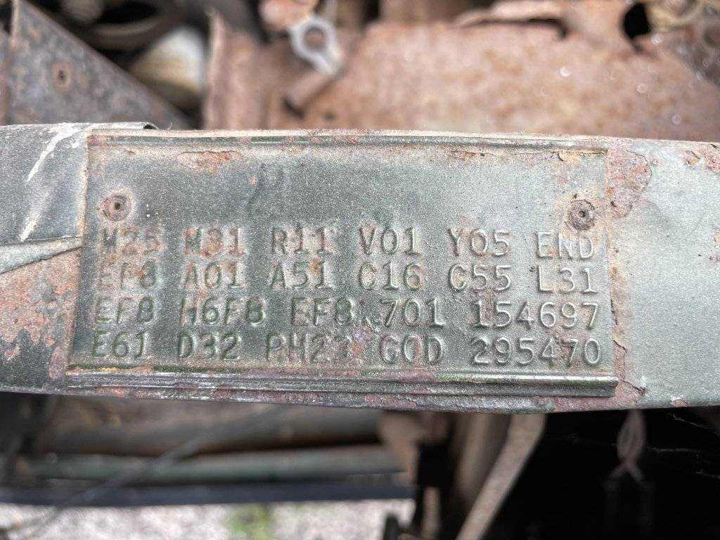

The recent 70 S23 I got back here's the Tag so has anyone ever seen a 70 car get a G for 318 in the vin. But stamped for E61 383 2bbl and when I get the broadcast sheets back it has the same thing. Bit the car is a 701 scheduled build date which is late for someone to mess up and put a G for a 69 car. I'm just curious if someone has ever seen anything like this before? By the way a 383 2bbl is in the car I haven't checked the motor or trans yet for number's.
And I'll add there must be some REASON for the 125 on all the Hursts, and we've discussed it here, But clearly there is no reason for the G and E61. Blatant error. I'd like to send this gem to Dave Wise for his opinion.

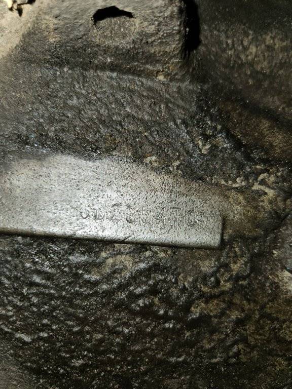

So today at least I was able to get under the car the motor and trans are numbers matching i was so glad to see 295470. But someone still stamped the vin and fender tag with a G for some reason.
the "G" in the VIN and E61 is a misprint.

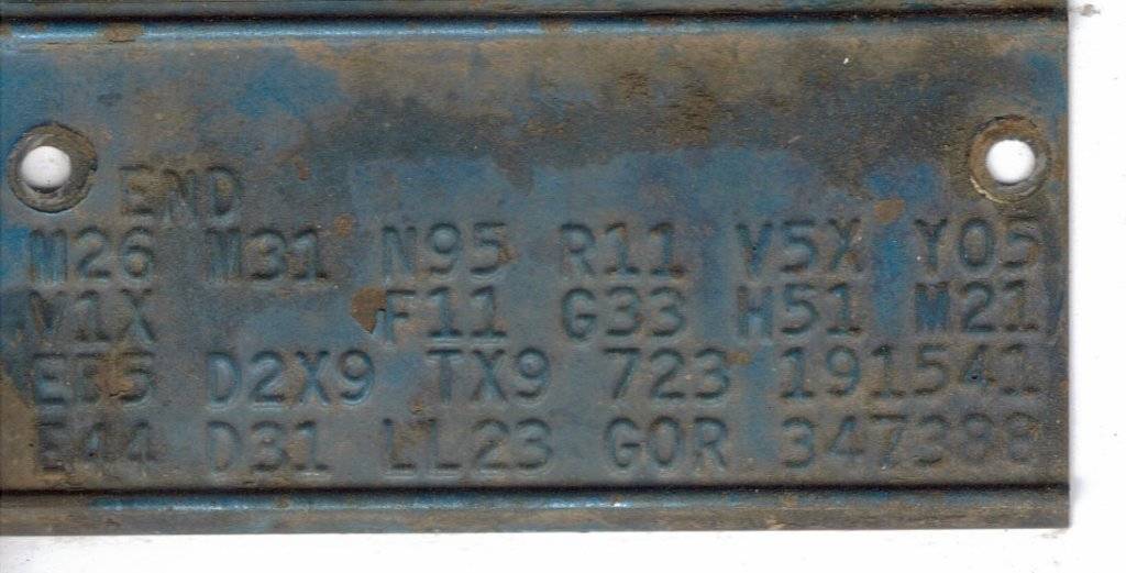

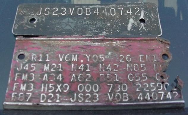

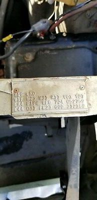

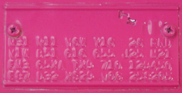

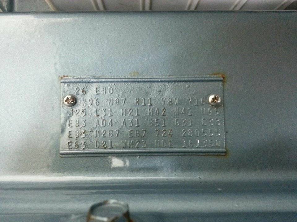

So lets look at the other plants and what they did in the 1970 model year:
in St. Louis you have SPD 710 as the latest stamped on the tag with highest VINs in the "258xxx" range
In Hamtramck you have SPD 730 as the latest stamped on the tag with highest VINs in the "443xxx" range

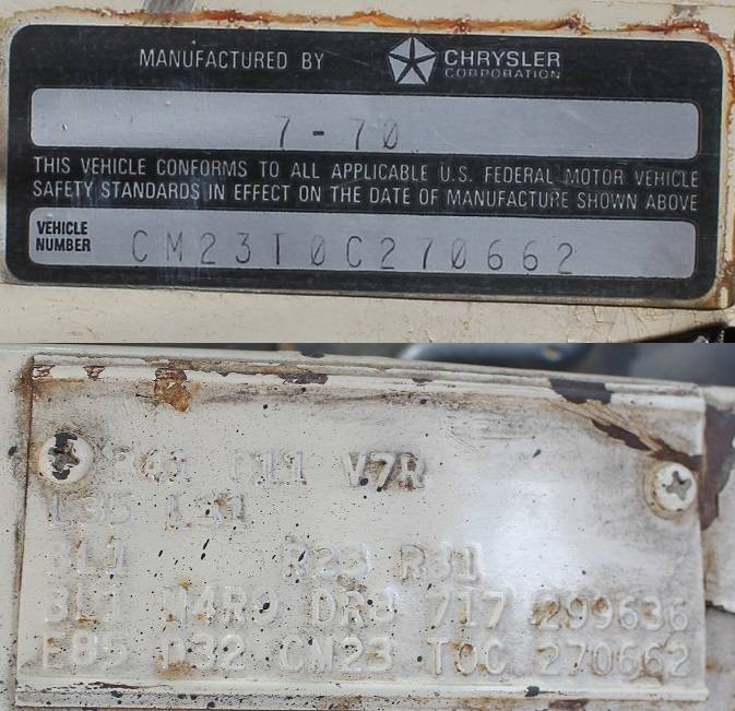

In Jefferson it is SPD 717 as the latest stamped with the highest VINs in the "270xxx" range

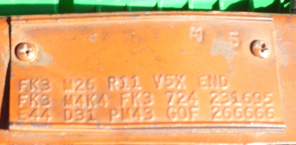

In the Belvidere plant it is SPD 724 as the latest with highest VINs in the "312xxx" range
In the Lynch road plant it is SPD 710 with a "245xxx" VIN (but I have higher VINs in the 245 range that have SPDs of 702 and 703 !)
In Los Angeles the highest SPDs are 724 with VINs in the "161xxx" range

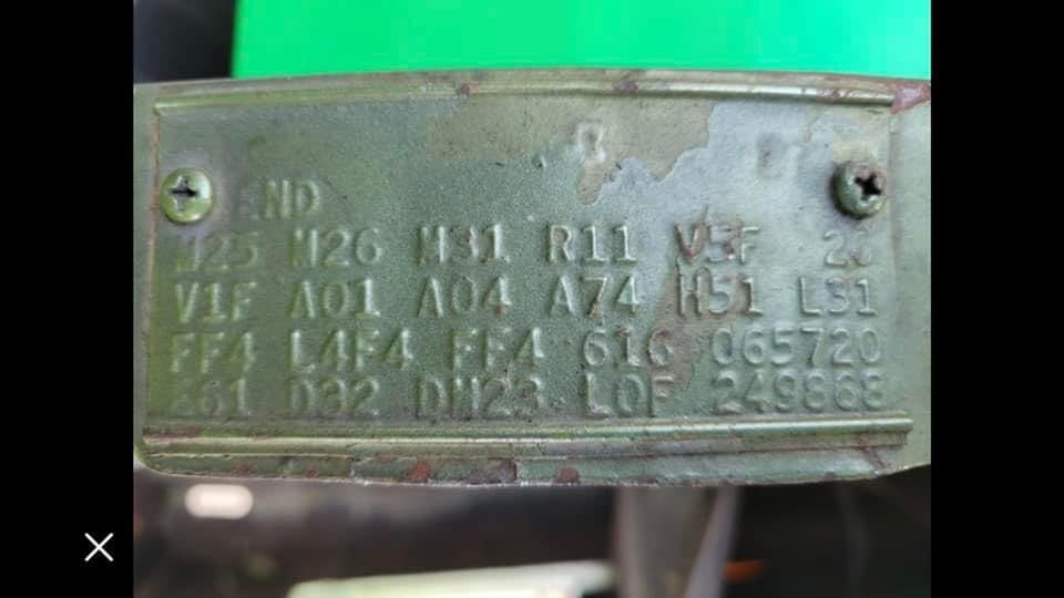

The Newark assembly plant is my soft spot. I do not have enough tags. Highest SPD is 616 with a VIN of "249xxx" but there will be lots more.

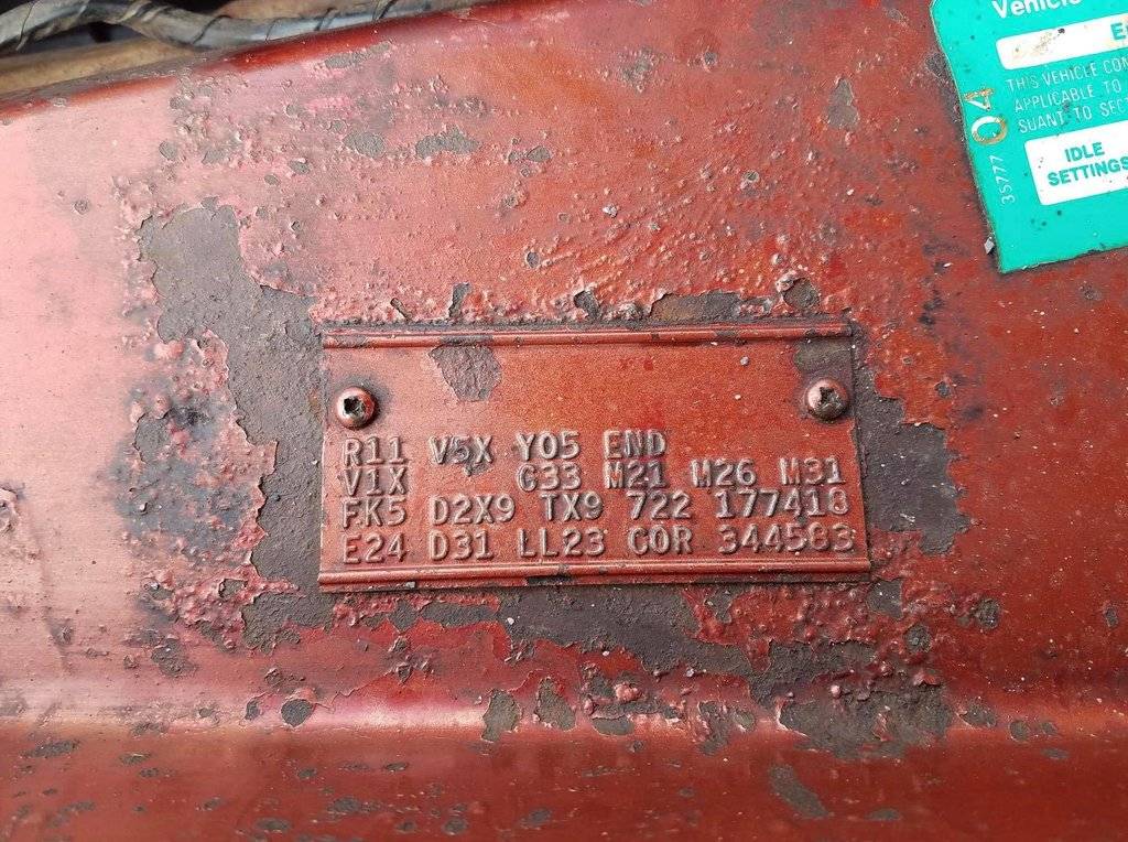

The windsor plant is also a soft spot. I have SPD 722 with a VIN of "344xxx" but there might be more
Every plant had there tags stamped differently. But the Hamtramck tag tells you that a few cars were probably buillt right till the end of the month. In every plant independend from what the SPD says

@70 Sport Suburban -- thank you for posting the tag of PH23G0D295470
Interesting typo, given that G was the code for the 383-2 in 1969.
I think that was the point of the original post. If it was a very early car it would have made sense, almost.
The "G" is the typo.
E61 D32 is correct for 1970
E44 D31 would be correct for a 318 (see post #12)

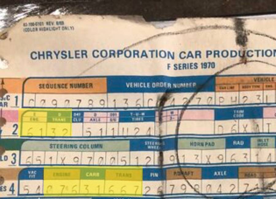

I'm waiting to get the broadcast sheets back I'm positive it's the same on that also. The dash vin reads G also on this car so they messed up on all 3 pieces.
