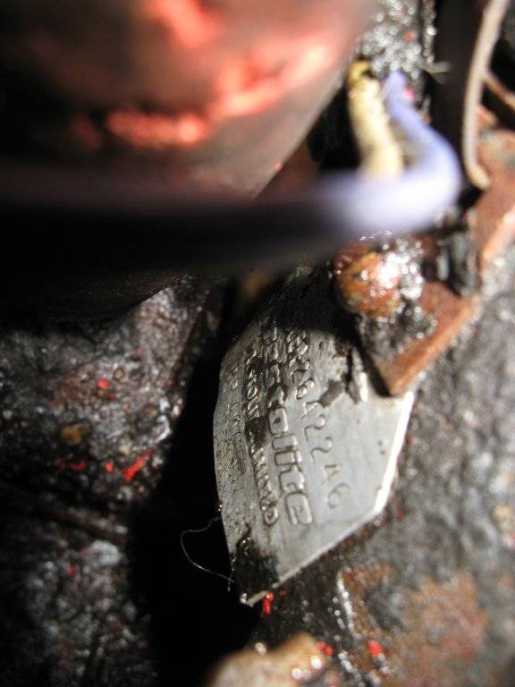

Trying to identify 383 2bbl at distributor 2642246

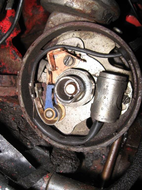

I need a vacuum advance and probably points.

I think its a IBP and those are Prestolite IBP2040LA Standard AL5486P points maybe?
The tag does say IBP-4005H also
I have most of them. I have to cross reference the prestolight numbers. I wish I had some Canadian catalouges.

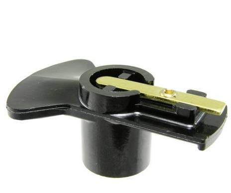

I am trying to figure out what pertronix I need. 1381A or 1385ls
The 1381a has a spring tab on the rotor and mine is a flat blade

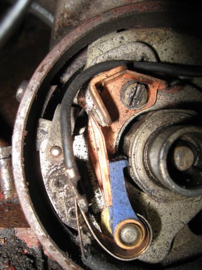

I think for now I will file these pionts and set the gap .017"
Its not going anywhere for a few months anyway
If that is your rotor then your cap should have a spring loaded carbon cylinder in the center position to press against rotor.
yes it does
which I realize the cap and rotor I bought several months ago wont fit:(
1381 is for the single point aluminum housing for sure. I have done dozens of them in the Pet I version. Never had one fail. Yes leaving the key on and not running will burn out all the mopar eletronic ECU's for sure. I have to remember to grab my Petronix book and look up your number. PM me all the tag info if you can. As for a cap you need the dual point style along with the rotor. If needed I have really nice NORS ones listed.
