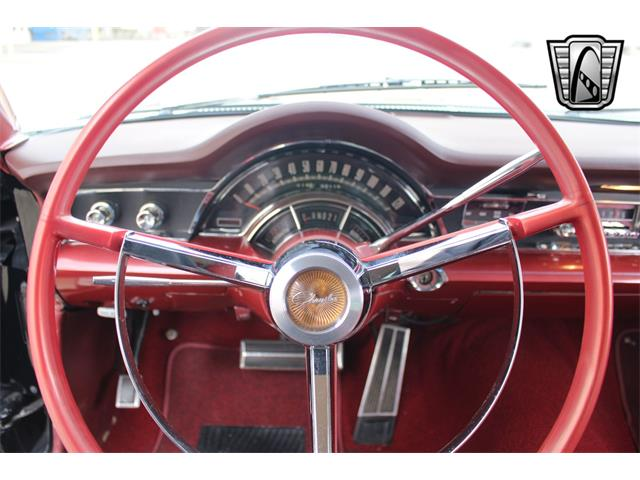

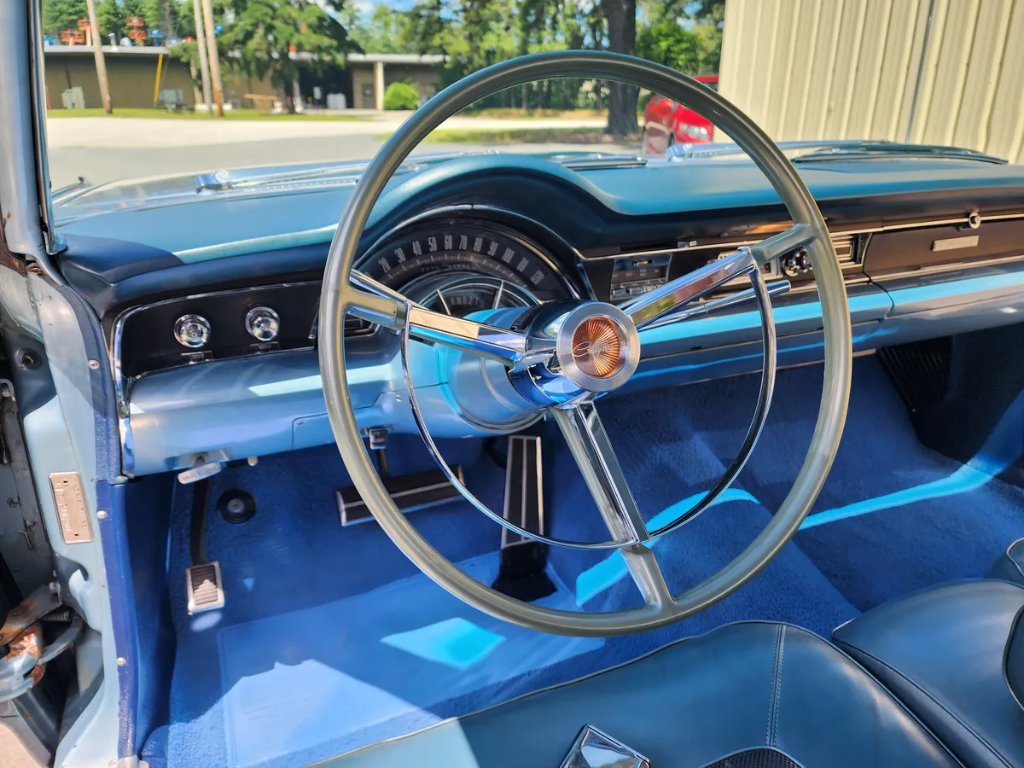

Just got this 65 Newport. Restored ~20 years ago, 86K original (verified). 383 2bl, no AC. I used to have a 65 Sport Fury, sold it many years ago, now this one. I will have a bunch of questions for you experts. Love the 1965 Mopar styling. Anywhoo, the steering column seems to be twisted clockwise. Selector should I think point up about 45 degree in park, mine is closer to 90 degree, and hits my leg when in drive. Turn stalk should be 90, points up. What could be wrong here?
