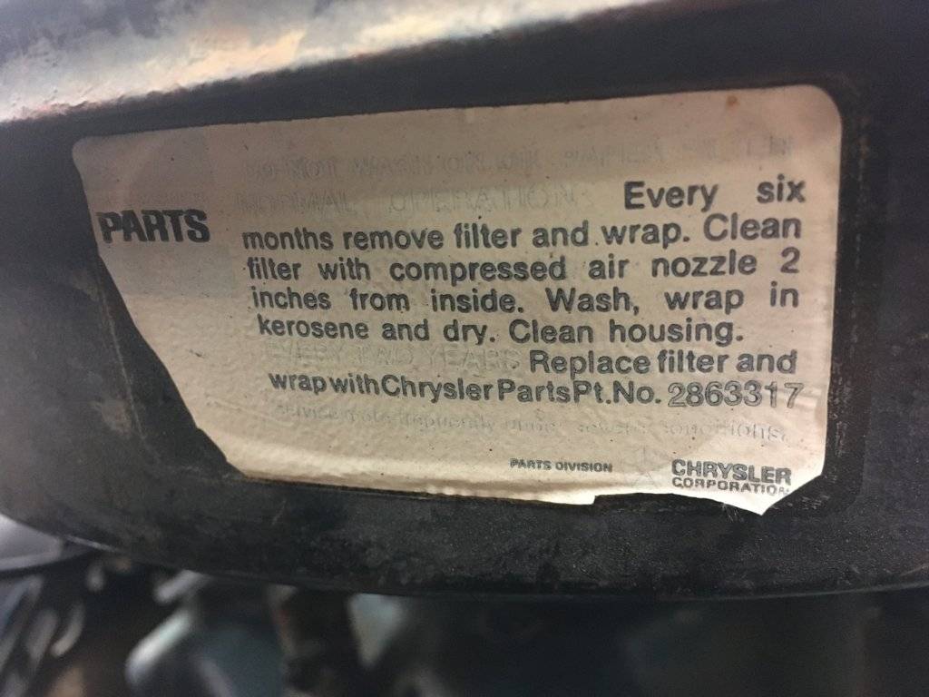

    An interesting item, for sure, with a non-flap snorkel and the open slot directly beside it. The air filter element part number looks like a 1968 part number, but I believe that the filter elements with the foam wrapper would only be on a CA emissions vehicle. As the snorkel is a non-flap snorkel, it would have to fit on something that was exempt from emissions testing, as in a HD 3/4 ton or 1 ton vehicle. Probably '70-71 vintage small block? Yet the tag looks more like something from the middle 1970s or later.
    Just some thoughts,
    CBODY67

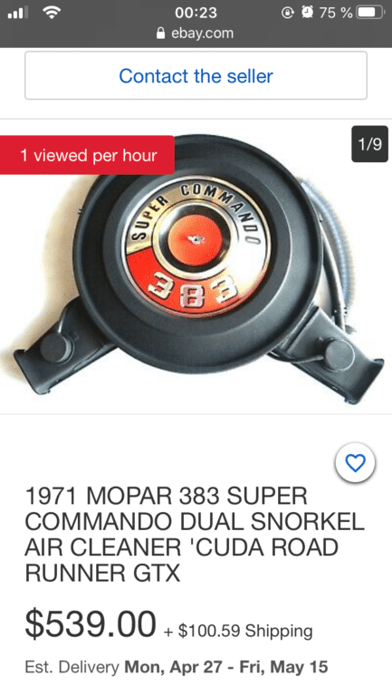

    Actually found this one on eBay .
    It says 383 super commando (and the seller names my car where it was original) but actually I am not sure if I have a 383 super commando?! Can anybody confirm that because I didn’t find a 100% writing that prooves it . Got a 71 Sport fury 383 HP 4BBL but never heard of it as super commando ?! But if it’s true....wow that would be cool !!! Somebody got the answer ?

    I think super commando was a Chrysler designation but that’s just a replaceable pie tin. The one on my N-code ‘71 Challenger says Magnum.

    Super Commando was Plymouth's version of a big block w/ 4 bbl carb. Commando V8 is what they called the big block 2bbl.

    Morning guys and thanks for the replies ! I am actually pretty happy that my engine is called super Commando even although I know it’s just words.... for me it counts to know . Now I just have to find a dual snorkel . If not I probably stick to the Mopar performance cleaner that’s fits to my valve covers but for now I want to find one . PH2717 your Link doesn’t work....

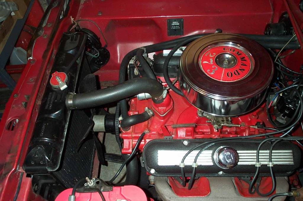

    The high performance engines were designated
    Plymouth -> Super Commando
    Chrysler -> TNT
    Dodge -> Magnum
    Just as the E87 option for the 440cui with 3 dual carburators was called
    Plymouth -> 6 bbl
    Dodge -> Six Pack
    not available on Chrysler models
    • Thanks! Thanks! x 1

    The 273 HP also got the Commando and Super Commando designations.

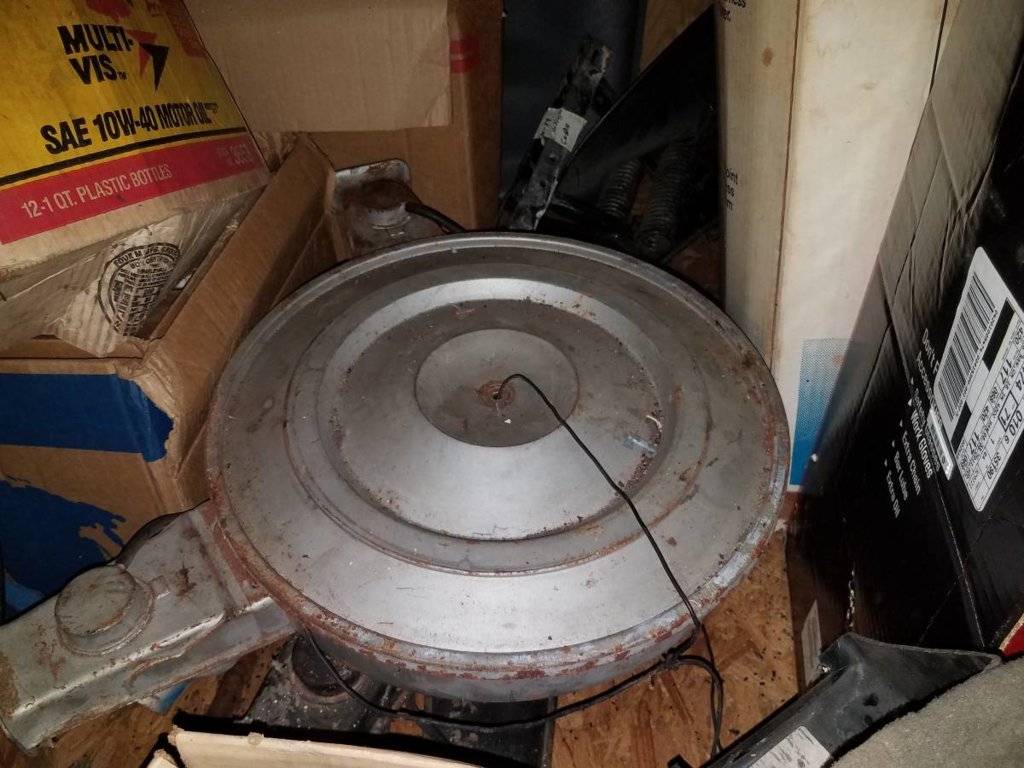

    Likely sold fast, it was only $75.
  20. PH27L7
    PH27L7 Active Member
    Messages:
    434
    Likes Received:
    328
    Joined:
    Mar 10, 2020
    Location:
    Pittsburgh, PA
    Believe Plymouth 273's only got the commando designation, no super. 273 2 barrel had no special ID other than a V8 on the fender. Survivor 66 cuda-
