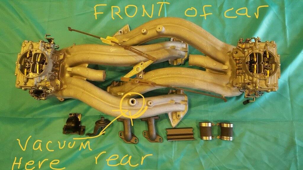

Someone has put cross ram intakes on this car at sometime .
If i decide to hook the heater back up where would be a good port for vacuum on the intake ?
There is a hole for a vacuum fitting it the rear of the rams. Do you have power brakes? Where are they connected?
413
Yes i do have power brakes and they are connected where the circle is at the rear of your photo .
I will run a tee or something in that port .
