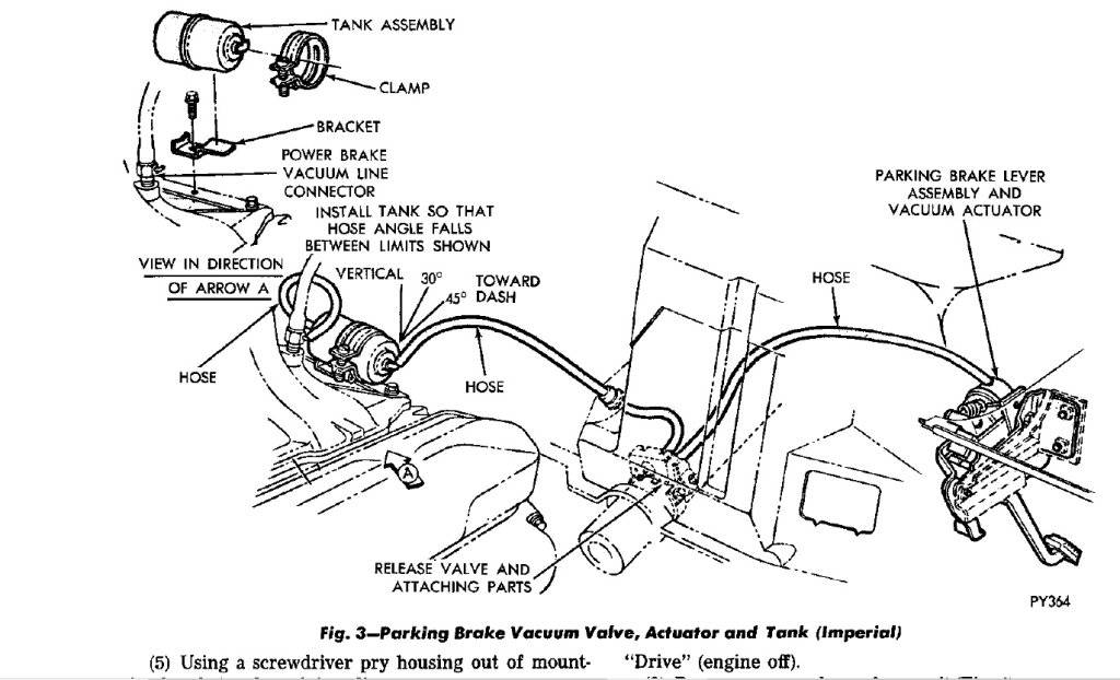

I just completed the rebuild of the suspension/brakes/steering/exhaust on a 73 Imperial. When I put the steering column back I found a vacuum line coming through the fire wall near the steering column. I seached around and it fit a fitting on the base of my steering column. (or so I think, as it was behind the column and I could not see it) I know a lot about these cars, but the vacuum system is something that do not know much about.
What was this for?
An emergency brake release which released the emergency brake when the gear shift was moved out of "P"?
I don't have a '73 FSM, so this is from my '70 FSM. Probably not a lot of change in 1973.
Thanks, I had a suspicision that was associated. I actually did not put the shift lever into park to release the park brake together with the vacuum canister on the park brake. Thank you so much! I acually need to go look to see if the hose is connected parking brake actuator.
