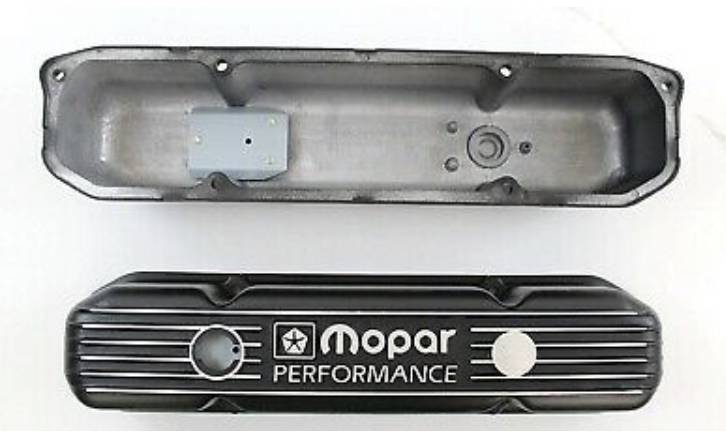

Thanks for the quick reply. I am always a bit embarrassed that I do not know more details about my own car... but I always appreciate the education. These are the covers I have on my 440 (pic from the Internet). Is that the baffle on the underside?
The pcv valve should have a baffle under it, too.
