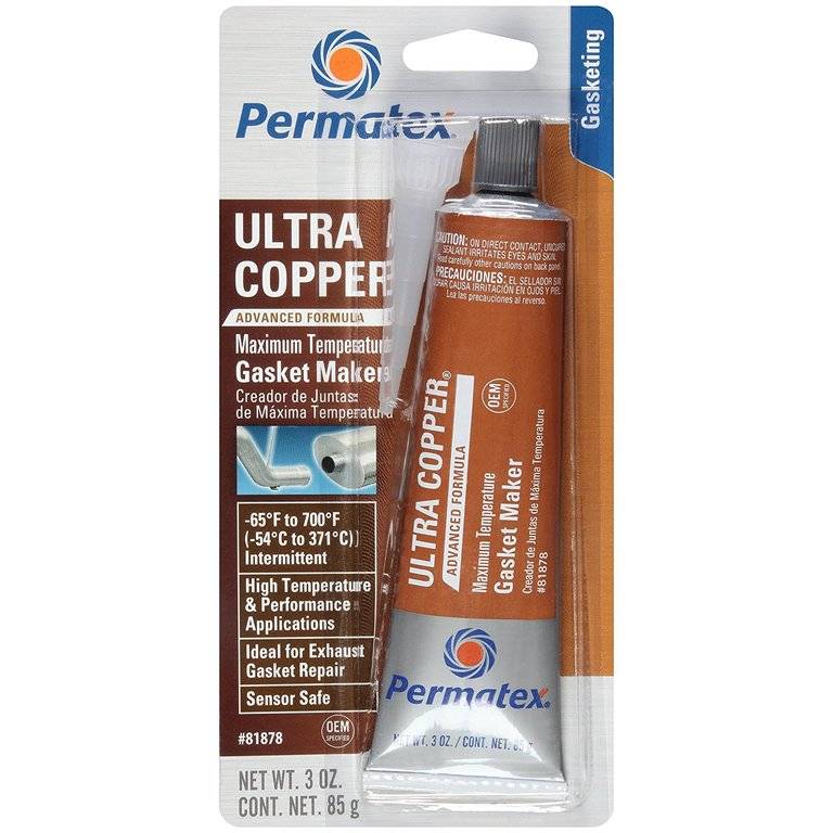

I use the ultra series but I also glue them to my valve cover with 3M trim adhesive then RTV on gasket to head surface.
Love this stuff. I don't use it as a gasket replacement. I use it as pookie added to a gasket. Hard to find in stores so I get it on, where else of course, Amazon.
