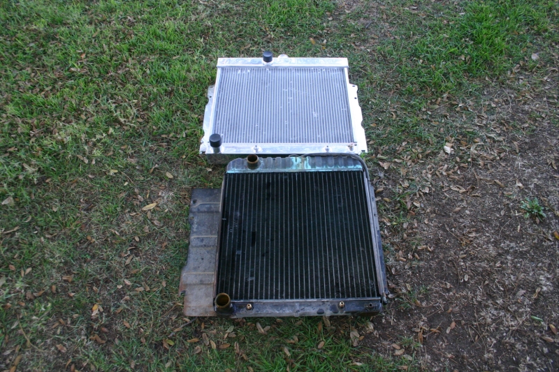

3) Radiator has a crack along top chamber and took it to a vintage radiator repair place and it has failed 2 times since I got it back... tried to get new radiator from Rock Auto and when it arrived it was too big. Guy at Rock auto said that the vendor mis represented the radiator as a fit for a 68 Fury with 318 and that he does not have proper one to fit -- anyone know where I could get a new radiator that properly fits the 68 fury with 318 and has ports for AT

I agree Mike. It's a great looking car. I can't say for sure but somebody might make a kit for replacing all the lines for your top? What size is your radiator?
This is a Champion (EC1635) that I used in my 318 Polara, I know not for eveybody but it does the job.

I have a '68 B-body 26" 318, auto with a.c. Radiator that appears to be in decent condition that I'd sell cheap. I'm sure it would need to be boiled and checked for leaks.
thanks for the email -- I have to remeasure but recall it being close to 20" wide...mine was supposedly in good shape, but the top seam keeps leaking -- it was recored. may go with the new one that MrMoparCHP shows here as the one in the picture next to it looks like mine.

What happens with the top of the radiator tanks is that over the years all that heating and cooling causes the copper/brass to turn brittle. Once it does that it is very difficult to get them to seal and work properly.
If your not worried about 100% original appearance...then go with the Champion radiator....you won't be disappointed. Just paint it flat black and very few people will even notice it. ;)
Alan
I am having no luck finding anyone who has the champion ec1635 in stock... Any suggestions?

First off, copper and brass do not go brittle with time - I know, I've been a plumber since 1974.
Get in touch with someone who really knows how to solder and remove the upper tank. Have the
mating surfaces cleaned well and tinned. Remount the tank and solder properly. All you really
need is 50/50 solder but don't use that new "green" crap with more tin than lead.
