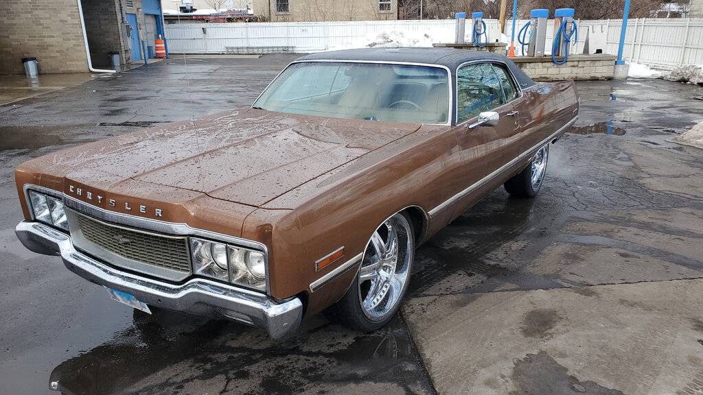

Hello everyone,
Over this winter I am thinking about a project to do on my 73 Newport Custom. Its has a 400BB with a 4B Holley. It has the 3 speed 727 TF.
My thoughts were around the rear end. Currently its the factory 8.25 rear diff at 2.71 GR.
A few people have said that I should change that out for something with a higher gear ratio. What should I look at getting? Should I just go around to a salvage yard and find one?
