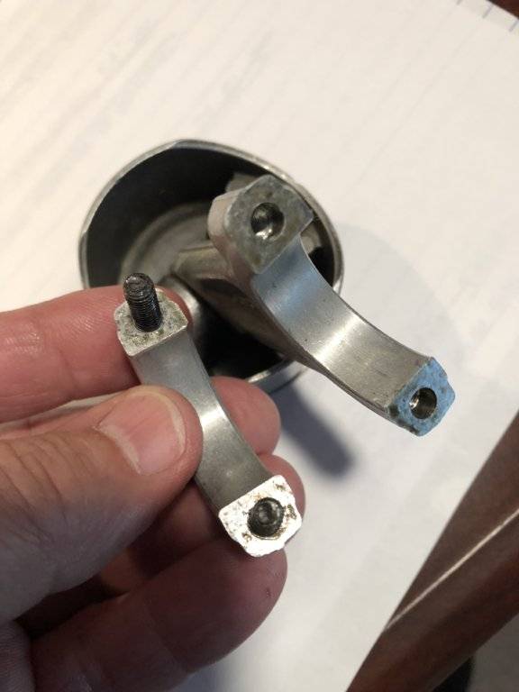

    Thanks much for your detailed info. You mention "rod bearings" vis-a-vis the RV2 compressor, but the Original Air Teardown video shows that there aren't any. Have you see them with rod bearings? Or do they have them at the top attaching to the piston.

    There are no separate, replaceable rod bearing inserts (as is in an engine). What the OP meant was the rod/crank bearing surface (aluminum rod on steel crank) would seize due to no oil pressure.

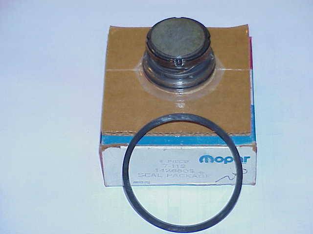

    When I got my 4 Seasons compressor last year, I had read this thread and others about poor quality rebuilds and opened my sump. Sure enough, no ball and spring, and old crud in the bottom of the pan. I sourced the ball/spring, added my 10 oz of R12 oil after letting the PAG oil drain out for a few days, and carefully torqued the sump back on.
    So it all worked for a while, until I noticed the front gas seal was leaking after a few hours of runtime (I put an oz of fluorescent refrig dye in with the oil, glows like crazy under ultraviolet) . So now I'm getting ready to replace that seal, too.
    Needless to say, I'm not a big fan of these crap reman units, but I don't know what else to do except buy NOS for $750. At least the 4Seas clutch seems to be working quite well.

    As you probably know, the later compressors deleted the ball/spring. If yours is still working that's probably the case.
    As for my NOS seal kit that I changed yesterday, it too was a victim of shelf sitting even tho (as you can see) it was a sealed kit. The highly polished steel seat that the carbon seal rotates against was totally corroded by moisture wicking thru the cardboard over the decades. I had to use the seal the reman people put in there and hope for the best, as I couldn't find an aftermarket seal kit locally yesterday, and had to button the car up. So, we'll see how this repair goes.
    I removed the EPR from my existing compressor.
