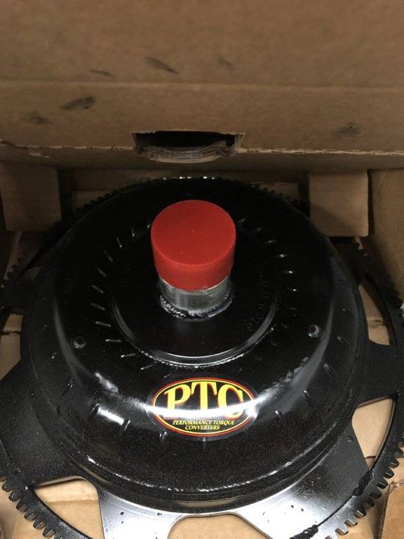

That looks like a transmission in that crate:), it must go with the new converter.
What stall is the converter?
It is designed to flash at 5200 RPM. It's an 8" with a steel stator to handle the transbrake. The engine starts to breathe really well up around there, it should be a decent match. This car is likely to be rather interesting to drive - 1/4 mile at a time.

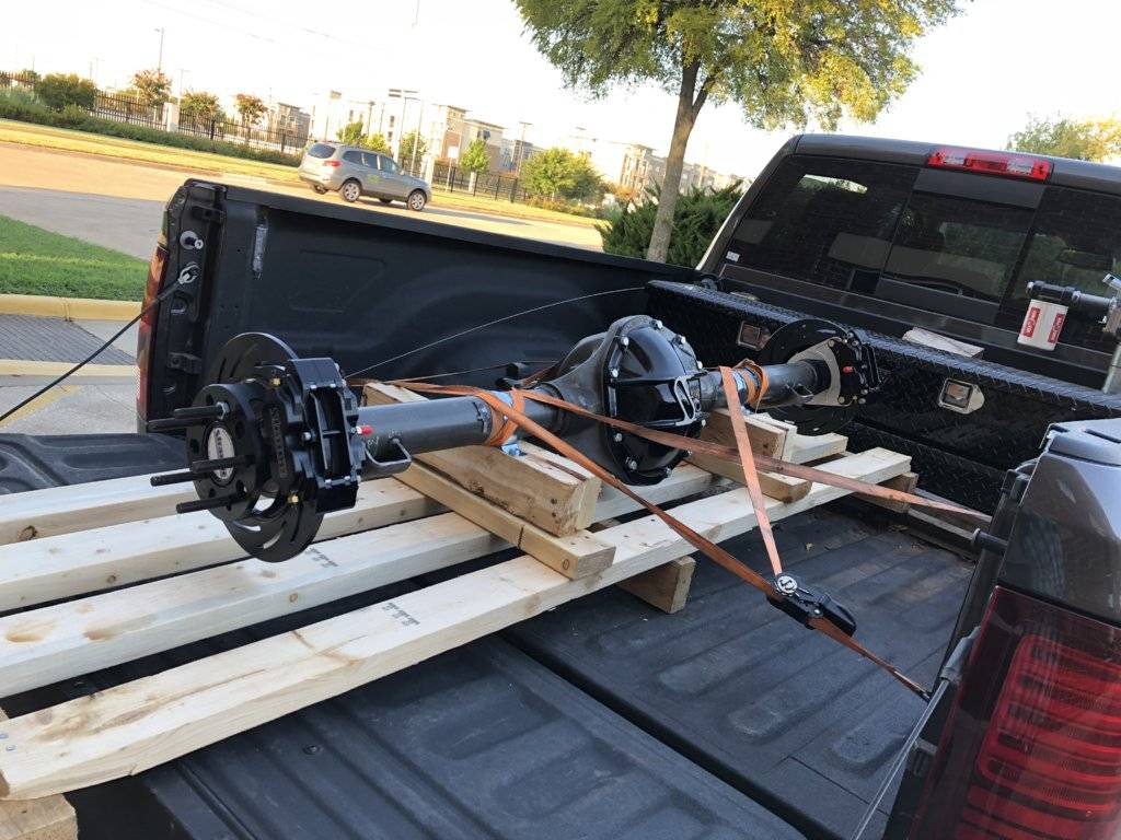

4.30/1 rear, with a spool. A locker is considerably dangerous at these power levels. The torque converter will probably be ~4500, and built to handle the shock of a transbrake.
It’s been running a 4.10/1 differential with a 3500 RPM stall converter and this intake and cam setup just doesn’t love the starting line. Then again, neither did the u-joint studs!Two of them sheared clean off, that's why the long pause in posts. The "489" center section requires a new crush sleeve to replace the yoke. That started to snowball, and, we decided that the time was nigh to go with a Dana (Strange) 60 setup.
I’m also going to start bumping the timing once it gets a few miles. The ignition is quite intelligent and will let me make decisions about timing based upon time, RPM, gear, etc. This, too, should help with takeoff.

John Cope had PTC take a look at our build and they’ve suggested an 8”, 5200 RPM flash stall converter (with a steel stator to handle the transbrake).
I had thought about using a ~4500 stall converter. They feel that the higher stall is necessary. I’m down with utilizing their experience, so, we’re going with the suggestion.

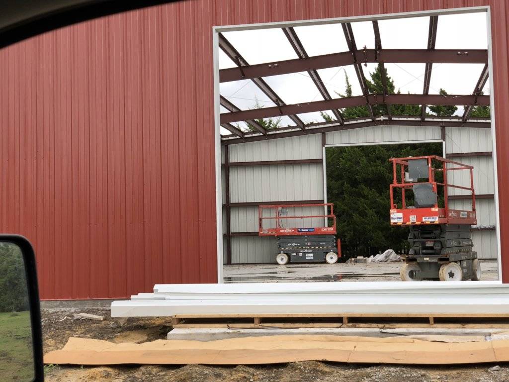

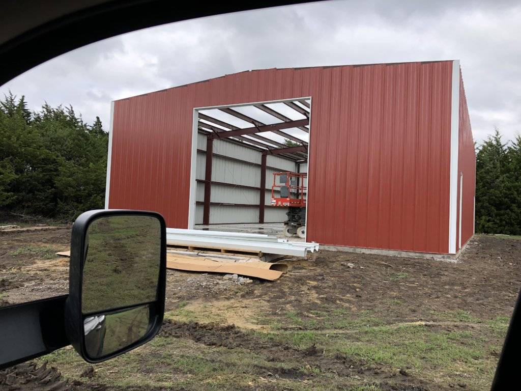

On the way, our big automotive shop is now four walls.
It’s going to be 40’x60’ with a 30’x60’ awning.
