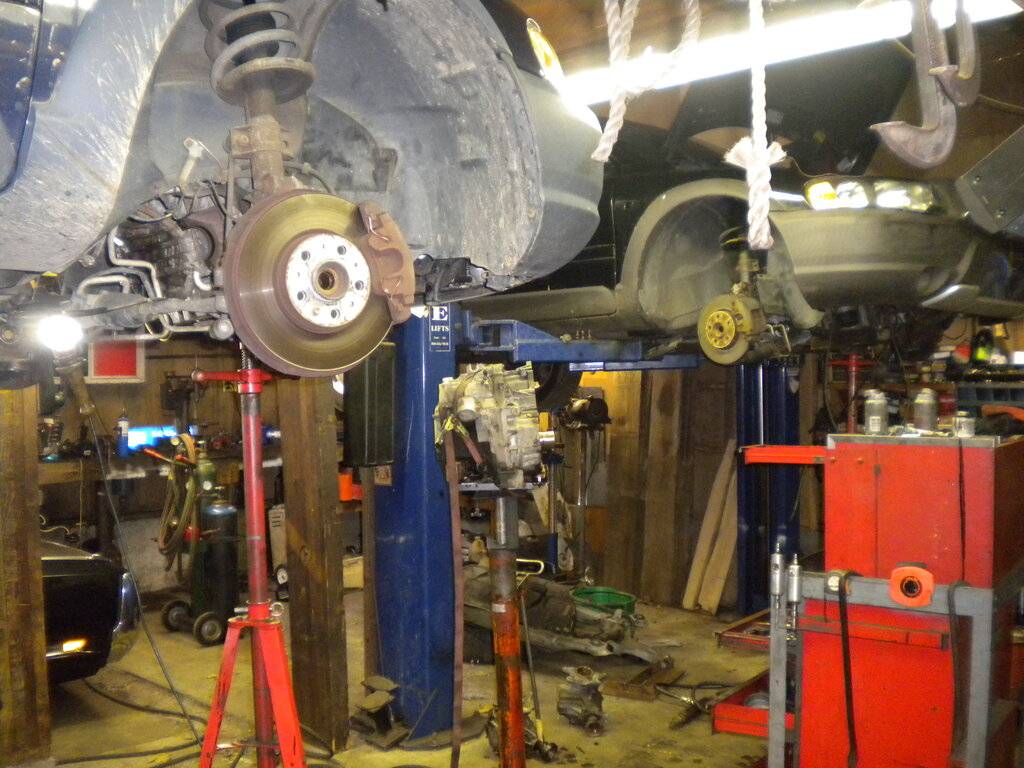

xc70 transmission swap from parts car.
day 2.

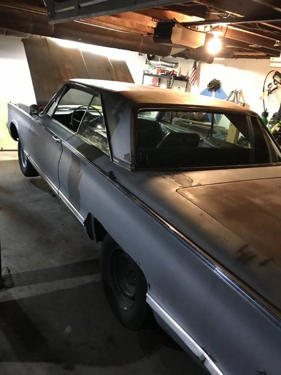

Try to get a 413 running that’s been sitting for a long time
You DO KNOW not to let the engine use any of the crappy gas that is still in the tank, don't you? And you DO KNOW to pull the valve covers and generously lube all the intake valve stems with PB Blaster, before you attempt to start the engine, don't you? And you should pull the plugs and squirt some ATF into the cylinders and let the whole thing sit for a day or two. Welcome to FCBO, and Good luck!

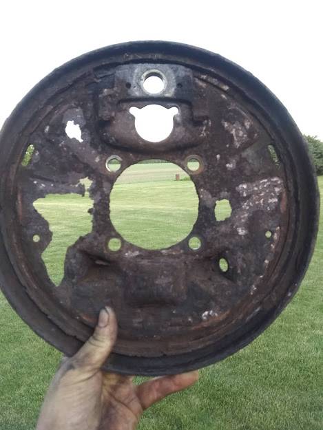

Changed this out on a friends Tahoe yesterday
Can't say I have ever seen one rot like this.

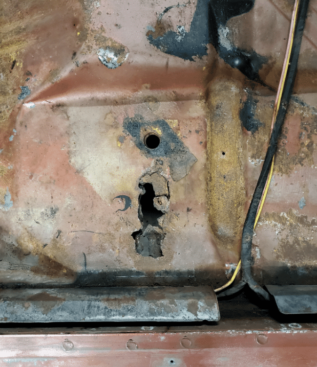

Finally got the front seats back from the upholsterer for the 300 convertible so we set about removing the NYer seats we had temporarily installed in it (so we could still drive it) and also the carpeting. Upon removing the carpet we found ... RUST. No big surprise there, I knew there was some. So I've started working on the repairs. I'm still an amateur when it comes to cutting, shaping, and welding, but my skills are starting to improve and I'm actually enjoying the work to a certain extent, or I guess I should say I'm enjoying the satisfaction of being able to do this...
Rusty hole in passenger side where the floor is spot welded to the reinforcing crossmember. (driver side is about the same condition)

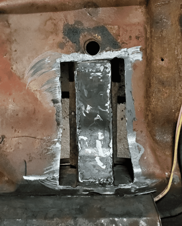

I actually did a pretty decent job of cutting out the rust
Got the patch in the reinforcing member
