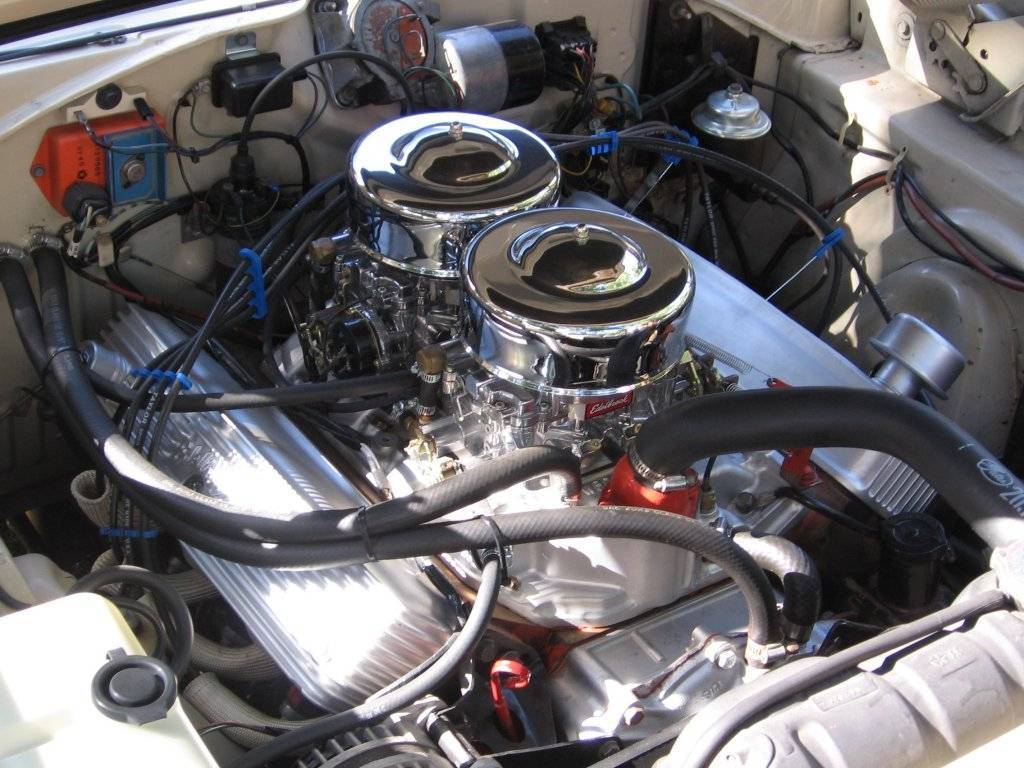

Go this route:
Car was real sweet!
That's very nice but way beyond my time or budget allow, and if I'm honest about it the car doesn't warrant it.

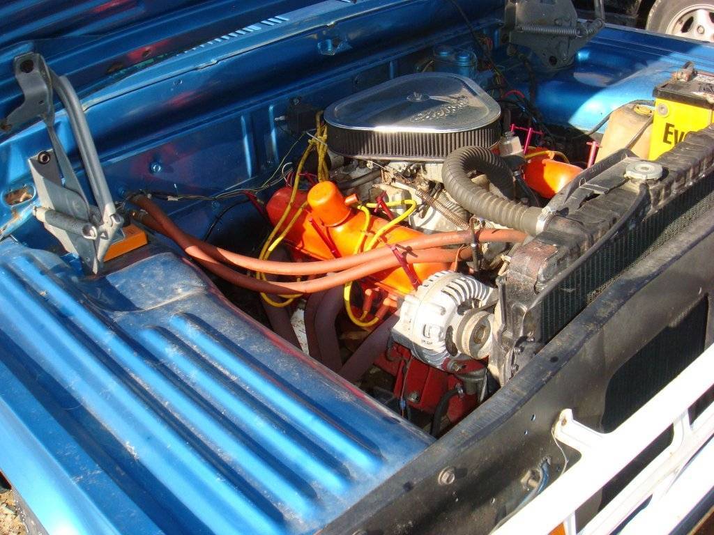

Well, I must confess to some insider knowledge, my last D100 Sweptline pickup, '68 vintage, had a 318LA with Edelbrock performer, 600 Holley, Hedman headers & twin exhausts with cherry bombs. It wasn't a racecar but it didn't hang about either. Oh and it made a glorious racket.
Brakes & steering left something to be desired though.
