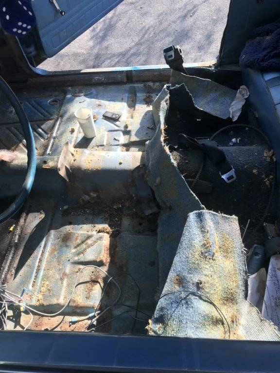

The carpet is dark. Looks like they spilled oil on it-over and over. Previous owner(s) didn’t take care of the car.

Glass under the seat. Looks like one of the rear windows was broken sometime.

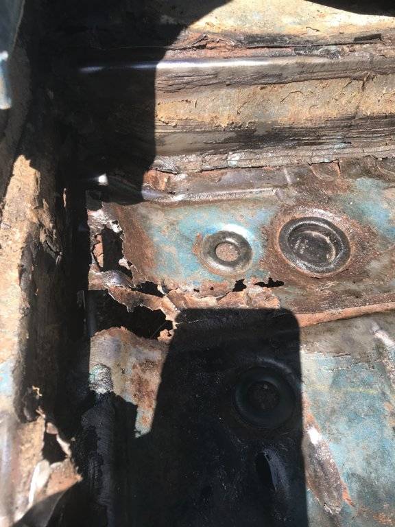

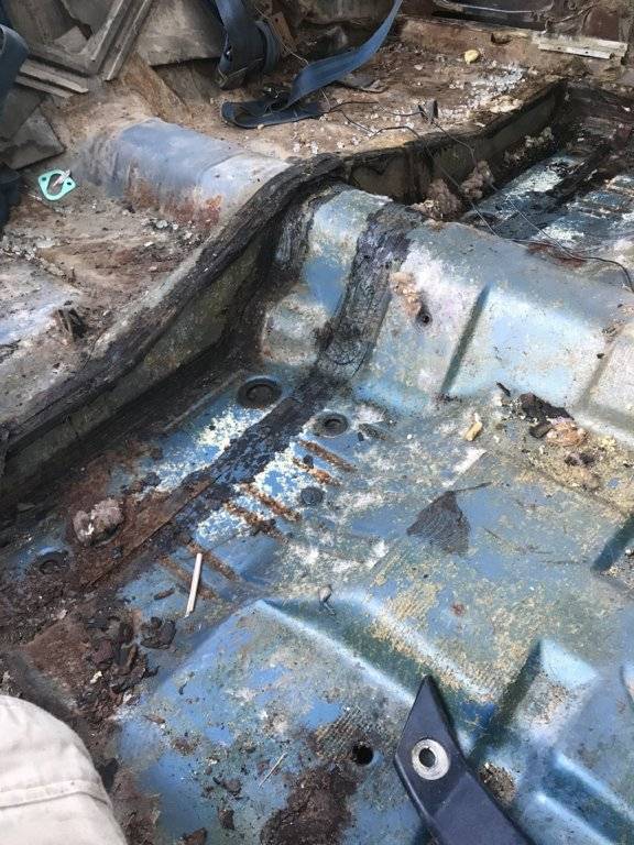

That’s the plan. No holes like driver floor pan. I think I can clean it up ok.
Just a thought.. because I’ve considered it as well, once you’ve primed and painted it, use some roll on bedliner material to protect it from any further water/moisture damage. They sell kits at Home Creepo or the local auto parts store. Just my 2 cents..

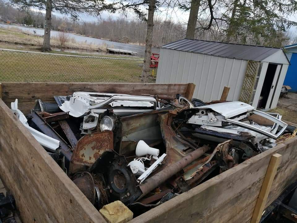

Started staking my car hauler with scrap lumber I had, so I can haul my scrap...I have more lumber at home, but misjudged how much I was going to need.. I may still need to make two Trips anyway
Trying to get things all cleaned up..
Started stripping the M body shell for my sheet metal needs... Friend in FL wants what I don't need.

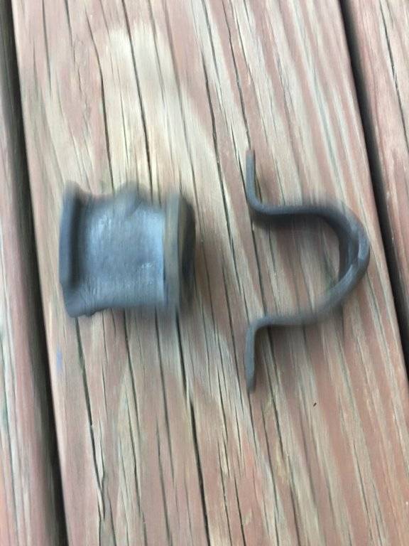

SO! I got under my 77 today and swapped out the sway bar and links.

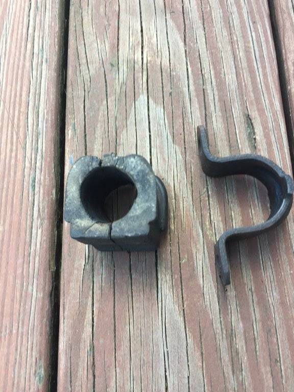

I also purchased sway bar bushings from my local parts store, and of course they’re not the right type. Does anybody know where I can score a set of new ones?
I wonder if a set from another style of vehicle would work, I saw a set for a jeep wrangler that might work. Any ideas? Thx

You can use generic universal bushings and straps, just know the OD of your swap bar and the width/spacing of the bolt holes.
My parts guy ordered aftermarket ones, 7/8 diameter Bar.. I pick them up tomorrow.. all the OE replacements he had in his book were all the wrong style and size.. I’ll post pics and details once I have them.. thx for the info.
