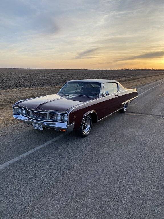

Had to go get puppy food. Took the long way.
View attachment 448013 View attachment 448014
What is the green glow under the drivers side. An alien hiding?
I have been trying to figure that out myself. It is not in the previous picture. I was shooting right into the sun with my I phone, not sure if it is a refection from my camera lenses or my sunglasses. I went back in the garage after I saw the picture and turned the parking lights back on, but didn't have any light leaks.
Not sure???

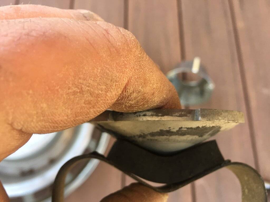

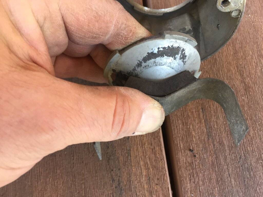

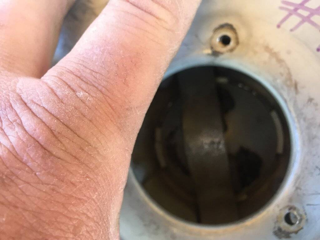

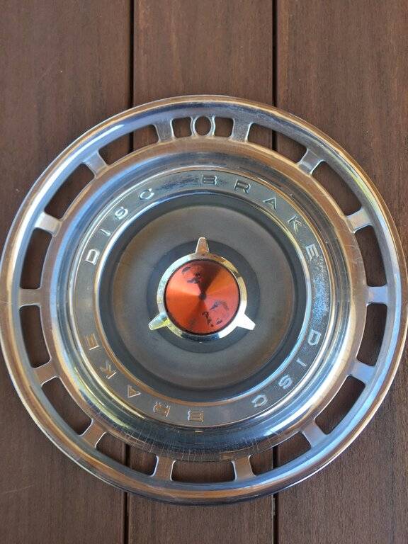

I couldn’t stand the low speed clicking noise coming from the plastic center inserts of my hubcaps. After taking the center caps apart, I installed some dense foam rubber that I had saved from some packing material. They were absolutely perfect for keeping the center caps firmly in place. No more clicking and I think they may last for a good long time… Fingers crossed.

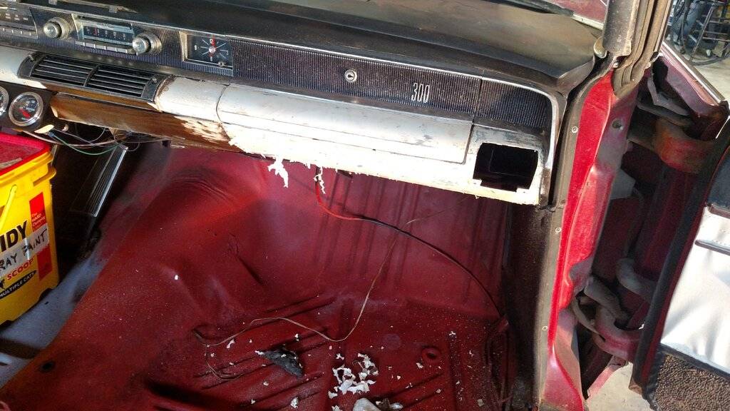

I tackled a couple of projects this past weekend. I worked on removing stick-on wood grain applique some douche nozzle stuck to the dash of my '66 300 convertible. Was hoping it would just peel off, but no-bueno. I'll hafta repaint the entire dash.

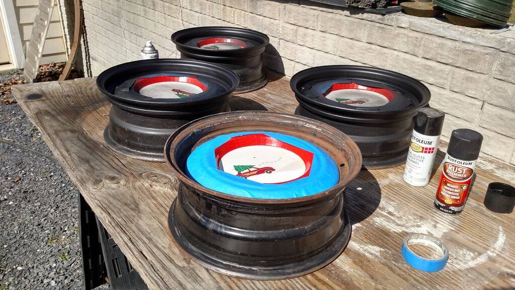

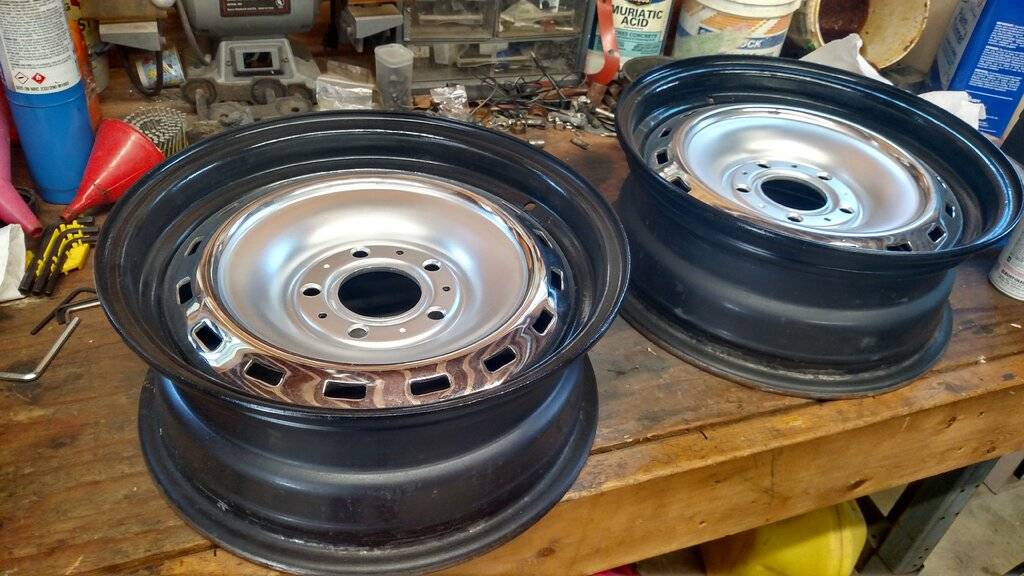

I also finished up re-furbbing a set of Road Wheels I picked up from @sixpkrt. Thanks again, Tim.
I really need a set of trim rings for these wheels. I doubt if anyone here has a decent set of originals, so I'm open to suggestions as to aftermarket rings.
Won't a heat gun take that crap off?
That is what I thought in the beginning. That crap has been stuck to the dash for a very long time. I tried everything from a heat gun to Goo Gone to a sticker easer disk on my drill. In the end, I had to use a window-scraper razor blade tool to make any headway. Of course, this procedure has introduced scratches in the metal. Now, I'm gonna hafta sand down the dash skim it with filler, prime it and finally paint it.
