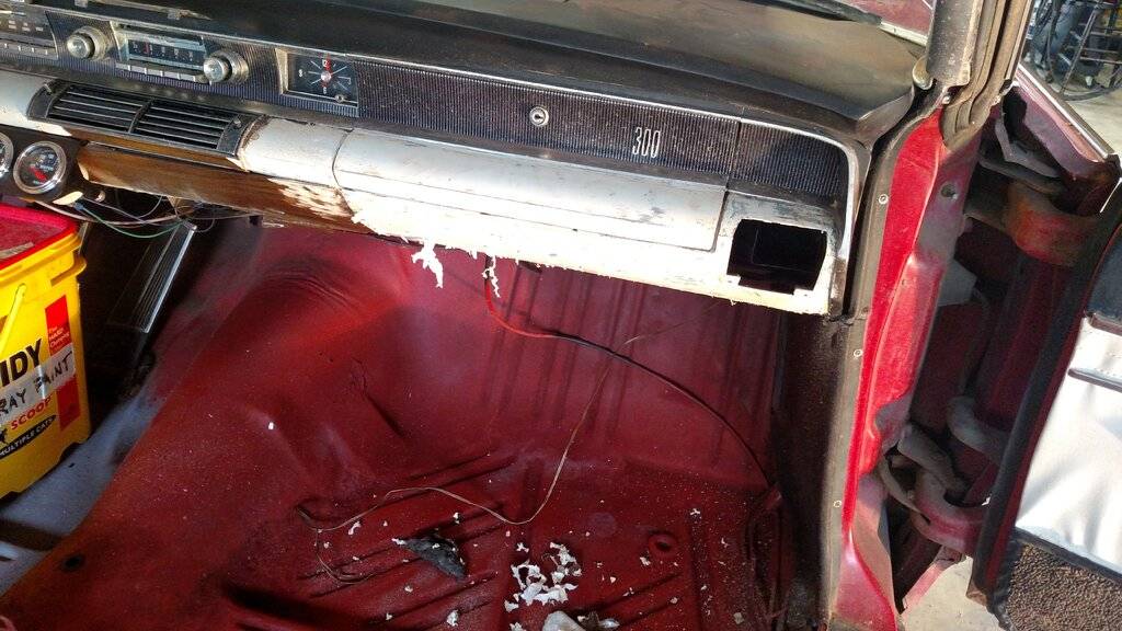

I tackled a couple of projects this past weekend. I worked on removing stick-on wood grain applique some douche nozzle stuck to the dash of my '66 300 convertible. Was hoping it would just peel off, but no-bueno. I'll hafta repaint the entire dash.

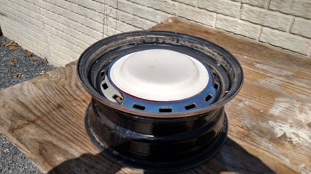

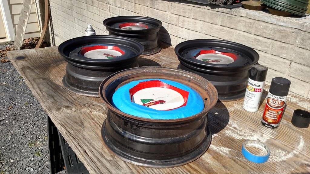

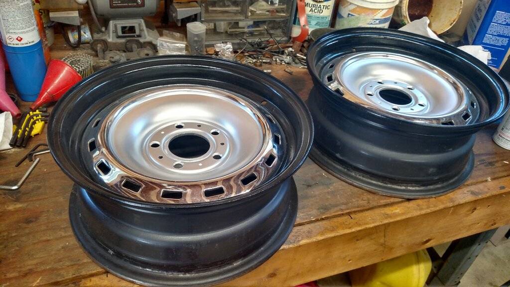

I also finished up re-furbbing a set of Road Wheels I picked up from @sixpkrt. Thanks again, Tim.
I really need a set of trim rings for these wheels. I doubt if anyone here has a decent set of originals, so I'm open to suggestions as to aftermarket rings.
Murray had a real good set that bought from him last year.. give him a shout.

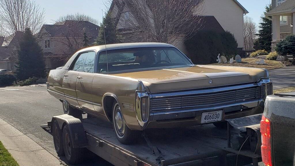

And. . . The flippers will often hose down the car even before they roll it off their trailer - having just stolen it from some deceased poor soul's estate.

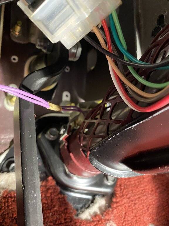

Cleaned and adjusted my backup light switch. It didn’t want to make contact all the time. First Jumped the connector to make sure the lights were working. Nice and bright. Then put the ohmmeter on the switch. You could see it flicker but couldn’t quit get to stop where it had continuity. Took it off sprayed the hell out of it with carb cleaner than contact cleaner. Was able to get some continuity. Re-installed it and re-adjusted. Works good now.

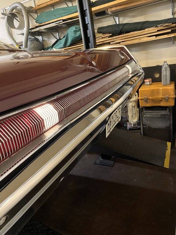

Just received McGoldy back from the Mankato shop in time for nice Easter weekend. Miscellaneous engine work and an exterior buff done by them. I have some interior work to do next couple days and waiting for a donor rear spring/hinged license plate holder coming from Murray P. any day.
